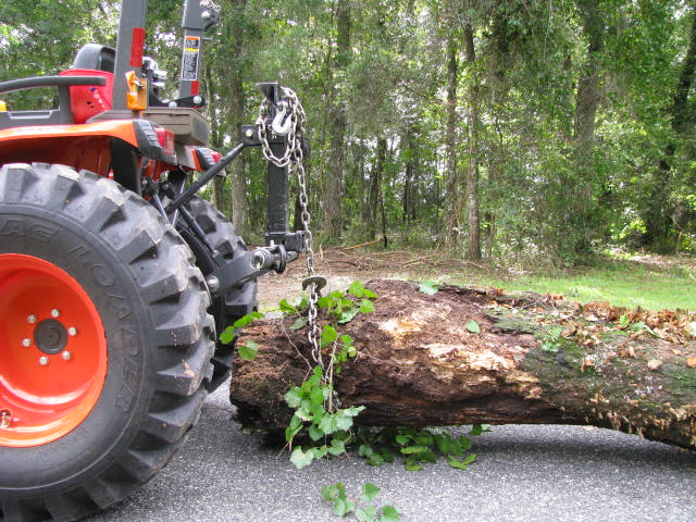

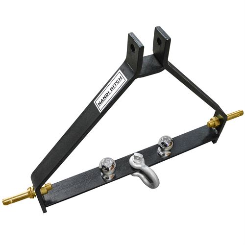

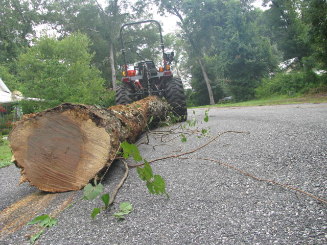

You can tow log sections with a BX and 1/4" Grade 70 chain. Saw trunks into reasonable weight sections. Tractors are designed to PULL.
Cross-drawbar PHOTO.
MORE: https://www.tractorbynet.com/forums/owning-operating/404017-tractor-three-point-hitch-cross-2.html ((Cursor down to Post #14.))
