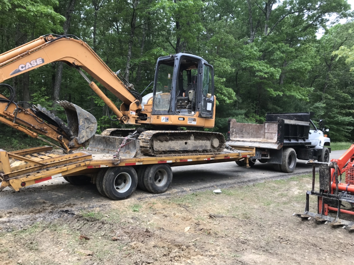

About 8 years ago I bought a 2002 F350 CC dually w/ about 109K miles for about the same price. Now it's at about 190K. Since then I've put about 1K/ year into maintenance most done by others.
Replaced brakes, some brake lines, shocks, some of the front suspension, had transmission rebuilt.
It's life with me had mainly been one or two trips a year hauling a 12K equipment trailer until 2018 then a 10K enclosed trailer back and forth to Mississippi
from NE Virginia, with a full load in the bed.

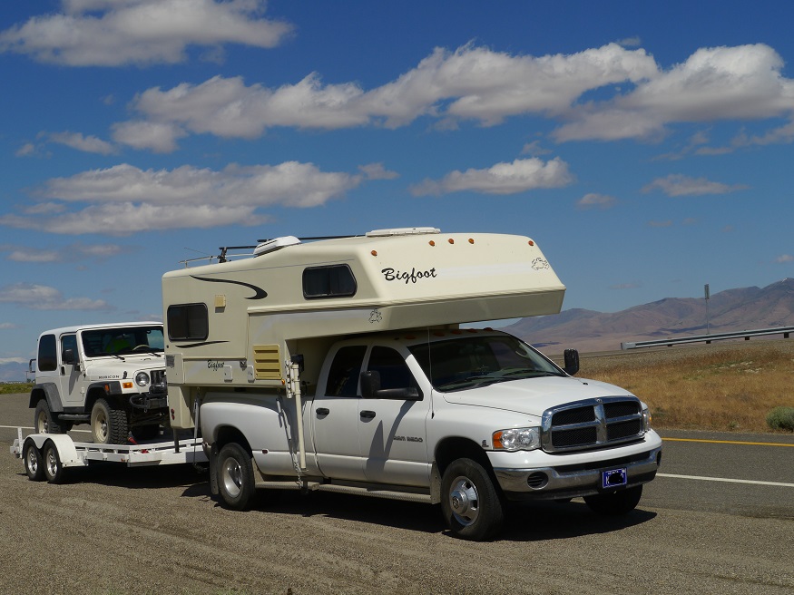

I owned a 2004 2500 Dodge with a Cummins, 4x4, quad cab, short bed. I bought it with a 100,000 miles and put 50,000 miles on it. It was a good truck but they have come a long was with newer trucks. The wind noise in mine was terrible, poor door seals. Also another common problem, a nasty vibration. At about 65 miles the truck came alive, you could really see a high speed vibration in the mirrors. I also was fighting rust in mine. It seemed to always get 15 mpg, empty, towing a 7000 lb trailer, in town, on the highway, 15 mpg. My opinion, get a newer truck, they are much nicer. If your scared of the diesel, get a gasser.
