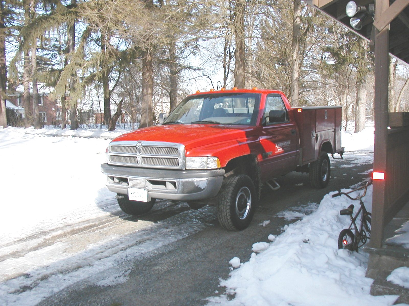

Mostly from those who don't own a new one. I had a 95 Ram 2500 with 12 valve Cummins, a little under powered at 160 HP, but only 1 day down in 12 years of service.
Needed a new truck in 06 and started at the Ford dealer, I still think they look great, anyway did a little research and started hearing all the negative propaganda about Ford diesels at the time. Luckily I heard that Dodge offered for the first time in X number of years the class 3, 3500 chassis/cab I was looking for.
In 2007 was all new 6.7 Cummins and a Japanese transmission, I was concerned about being a guinea pig but figured it was my best bet. The chassis cab motor is detuned down to 305 HP and has a different emissions system than the pick ups. Sure I wish the milage was better, but it's the same as my 2500 with half the HP. This truck drives like a dream, so no regrets yet.
IMO the 5.9 Cummins was/is the greatest truck engine in it's class of all time.
Hope the 6.7 can live up to it.
Pics of the old and the new.
JB.
