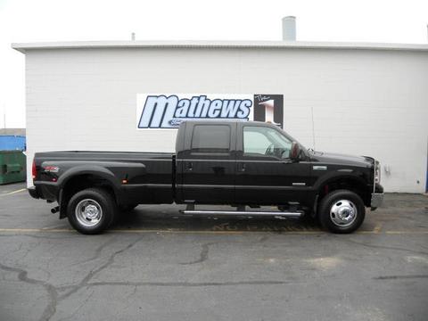

I'm looking at a 2007 F350 Lariat DRW 4x4 with 82,523 miles. It was a one owner truck. I have requested a "Oasis" report from the dealer (Ford dealer) and am looking forward to seeing it Monday when I go back there. They are ASKING $25,900 for the Ford.
I do need a truck of this caliber as I have always had diesels and basically use a truck like truck. I had a 2003 F350 7.3L PSD and traded it in with 230K miles. I currently have a 2005 Silverado 2500HD extened cad 4x4 with 93K miles.
I like the Silverado but I really miss my old F350 plus I need a crew cab now that my family is expanding (baby due anytime!). I beggining to have a rash of electrical issues but that is a whole other situation. The main thing is the need for a crew cab for pulling a 40' 5th wheel camper (12-13K pounds, give or take) with 2 dogs, wife, 7 year old, and soon a baby girl! I do pull also a 24' gooseneck hauling my various pieces of equipment around (10K pounds or so).
The bottom line is I want to know the relability history of the 2007 6.0. I know that the early models had thier share of problems. Any experiences?
*Disclaimer* This by no means will turn into you should buy this or that please! I do not want a Dodge period. I miss my Ford.

If you want a Ford that bad then I would look for the 6.4l Powerstroke (Jan. 2007 to 2010 model year) and bypass the headache of the 6.0l all together. The price does sound good though.
It's still far from the greatness of a Cummins or Duramax but your chances of catastrophic failure are much less with the newer 6.4l vs. the 6.0l. If that truck had more miles then I wouldn't be as worried as they say if you haven't had head gasket problems within the first 125k miles then you probably won't. If you do get it, get the longest extended warranty you can and make sure it covers head gaskets...
/ 2007 6.0 Powerstroke reliability. #3
If it has not been chipped, and has had the correct maintenance, it should be a reliable engine. Correct maintenance for the 6.0 includes 6-7K mile oil/filter changes, as it uses the engine oil to activate the injectors, which causes oil shearing. The coolant needs to be changed regularly to avoid junking up the oil cooler which causes the EGR cooler to fail. Thats a very common problem, and doesn't need to happen. A good aftermarket coolant filter can extend the life of the coolant. Fuel filter changes (both of them) prevent low fuel pressure which destroys injectors, so they need changing.
If there is ANY evidence that the truck has ever been chipped, run away from it. You don't want to be buying head gaskets, injectors, or pistons, on this engine.
It should still be under Ford's 5yr 100K mile engine warranty, so thats a help. YMMV, but generally, the 2005-up 6.0's are OK if they are maintained. Check the maintenance records if they are available.

I think most of the issues were with the earliest engines 03-05. There might be some problematic 6.0's out there but I think many many more trouble free ones.
I bought my 06 KR dually 6.0 in 06 with 3,000 miles on it, it now has 60,000 with no issues. I typically haul a 30' gooseneck (7K empty) a 30' enclosed (6K empty) and they're never empty, a slide in camper (4K) and smaller trailers as well.
I amsoiled the whole truck, have a platinum edge chip, and K& N filter. I don't beat on it with the chip, although the few times I tried the "extreme" mode it'll set you back in your seat and smoke most cars on the road. (with some smoke!) I have it in "economy" or "tow" mode 99% of the time.
One thing I haven't done yet is install some ARB head bolts. I have been doing oil changes every 10,000, but will probably switch to 5,000 with the towing I do. Keeping the air filter clean is another biggie.
Looks like a very nice truck, if the oasis report comes back good I wouldn't hesitate to buy it.
