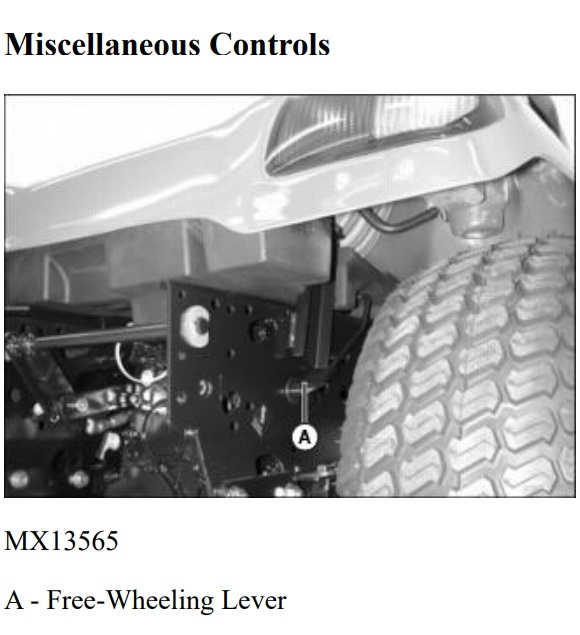

Hello All.
I have a 575X that I need to tow a short distance on my property. For the life of me, I can not find the lever to put this thing in neutral. The internet has not been much help. Can anyone help me locate this dang thing?
Thanks!
   / 2006 JD 575X - Neutral Lever #2
I believe it is on the right side behind the rear wheel. It may or may not be marked but should rotate approx 30 degrees.

Do you have the X575 manual for your tractor ??
Oldnslo is right-on where it is located.

See page 31 to move your tractor
Richard
Welcome to TBN
Here is the operators manual for your tractor
  • JD X575 Operating Manual.pdf
