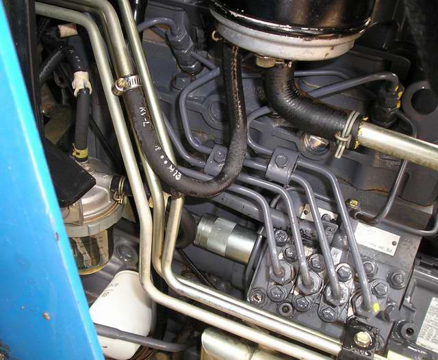

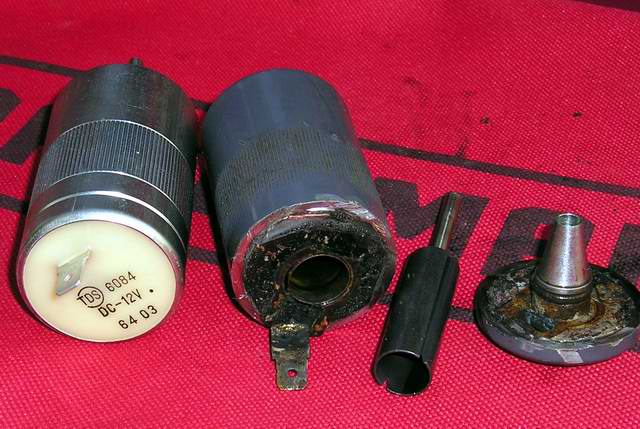

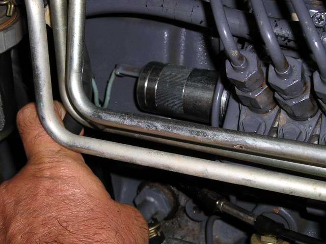

I am having the same issue. 2006 TC40A 500hrs. Not starting. I noticed that when it would start, i'd hear an audible click after I turned the key on. The times it wouldnt start, no audible click. Tested the wire going to the fuel cutoff solenoid and it has no power. fuel cutoff solenoid tests fine. Where does that 1 wire go? Which fuse controls it? Why would this problem be intermittnant a couple of days ago, now I can't get the tractor to start at all.
(Note: I removed the plastic below the steering wheel to figure out where that wire went and a rat/mouse nest was in there, it appeared to be old. I can't find any chewed wires etc.)

Lance, pull the connector off the seat switch and put a jumper across it. Then, try to start again. I'll bet you are happily surprised. Your problem sounds just like a faulty seat switch or seat switch wiring to me.
