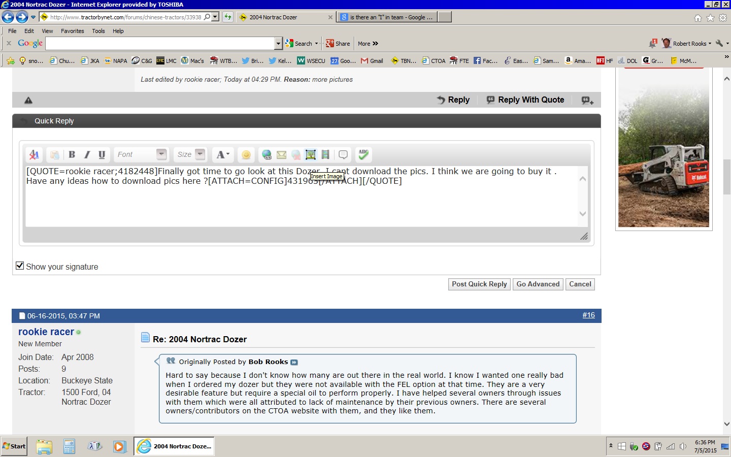

Under "go advanced" there is a manage attachment area where you can select and upload your photos. I mostly save my photos as a smaller Jpeg so they upload quickly and easily.

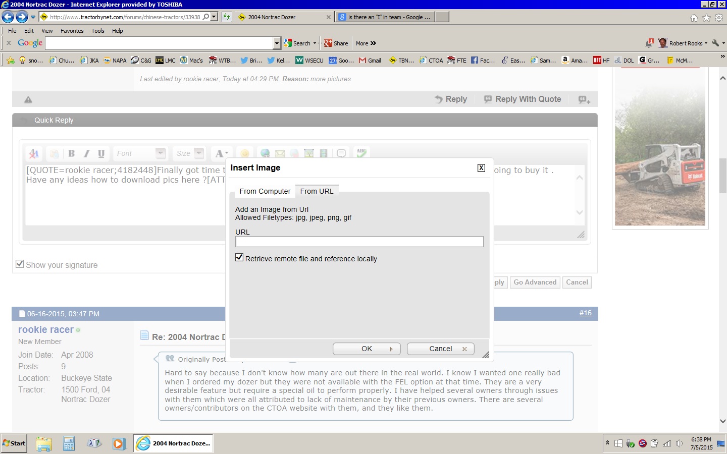

In the toolbar above the text window there is a little square with the image of a tree in it. If you hover over it, it will say Insert Image.
Click on it and this dialog box will open. Click on From Computer and then click on Browse.

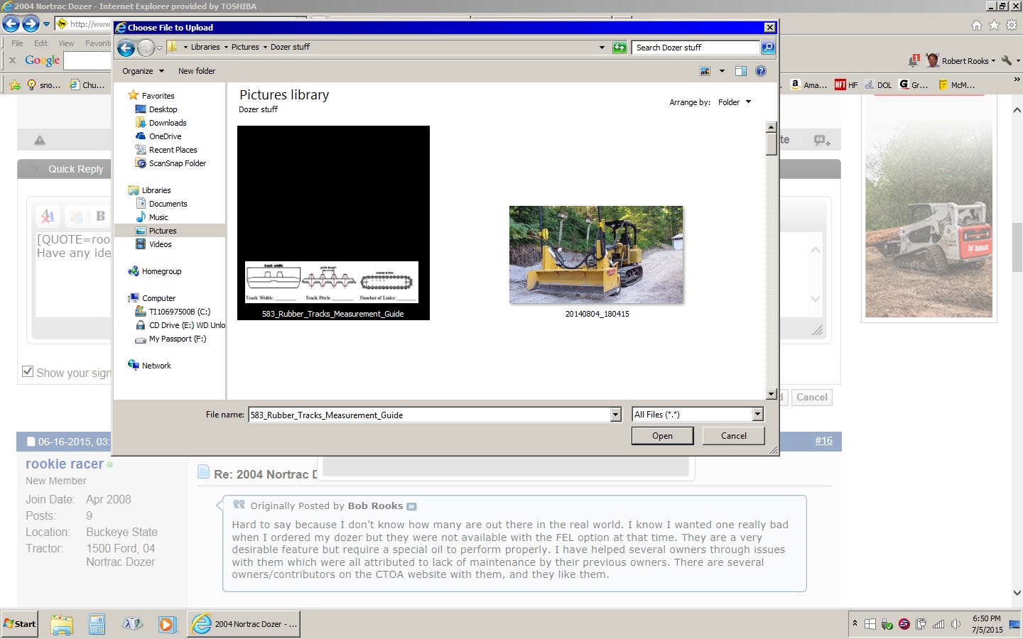

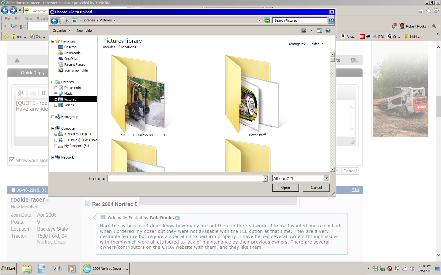

Then this window will open.
Select the picture file of your choice.

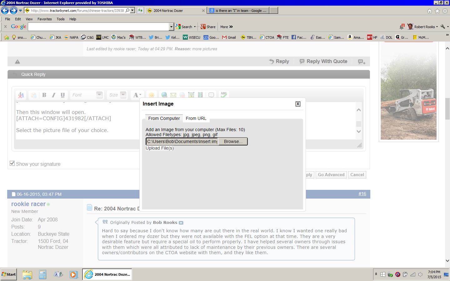

Then click on Upload File(s) and your picture will be inserted.
