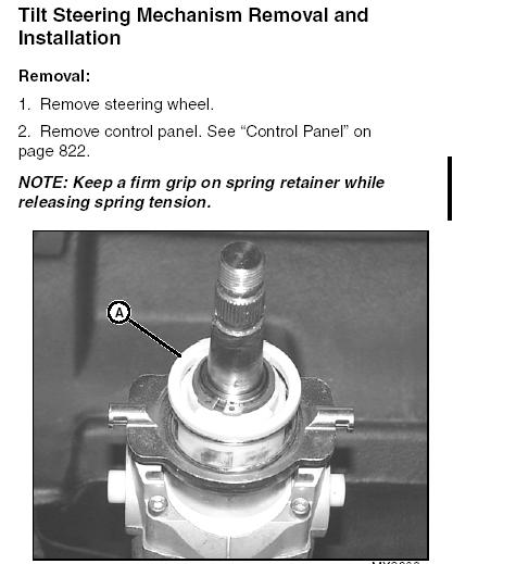

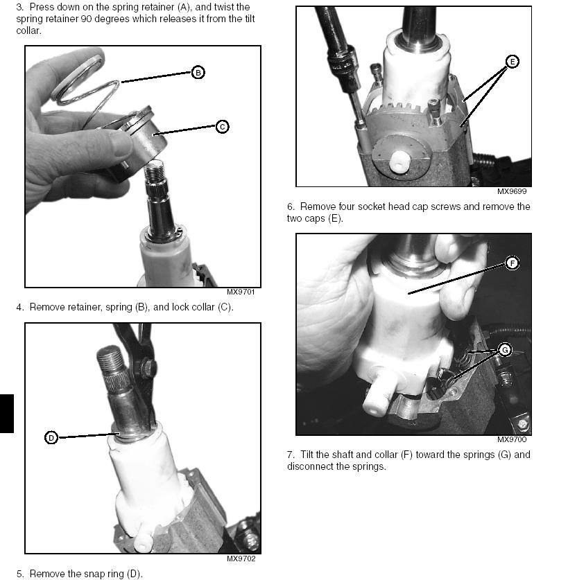

/ 2004 JD 4410 tilt steering problem #9
BTW, this might help...but be advised, this is for a 4400, not a 4410.
  • Pages from 4000 Series Tech Manual_Tilt Steering.pdf

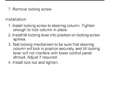

/ 2004 JD 4410 tilt steering problem #10
There were several changes, including the steering tilt lock, when the model 4x10's came out.
Here are the instructions for the 4400 (2 parts) same as Roy's link, and for the 4410 (3 parts). Quite different, as I see it.

Well just wanted to do an update...I grew a pair over night and took the **** thing apart and it was a lot easier than I thought. The culprit was the latch and the two guides, all the teeth were busted off. I wanted to give a big thanks to everyone on here for the replies and tons of feedback.
