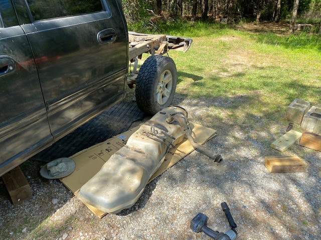

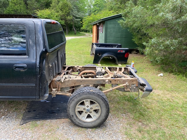

As mentioned, neither of my Fords was ever driven repeatedly with low gas and in fact the one I'm working on now I kept very near full of gas for the last 4 years since it was only used on weekends. So that isn't the issue in this case.
Having said that, since I'm not a mechanic and did not do any electrical or pressure testing there is a real chance that my problem is not the fuel pump at all and that I have misdiagnosed the problem. Which means that I might have done all of this for nothing. That's the way it goes sometimes for us shade tree mechanics.
Anyway, I'm heading back down this afternoon to put it all back together so we'll see. And regardless of the problem if I don't put it all back together right there may be new problems. ;-)

Got the pump in and the tank in and the fuel filter changed. What a goat rope. Took about three hours. The fuel filter was a real hassle. In the frame rail but up against a cross member where you can barely get your hand in there and can't see much. I just don't get it. One foot toward the rear and it would have been easy to access.
Anyway, it cranked right up and runs fine. Don't have the bed on yet. Too tired (and out of shape!). I'll drive it again and put the bed on tomorrow if everything still runs okay.
Not sure it has been worth it. When all is said and done I figure it will have taken me about 7 or 8 hours of labor and about $150 in parts. Probably could have just stayed at work and gotten some overtime and paid a mechanic to do it and broken even.
I suppose I could have done it in half the time with good help.
