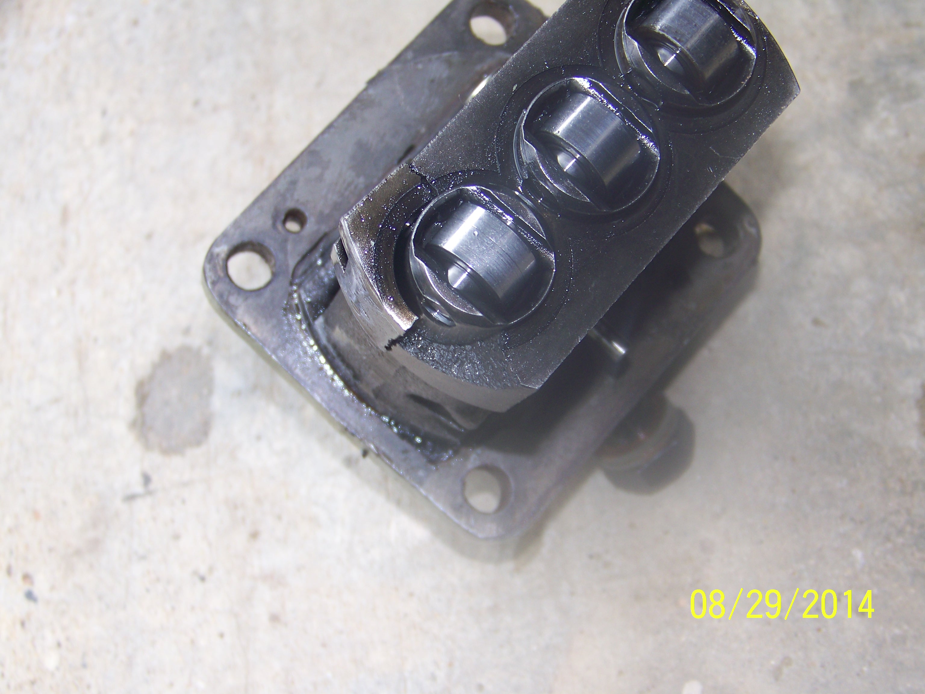

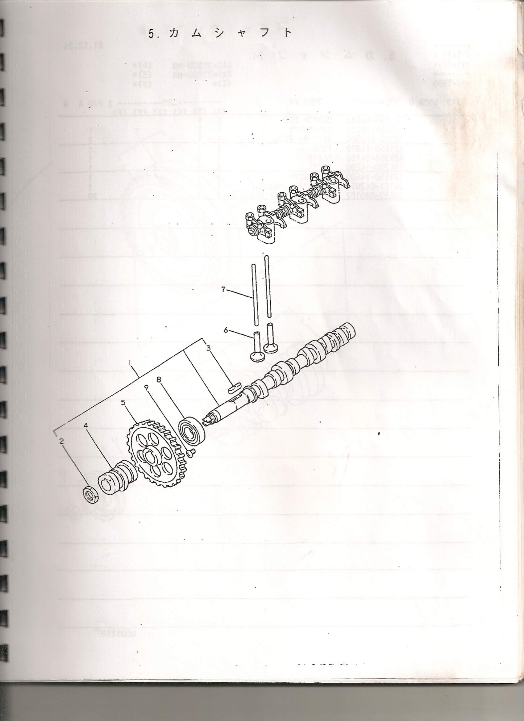

The pump cam that runs the pump on this model is inside the gear cover and separate from rods, etc. #4 on the drawing. Expecting new pump tomorrow so will be tearing into it. I will inspect as much as is possible for missing piece. Maybe try to get a clearer picture of the break on the old pump just to show how scary it looks.

... inside the gear cover and separate from rods, etc. #4 on the drawing.
I wonder how they broke that piece of cast iron.
Maybe Bud (EFC)'s stories weren't a dramatization when he said the VN 'rebuilders' buy their raw material from Japan by standing a container on end and directing the salvage yard to pour tractor fragments in. :eek:
/ 2002D fuel injection pump experiment #13
IMO. Looks as though someone just plain dropped it!! Most men in VN. aren't very tall but the cast wasn't ment to take that kind of abuse.
/ 2002D fuel injection pump experiment #14
I would agree in that thing has been broken since put on your tractor.
I think California hit it. I bet that pump was pulled off a motor with a broken rod or something that hit it...or they dropped it on the concrete shop floor (if they even have those over there) and broke it and said well lets see if it still will crank and run. I think it had been running like that a while.
I would probably have bought another too. God is not wrong in his answers he gives us, enen though it may not be what we want to hear.

Posting one final picture of the old pump that might show a little better just how bad the break is.

/ 2002D fuel injection pump experiment #16
I was just thinking the same thing, they thought it would be fine. Lucky it ran well all this time and never leaked diesel in the sump! :eek: That photo is just plain scary.

/ 2002D fuel injection pump experiment #18
Yep, it's a goner, considering those cracks, in addition to the broken piece.

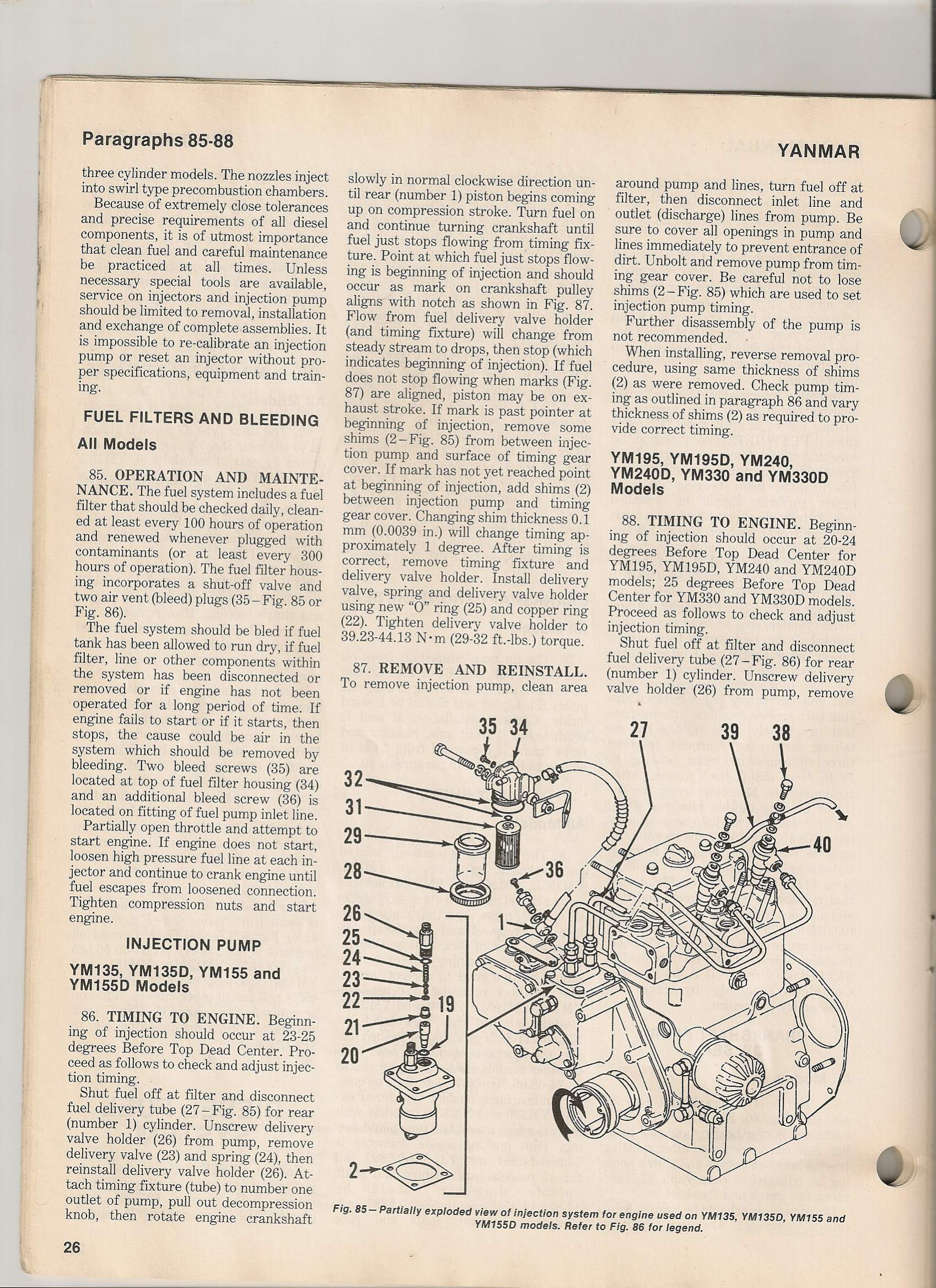

How about some opinions on the timing procedure. I have both a repair manual for a 276 and one for a 220/226. I believe these to be copies of the original Yanmar manuals. Both manuals give the same procedure which is the one I followed. That is to remove the injector line from #1 cylinder, turn until fuel just starts out. Timing mark is to be lined up at that time.
I just got to looking at an I&T repair manual for the 135,155,195,240, and 330. Procedure is same for all these models per manual. Quite different than the other Yanmar repair manuals. Wondering why two different procedures?? I will post the page and would appreciate others opinions on this. I am supposing end results should be the same?? :confused3:

/ 2002D fuel injection pump experiment #20
I looked at my I&T manual and see what you mean. I can't explain that.
