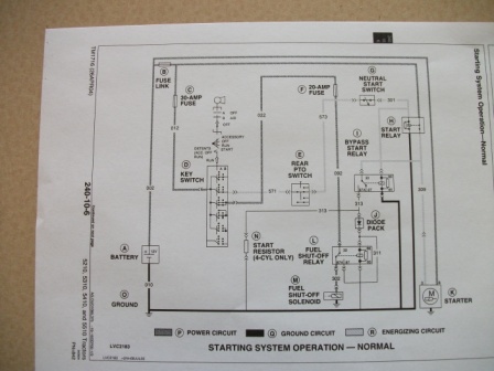

Hi new to this site. I have a 2002 5420 with key in run position I have power to the fuel shut off. Turn key to start It will crank but no power to the fuel shut off. Put direct power to fuel shut off and crank, it starts right up.any thoughts thanks

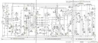

I have attached a diagram for the 5X10 starting system, which is close if not the same for the 5X20. You will see that the path to the fuel solenoid is different when the key is in the run position and when it is in the start position. Since it cranks the safety switches are ok. I would say the bypass start relay is bad or contacts need cleaning. If the bypass start relay is not working current flows of it onto the fuel shut-off relay, which cuts power to the fuel solenoid.
If needed I can provide you with a write-up on how the starting circuit works.
On my 5210 the relays are located under the left cowl. Before pulling out the relay, I suggest you disconnect the negative battery cable either at the battery or where the cable connects to the frame.

Thanks for the reply. I have 2 bypass start relays replaced both. Fuses all good. What I would like to find is a wiring diagram of the fuse panel. I'm thinking that the problem is in behind there. Forgot to mention that I have a cab so fuse panel below steering column not an easy spot

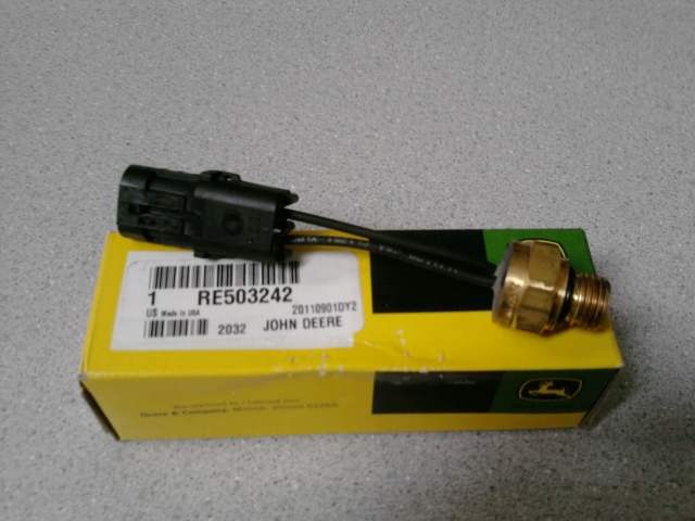

I have attached a wiring diagram for the 5x10, that is all I have. I take it replacing the relays did not solve your problem? You may also want to unplug the cold start advance from the fuel solenoid, I doubt this is the problem, but cannot hurt. I included a picture of the sensor.
