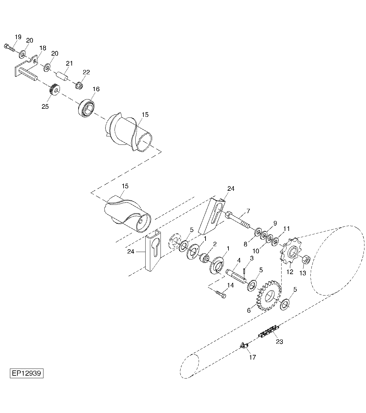

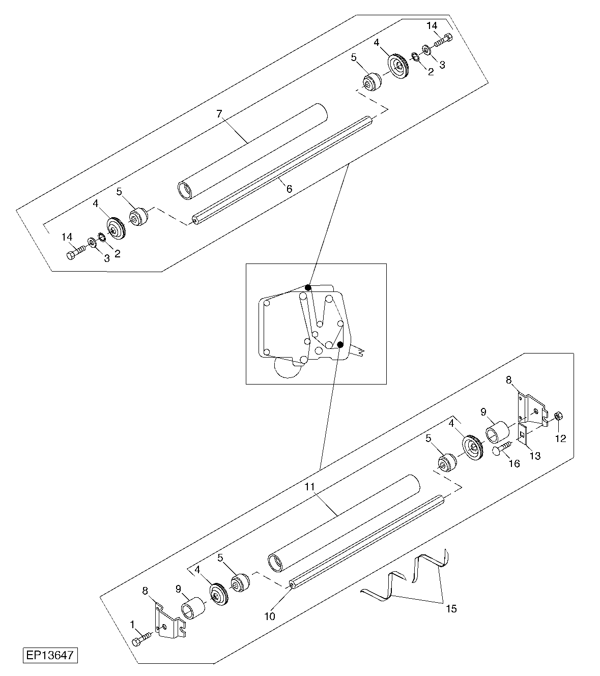

467 SS has added augers not available on 567 SS. I think the SS has these spiral strippers(2nd photo) on the belt staggering roller.
   / 2001 JD 567 - Good Deal? #19
His must be an SS then because it had the spiral on the roller.
   / 2001 JD 567 - Good Deal? #20
Ok... so, the rollers on the SS are different - at least on the 467. They have those spiral strippers that help to increase roller traction on the belts to move that high moisture (and slippery) hay through the baler and better maintain the belt tension under heavy loads.
Sound right..?
Have to take a look at the 457SS. I've been looking at those balers as maybe an upgrade to our hay operation.
Wonder if the bearings are different, too?
Thanks for the pics, Jim.
AKfish
