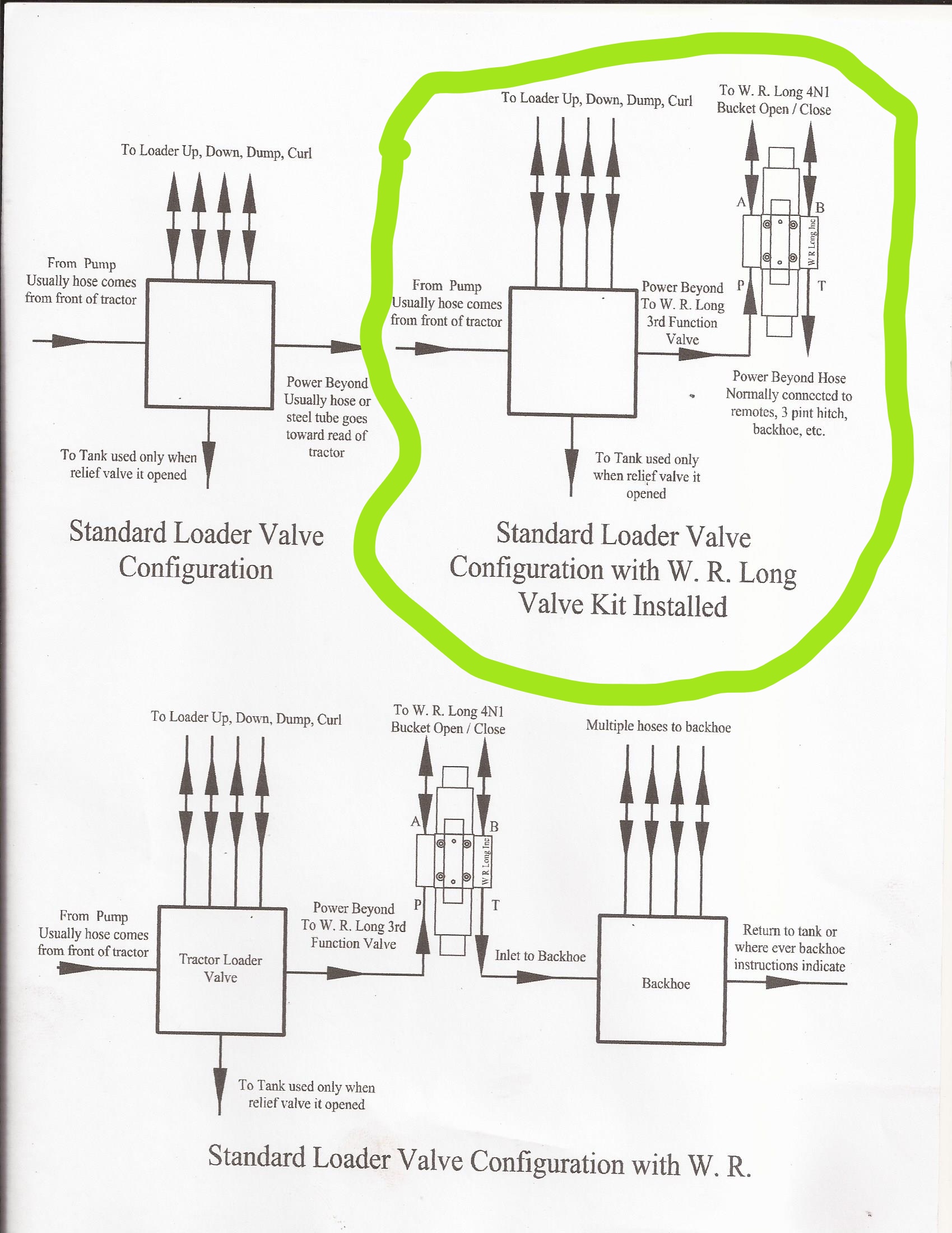

Let me see if I can better explain it. View attachment 559732View attachment 559733I have a 2001 JD 4600 tractor/ power reverser with a front end loader attached and want to make sure the power beyond hose is hooked up properly to the W.R. Long electric 3rd function valve. The hard line that was originally connected from the SCV to the rockshaft is the one I am questioning. The one that came out of the rockshaft is connected to the "T" port on the Long Valve now and the port coming from the SCV is connected to the " p" port on the Long Valve. See attached diagram.
I think they might be backwards? What do you all think???

I was hoping there was more information in the attachments. Is the first picture from the JD book? Isn't that referring to a JD power beyond block?
Let me first say I know nothing about your tractor, but I think it would be plumbed in just like the WR Long picture. Line from the loader valve power beyond to P on the WR Long valve, and then from T on the WR Long to what ever the line the loader valve power beyond was originally feeding, which I would assume is the SVC valve(s), then on to the 3-point in its original configuration.
That sounds correct, although I'm somewhat surprised the electric valve is rated for power beyond without running a line to tank.

The only thing "power beyond" about that valve is that it uses the power beyond flow from another valve. Being a symetrical valve body, it would be as strong on the T side as the P, so it can take the back pressure of a down stream valve. That's my thinking anyway.
/ 2001 JD 4600 hydraulics squealing. #12
Mopar440
What is the spool type in the WR Long valve? I.e. Does it allow flow from pressure to tank in the center position? If not this would cause your pump to go to relief pressure when no function is being used.
