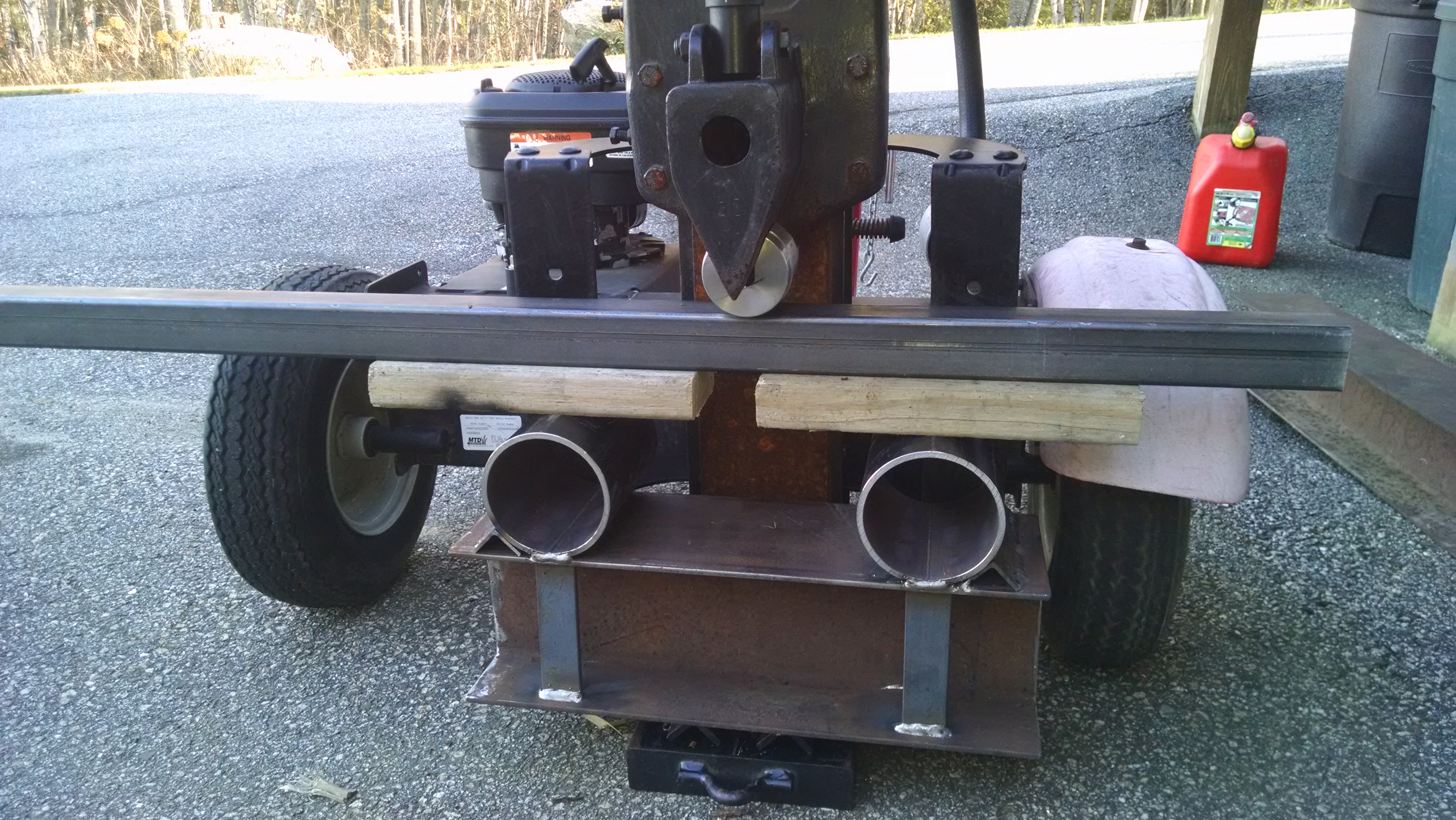

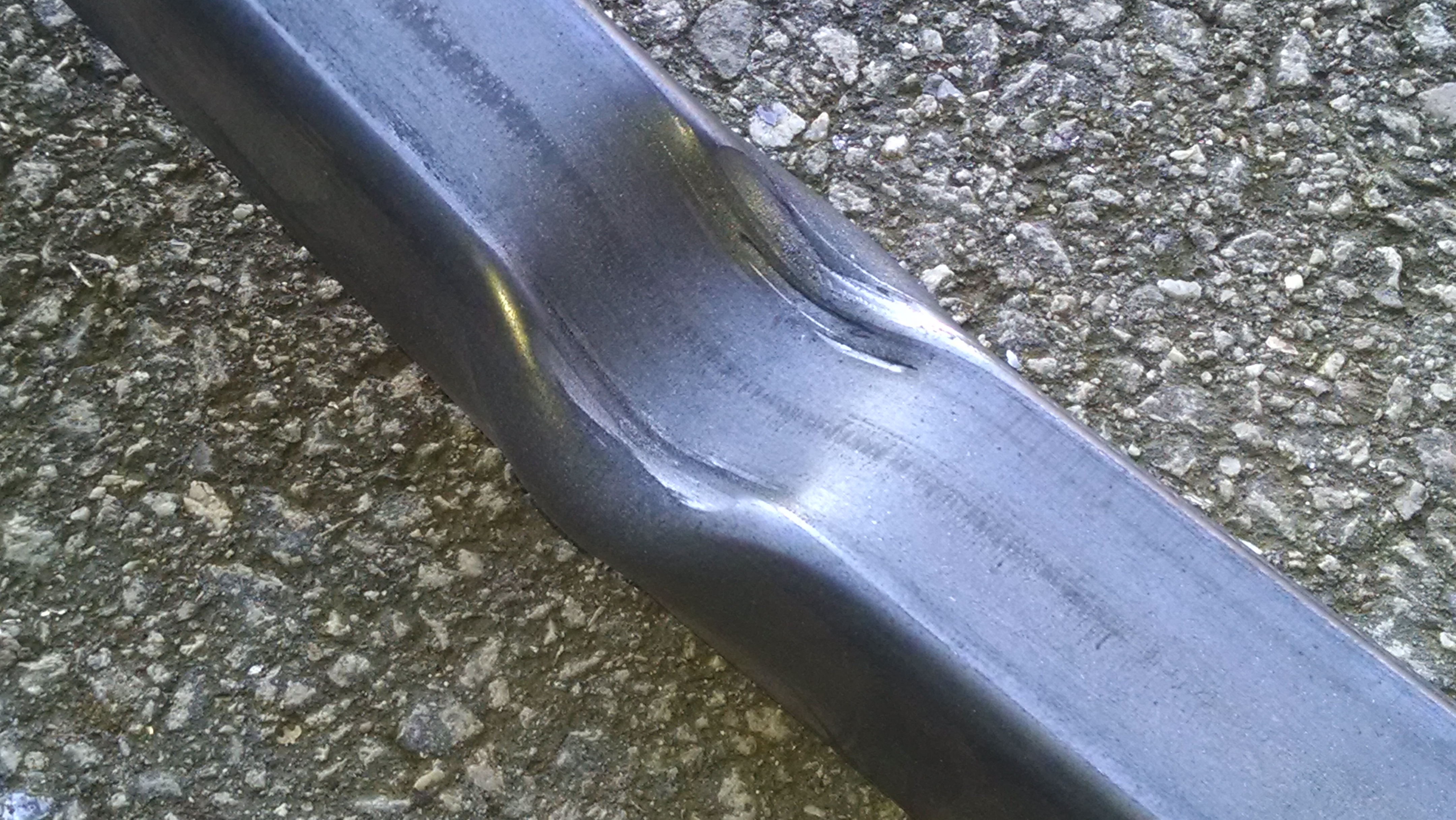

IMG_20161119_135007854.jpgIMG_20161119_142324288.jpgIMG_20161119_143034141.jpg I tried to build a 2" square tube bender using my wood splitter but I seem to be doing more crushing rather than bending. Not sure but I am thinking I need a larger radius push die with a more robust center section and maybe some side plates. if anyone has done this before and been through the growing pains with any suggestions I would greatly appreciate it. Here are a few photos to show what I am up against.

I think your on track with a bigger radius and side plates. 2" tube is asking for a lot of stretching on 3 sides. I'm not sure it can be done without one side being disformed, even my factory "ROPS" is misformed on the inner side of the radius. I wonder how much structural integrity is lost with this?
I have bent tube like this by slicing 3 sides (every 1/2" or so) with an abrasive chop saw and bending/welding then a heck of a lot of grinding.:D

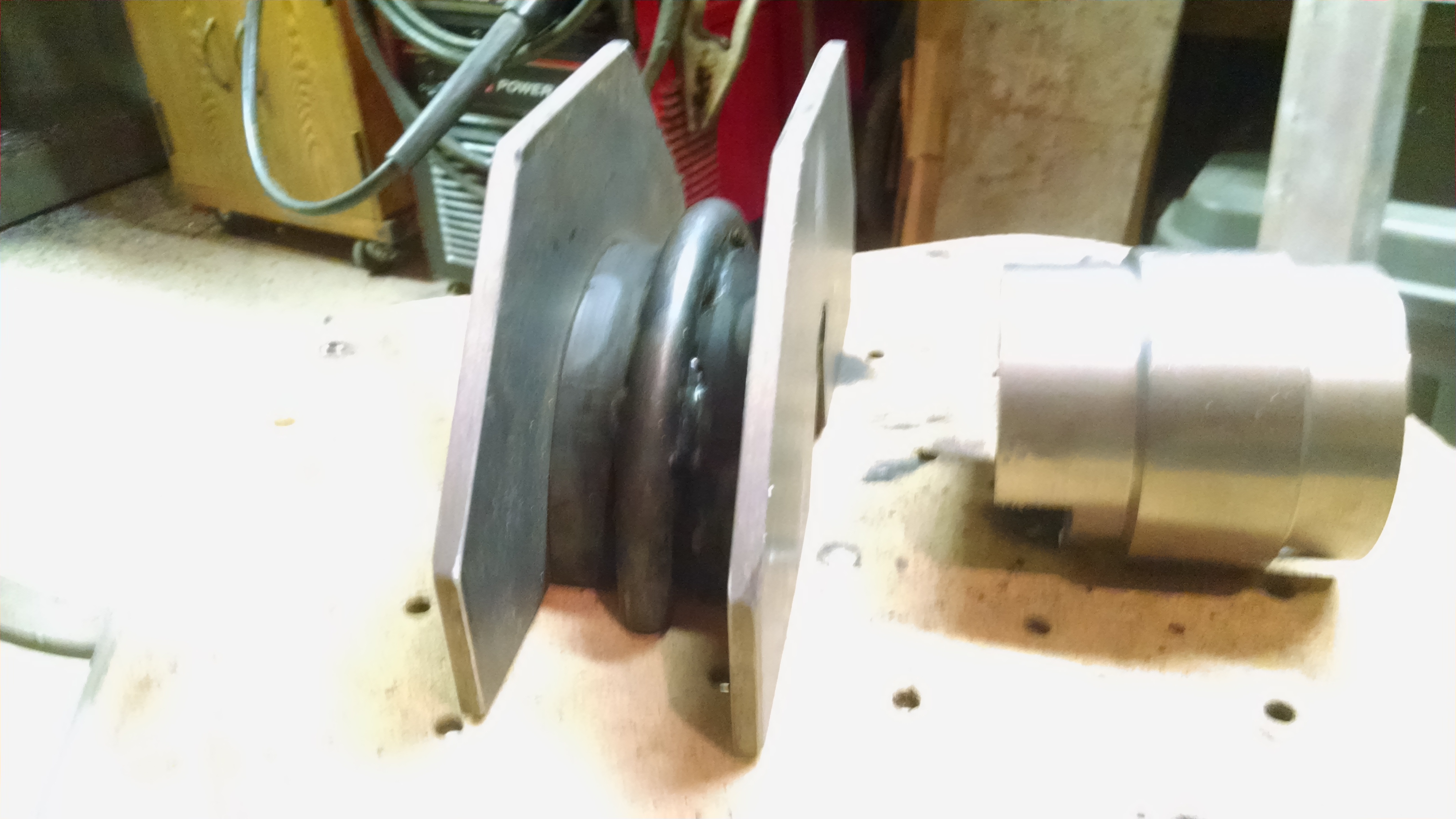

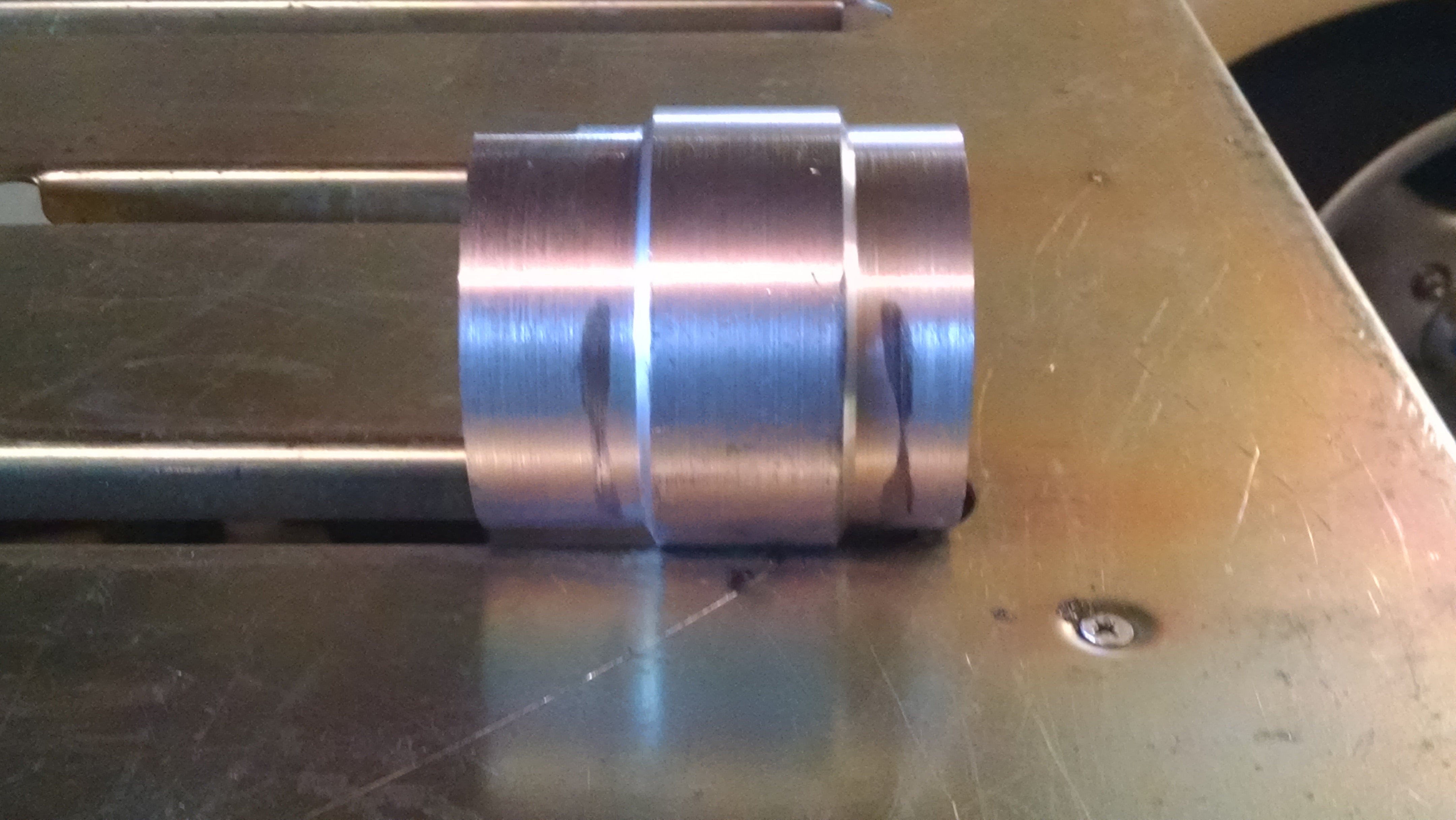

I built a die for 1 inch it worked ok but it took a lot of trial and error,
It is 6 inch with (if I remember right) about 3/8 sides and a 1/4 inch hump in the center, I turned it on my lathe , I saw on u tube some people just weld a1/4 inch rod in the center, It starts the crush that is required , so the metal has some place to go, the sides of the die, keep it from expanding. I don't think I could have gone any smaller than 6 inch , or just would have crushed the tubing,
for 2 inch a lot bigger radius would be required,and at least 1/2 inch or larger hump in the center, How thick is the tubing your trying to bend?
I was bending thin wall , I think .063 , I tried bending by hand , but ended up using a hyd cylinder.
I was bending a full 90 degrees. there are quite a few examples on u tube , even using plywood as a die, good luck and let us know how it works out.

Look at the name brand tube benders for their minimum die radius. There is a minimum radius for all tubing depending on type and thickness. Take those as an extreme minimum, I.E. go a couple sizes bigger if you can as your bender design is less than ideal.

Not a expert on tube bending but i have seen several deals like this where they fill the tube with sand to help prevent the crushing.

Thanks for the info the video shows me where I need to make improvements I will make a new push die this week and let you all know if I get better results.

Most square tube benders are designed to fold the excess material of the inner flange into the tube and bend only the radial flanges, while supporting the flanges on both sides to prevent them folding outward.
The only other option is like they do when bending trumpets and other brass instruments: Fill with mud, freeze solid, then bend.
