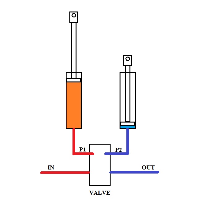

I want to build a hay accumulator out of an old trailer frame and I need to be able to work 2 tables with 1 remote (2 ports 1 handle. Handle up activates 1 port handle down activates the other port). My thought is to have a ramp with an elevator chain, probably a #55 floor chain, that is ground driven some how. The bales will "climb" the ramp and when 2 reach the top end to end I will activate 1 single acting cylinder to "flip" the bales onto the main table. When the handle is released the small table will return "home". When the main table is full I want to use another single acting cylinder to dump the bales and when I let go of the handle the main table returns "home". Think something similar to a very small bale wagon. Make since? I may need a spring or something to help the tables return quick enough but that's yet to be seen. Thoughts?

BUT: I'd still suggest some type of selector/diverter, so he can have independent control of the two cylinders, otherwise every time one cylinder is actuated-the other will retract.
/ 2 single acting cylinders 1 remote #7
After re-reading the OP, a single valve won't work for what he wants though. Sounds like he wants the cylinders activated independently from one another with a single valve. No can do. :confused3:

On your existing valve you have two work ports that I will call "A & "B". When you move the lever up pressure goes to "A" & "B" is connected to tank. When you move the lever down Pressure goes to "B" & "A" is connected to tank which is how a double acting cylinder works.
Like others have stated you either ned more valving or got mechanical.
/ 2 single acting cylinders 1 remote #10
Let me explain my thinking a little. On my tractor you pull the handle up to activate one port and down to activate the other. This may be what is meant by 2 remotes? I was under the impression that 2 remotes would have 4 ports.
You have just 1 Dual Acting remote.
The point is that when one cylinder is extending-look at the orange side in the drawing Ken posted above, the blue side will be open to the tank and will want to retract-and vise-versa. You cannot move just one cylinder by itself.

No sir. You are activating both work ports when you move the handle in either direction. As Kenny explains, one port is pressure the other port is return. Moving the handle the other way just reverses which port is pressure.
No sir. One valve, one remote. A "remote" has a pair of ports. When one port is supplying pressure, the other port is returning fluid to the tank.
They do. But you can't operate remote-1 (port pairs) with the remote-2 valve.
I don't understand why with this setup I would have to have the small table home before activating the large table? If the cylinders return due to gravity or Springs or whatever then I should be able to activate the large table while the small is coming down.
Cylinders don't return on their own. You have to activate the valve to allow fluid to exit the cylinder through the output port of the valve and back to the tank.
If you want the tables to act independently, you need more than one valve.
