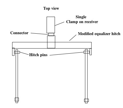

Does anyone know if there are cat 1 lift arms fabricated to fit into a 2" receiver on the market? These would be used in clamp-on receivers on my fel. Thanks
/ 2" receiver lift arms #2

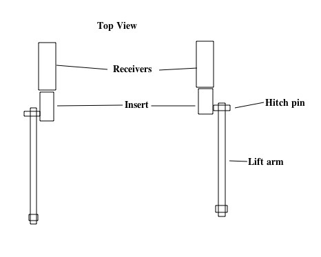

Not sure how you mean, but you could put a horizontal 3pt lift pin, instead of a ball, on a short 2in square tubing or ball mount. Then use a regular lift arm.
Bruce

Bruce, thanks for the reply. Perhaps I am misinterpreting your reply, but I want the ball socket end of the lift arms to come out of the receivers. That way, I can use the clamp-on receiver to hook up to implements via the receiver mounted lift arms.
/ 2" receiver lift arms #4
Diagram added to previous post.

Bruce, I got it now, thanks. However, seems these arms won't provide lift as they will pivot on the lift pins. Just looking for a simple 1 piece lift arm that will lock into the receiver and thus not pivot.

I guess if there is nothing on the market, I could get lift arms welded to the sides of 2" stock though I would rather have the arm centered in the receiver so as not to put sideways torque on the receiver.

Actually, I want 2 lift arms to fit into 2 clamp-on receivers (not 1 in the center) to allow me to have lightweight/low stress implements on both the front and back of the tractor at the same time. Note, I have the top link attachment resolved.
