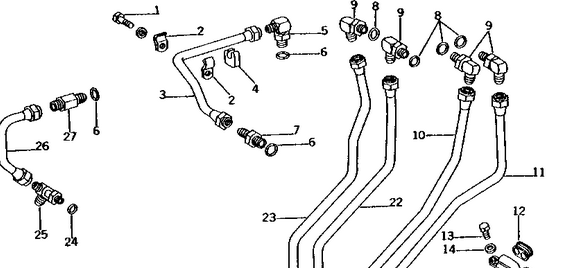

Hi all,
I need to replace a leaking hydraulic line (from SCV to underneath dash) and was hoping to use a steel line similar to the original. I am having trouble finding one online, however. Does anyone have a good source for these. I had replaced a couple of old leaking lines with the standard flexible hoses but I do not like the "mess" this creates.
Second question is regarding the tachometer. I have a new tachometer and cable but have noticed that the hours on it do not reflect time appropriately; i.e.: 1 hour on tachometer is 1.5 hour in real time. Any idea on how I correct this.
Thank you.

DITTO on tachometer. Line under dash appears to have serial number break. What's your tractor's serial number? Do you need key 3 or 26?
/ 2 more 5020 questions
Regarding the tachometer: so I change the oils and filters based on PTO speed hours?
The serial number of the tractor is 19xxx, the line is actually number 11 in the above diagram. Thanks for your help again.
