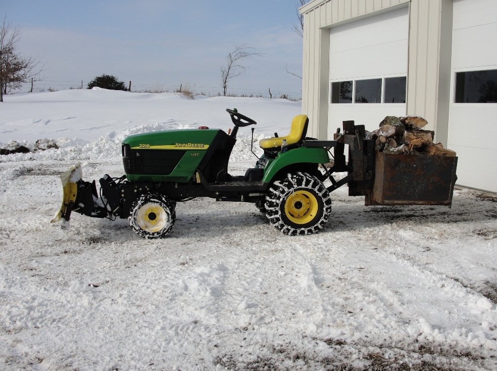

I looked for a better picture but couldn't find one. The picture of the JD2210 gives an idea of how much chain is on the ground with a 2 link design. The grader picture is also of 2 link chain on a much bigger tire. All the tire is doing is holding the shape of the chain.
Sometimes the grader chains will squirm and get the crossbars down into the lug of the tire. You know it by the loss of traction as the weight of the machine starts resting on the exposed tire lug rather than the cross link. :(

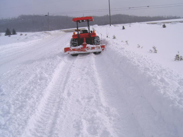

I'm running 4 link chains front and rear.
I have no need for 2 link chains. I have all the traction I need with 4 link ladders I do not spin.
A few Pics of snow I was pushing this week and no wheel spin.
I chained all four tires on my old Ford Pickup years ago. I had all the traction I needed too. :)
