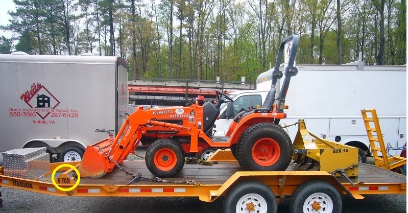

With any decent tractor you are eventually going to want a barn, but many tractors have lived under tarps for years. On a larger tractor you might want a rear finish mower. But unless lawn mowing is going to be the prime use on your 120 acres (congratulations by the way) you shouldn't size your tractor for your smallest, easiest task.

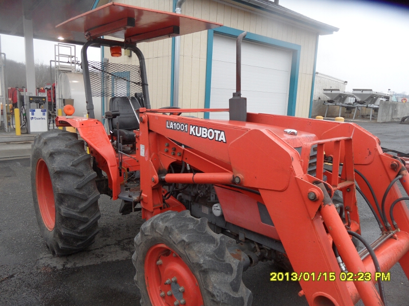

$25K out the door is about what I've spent on my B7610 (23HP), my M4700 (50HP), my trailer and some implements.
2007 B7610, 245 hrs, LA352 FEL, Bush Hog SBX 48 box blade, '07 Hudson HSE Deluxe - 5 Ton 18' foot dovetail trailer for w/ 2 chains and load binders $11.5K from CL in 2009
M4700, 1400 hrs, LA1001 FEL $11.5K from auction Jan 2013

For getting through the woods pay attention to CLEARANCE, the SCUTs are close to the ground. My B7610 is close to the ground, but at about 8".
My M4700
attachment.php
is good for the woods.

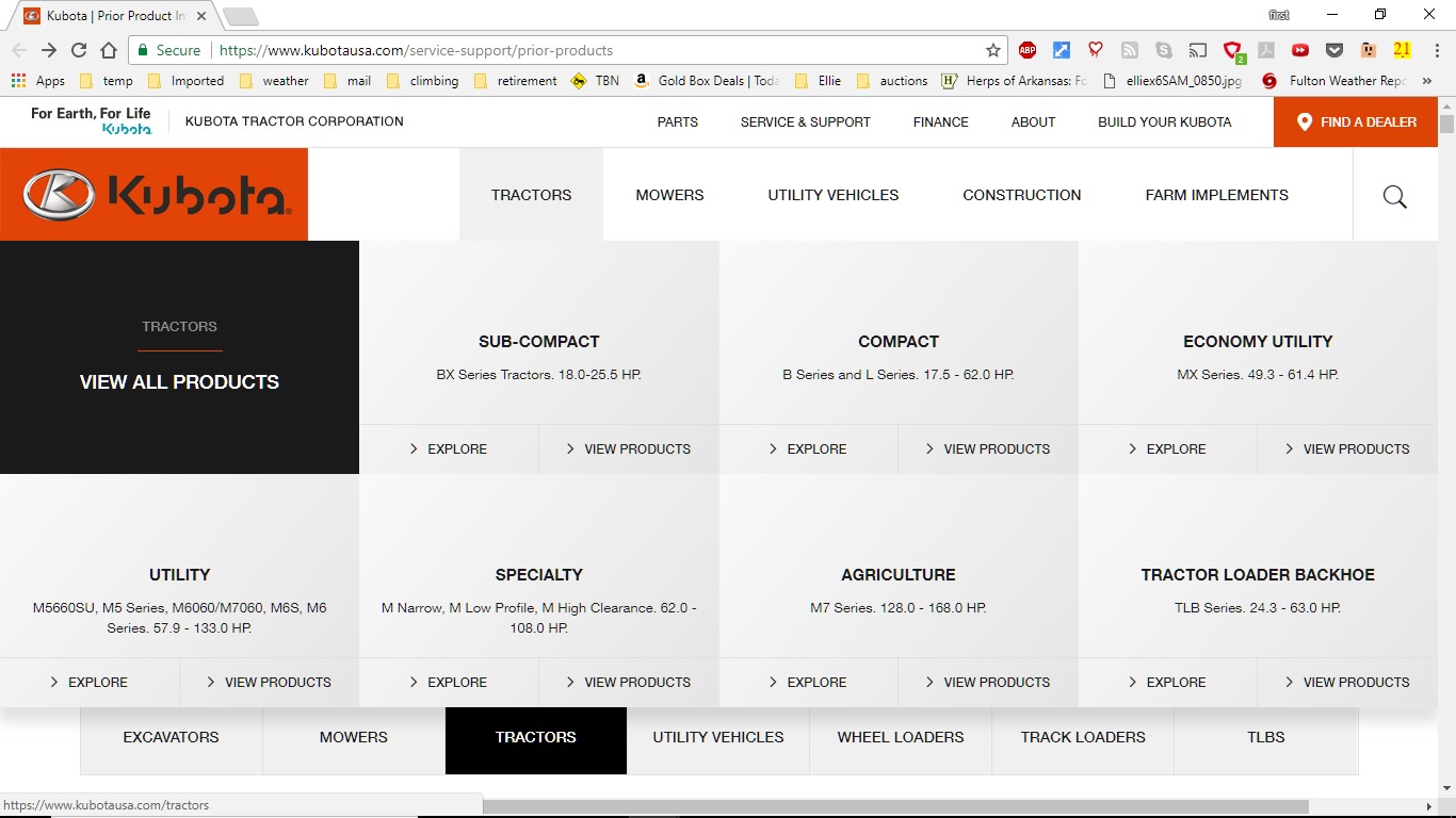

Tractor size and "class" (Sub-compact, compact, utility, ag) are subjective terms. Per Kubota's prior products website a subcompact is a BX of 18 to 25 HP, a compact is a B or L from 17.5 to 62 HP, an economy utility is an MX from 49.3 to 61.4, a Utility is from 57.9 to 133 HP.
The big difference, to me, on the SC's are the small front wheels. The Massey 1526 looks small, like my B7610.
But with MOST tasks my B7610 will do everything my M4700 will do if I have the appropriately sized equipment. It just takes more time.
I can bushhog w/ a 48" bushhog on the B7610, or a 72" on the M4700
I can move dirt, stones etc. with either, just a lot smaller bites with the B7610.
