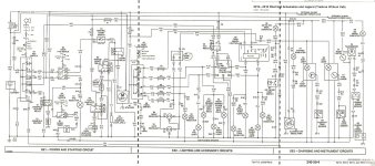

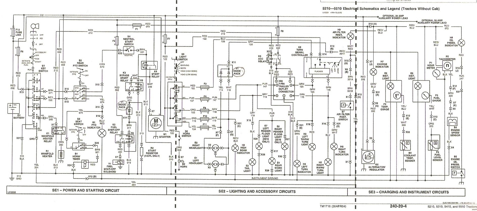

Temperature sender is a variable resistor that responds to changes in coolant temperature. Low coolant temperatures cause high resistance. High temperatures cause low resistance.
Here is some test you can make. All should be made with the engine OFF and the key in the run position. Connect wire from temperature sender to ground using a jumper wire. Gauge should indicate HOT. Unplug the sender wire and the gauge should indicate COLD. If this test fail you will need to test the wiring and the cluster. At this point I disconnect the negative cable on the battery and Ohm test the wire from the sender to the cluster.
I have attached a copy of the wiring diagram.
Insure the ground on the front wiring harness is clean.
