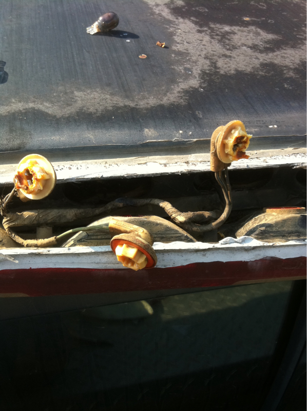

This is odd, wondering if any of you have experienced this. With the cruise control on, when I put my blinker on to change lanes, the cruise control turns off. Any ideas?

Sounds like a bad ground (possibly in the taillight causing power to backfeed into the brake light circuit and making the cruise thing that you just hit the brakes).

Check the bulb on your 3rd brake light on back of the cab.

My guess is you have a short between your brake lights and your turn signal lights. My first thought is the trailer plug.
As you know when you apply brakes your cruise control disengages. This short is making this happen.
Just did. Look at what I found. I took the bulbs out and will see if it helps. Both bed light sockets are melted. Not sure why.

The bulb removal did the trick. Cruise working fine now. Could these issues be a bad ground?
/ 1997 F150 Electrical Issue #13
i'm with the others.. somewhere something was leaking to / affecting the brake circuit, and thus tripping the cruise...
