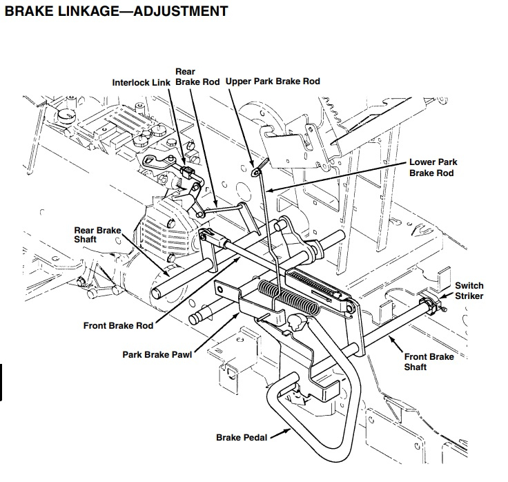

Can you post up a pic or two of that seal?
Schematic from the service tech manual.. brake linkage
Beenthere

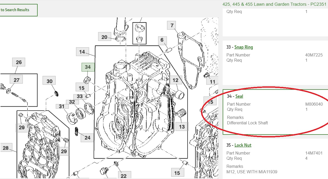

I think it was diff lock shaft seal going into side of transaxle case but could not find anything on Deere parts breakdown. Recall had same problem when fixing the unit. It is buried behind linkage between frame rail transaxle
/ 1996 John Deere 425 transaxle leak #9
That diff lock shaft seal is what I was thinking too.
part # M806040
Yes that is the seal and the part number if I have to replace it in the future.
