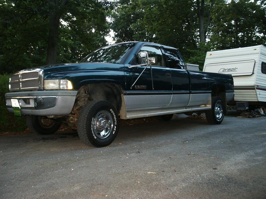

I have a 97 2500 4wd auto with 143,400. No mechanical issues, however the paint's not holding up on the roof.
M.D.
