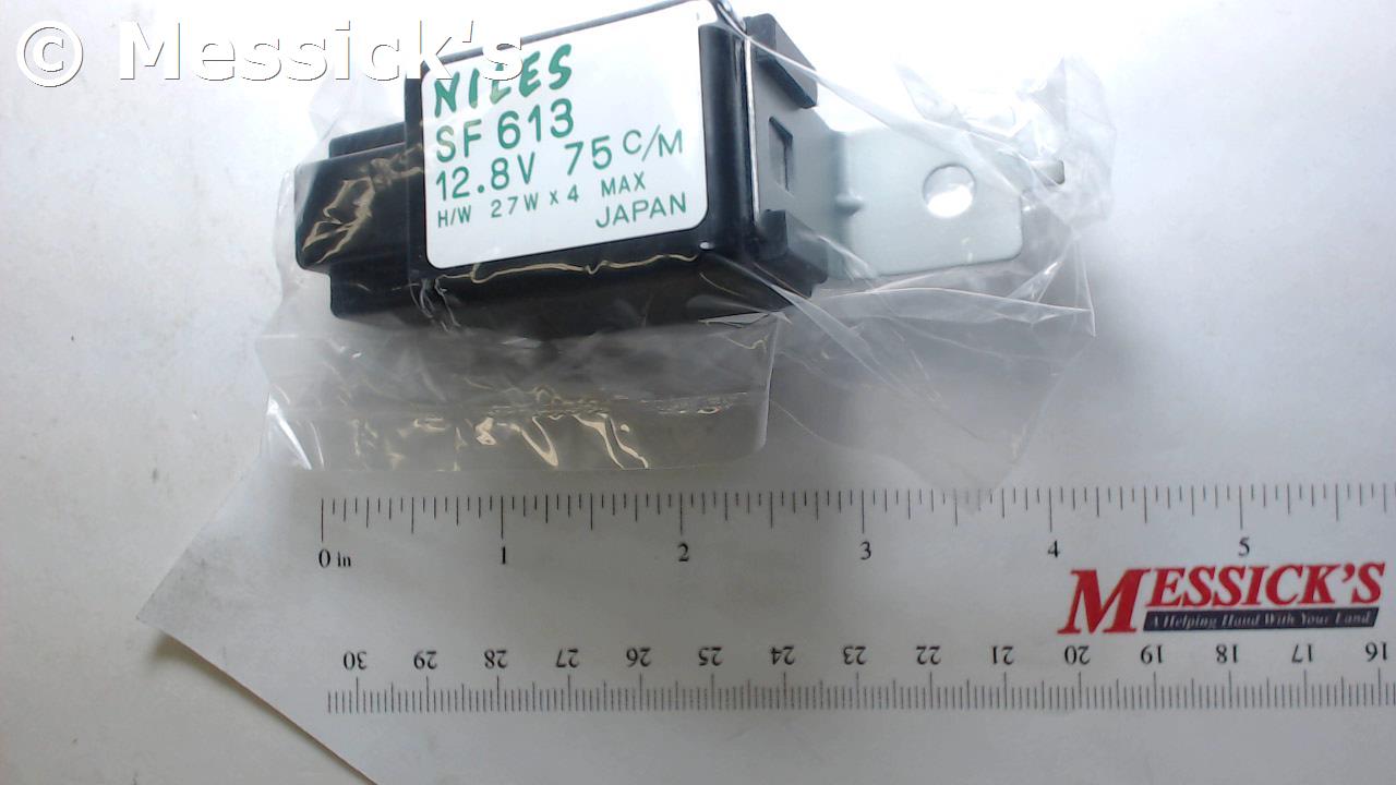

I am a new member today. I recently bought a 1993 Kubota L3450-DT in Alabama with 600+ hours and a front loader and bucket. Runs good and while it has wear and tear, it was a good purchase I think. Here are my problems. I fixed the fuel gauge (connector to sensor top of tank was disconnected), no tail light (bought a new tail and a new rear wiring harness and now got a tail light), Here's the problem: hazard lights not working (bought a new rear wiring harness, and a new combination switch for dash, and checked 10A fuse for hazard lights, but still no indication of power flow to the connectors on the wiring harness to the hazard lights). Also, need a SMV bracket to mount the SMV sign. Ordered a new fuel stop solenoid because key off did not stop engine. All advice appreciated. I am new to diesel and tractors but smart and soak up got advice. The electrical problem with the hazard lights having no power is my big problem. Thanks to any who can offer some advice.

Welcome to TBN - there's a flasher 34220-33700 that operates the hazard lights (#130 on the parts drawing). The pic is from Messics.

Thank you rbargeron. Appreciate it. Think I will order the original unit from Messick's since I think I also want to replace the air cleaner sensor.

My L4150 1990 vintage has a bad connection at the fuse socket. Try to jiggle the fuse for the flashers. You might freshen the connection by slighlty bending the blades on the fuse.
/ 1993 L3450 Hazard Lights problems
Thank you for the tip. I will try that. I noticed the fuse sockets were crusty.
