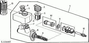

Did you check the clutch master cylinder reservoir???
/ 1992 John Deere 2355 Clutch problem
No, where is it located? The dealer told me it could be my master cylinder goin out and that would be the first thing to replace before splitting tractor.
/ 1992 John Deere 2355 Clutch problem #4
It's in front the dash. You'll have to remove the cowling(parts key #1) to access it. You're probably going get the experience what a PITA it is to bleed the air from it.

PITA=pain in the hinny. Yes you can add brake fluid but if air has gotten into slave cylinder they are difficult to get the air out of them.

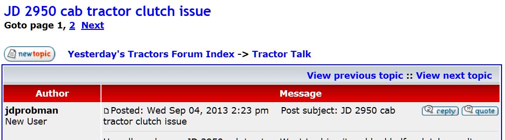

If you have any problems bleeding then read this thread on another tractor forum. It has a lot of good information.

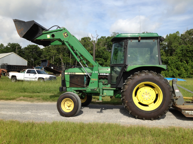

Here is my tractor it is a 92 model good condition and straight 3400 original hrs needs a cab kit what is it worth?
