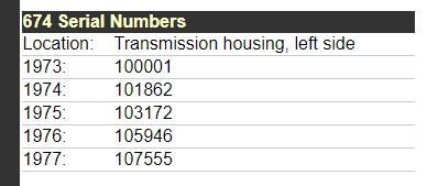

674 is 62 PTO HP. They were built in Doncaster England or final assembled in Louisville KY from UK skid unit. 1973 first year.
No doubt some were still being sold new in 1978 or later. The 684 came out in 1978 (replaced the 674)
There is a serial number list on tractor data, but it doesn't state if it's US or UK.
TractorData.com International Harvester 674 tractor information
Since you are in Canada, it's likely a UK build, the headlights will be in the grill.
The 684 Is a 3.9L diesel aswell, all they did is turn a screw, it strangely lowered PTO hp

674 and 684 use same D239 and both were rated 62 PTO HP.
574 used D239, but was rated 52 PTO HP. 584 used D206 at 52 PTO HP, there was also a 474 that used the D206 at 48 PTO HP.
