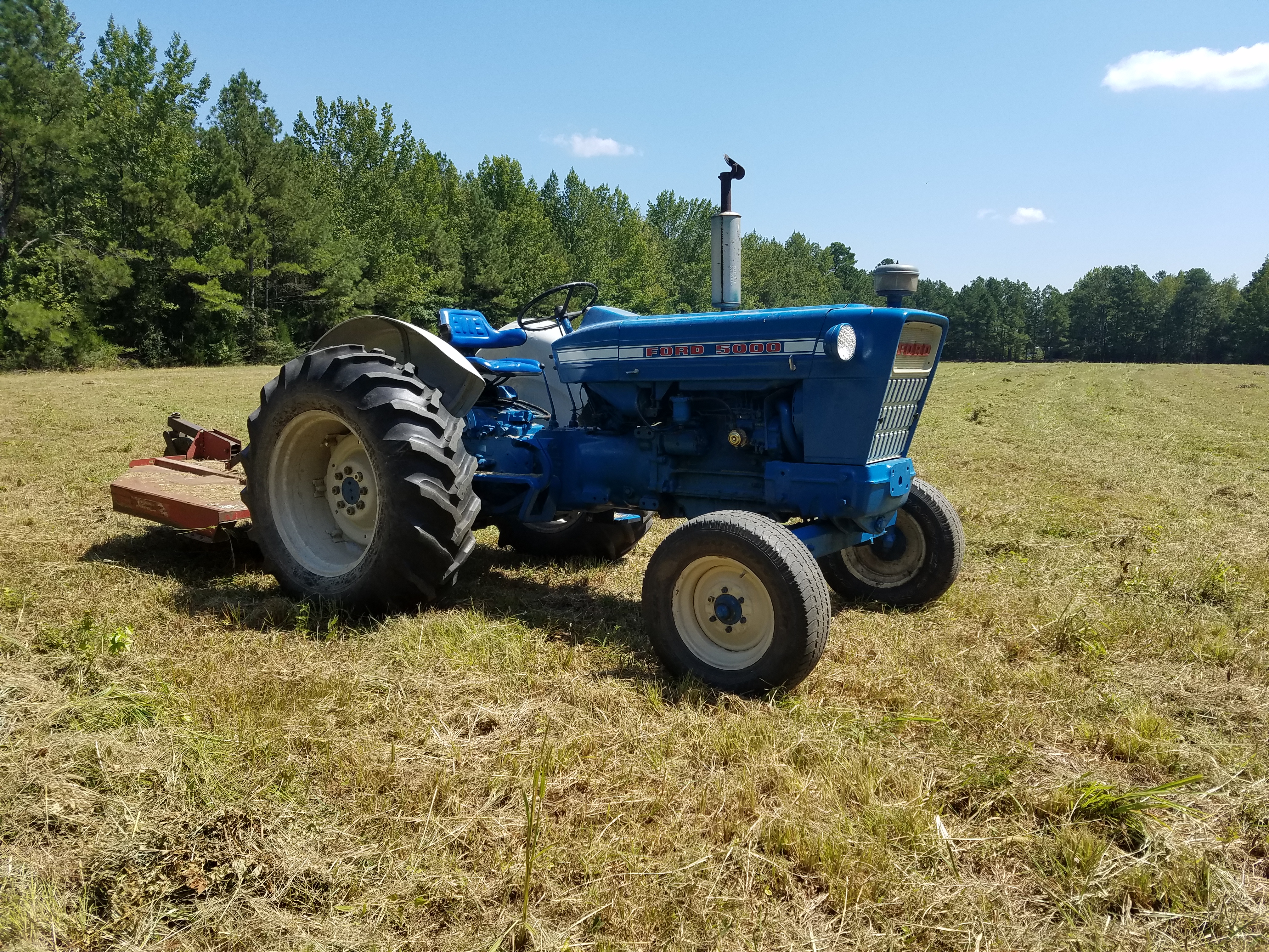

My tractor is a 1972 ford 5000 and has factory power assist with a engine mounted pump and last year about this time I put all new o-rings in the sector and valve body.
My question is when I let go of the wheel it feels like the power steering is trying to return to center but center is slightly pulling me left I have to hold tension on the wheel to the right to drive straight.
The reason I re sealed it all is because it was leaking out of the steering wheel.
The wheel is easy to turn to full lock in both positions but just wondering if I got something off when I read sealed it because I only used it a few times before I tore In to it shortly after I bought it but I don't remember it pulling.
By the way I need tie rods because the previous owner at some time welded washers over them to keep from popping out.
Any input is greatly appreciated thanks in advance.

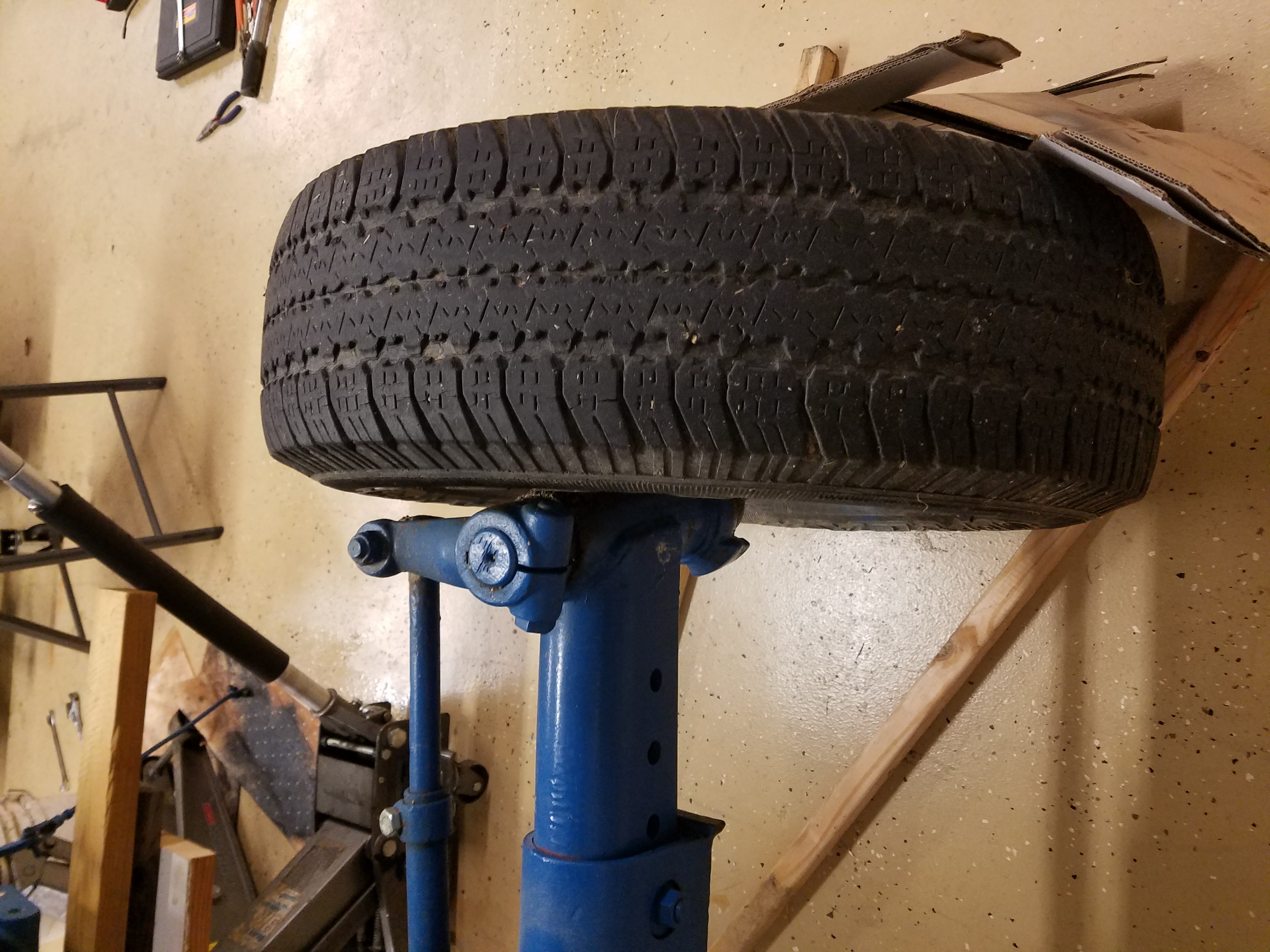

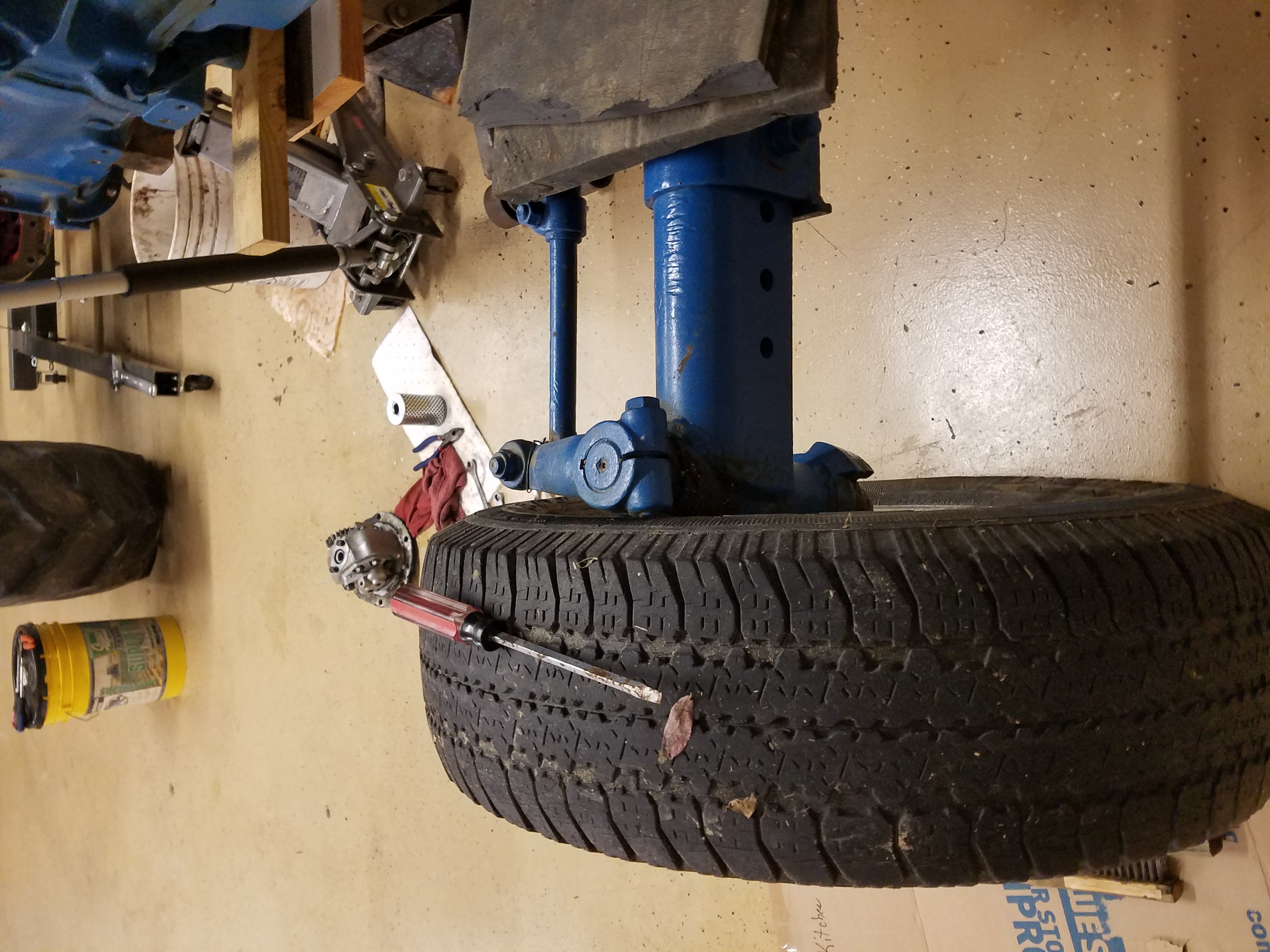

Also I have car tires on the front and on the driver side I have a gap between the tire and the arm that the tie rod connects to but on the passenger side the tire rubs the arm once during a rotation could this indicate a bad wheel bearing or hub?
Thanks.
