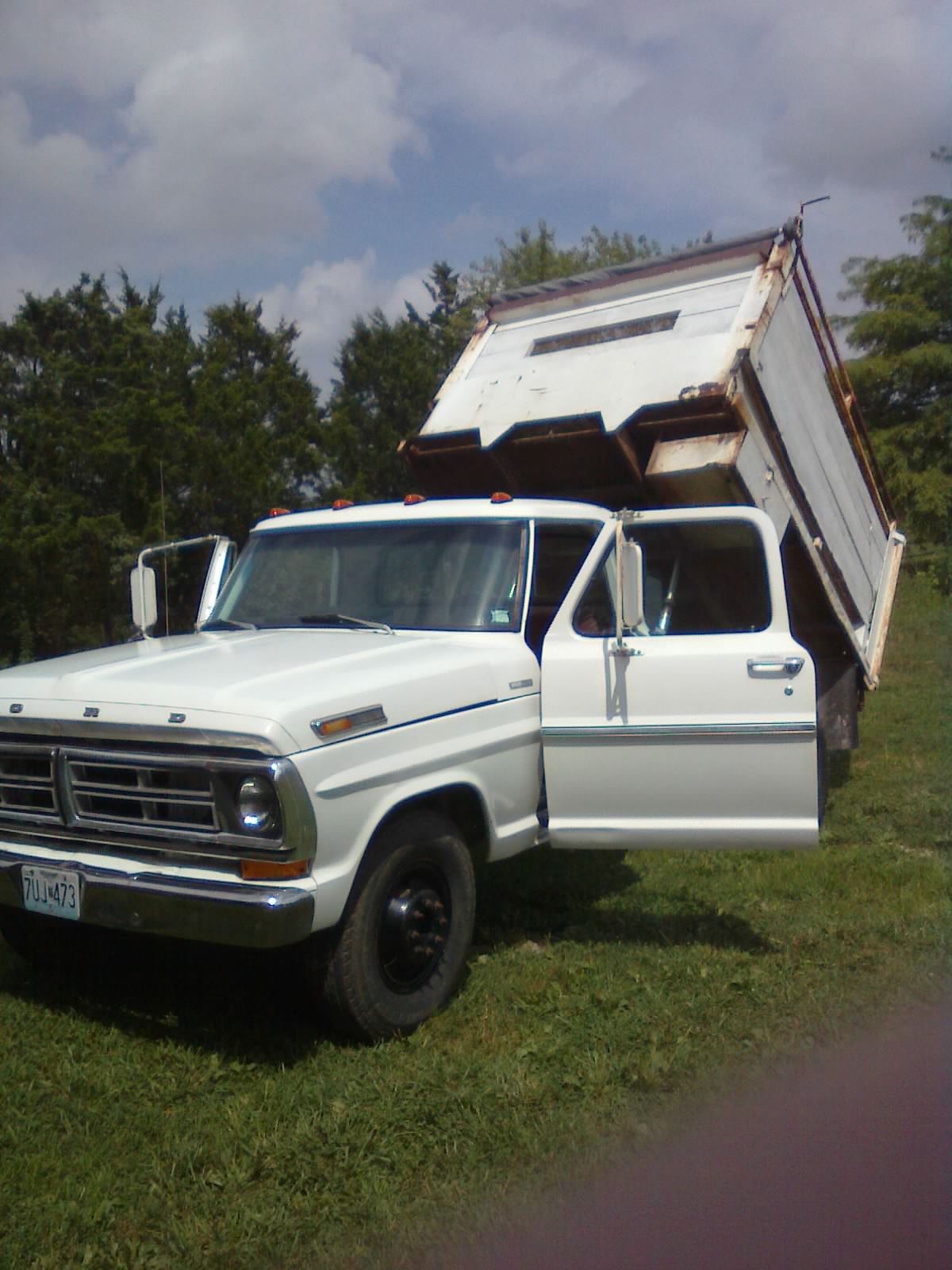

I've had a 71 F350 for about 4 years and it was $1500. The cab was eaten up and one fender. The truck came with extra cab and fender. I switched it all over and now it's not too bad. It's got the levers in floor for dumping.
I only haul about 3.5 tons max from the quarry,but if hauling wood maybe a little more. The sides are 4' but the bed is only 8'.
The guys are spot on about capacities. I've got the 360 with 4 speed and it's a little slow but won't give up and 50 mph is about all I want to drive empty.
