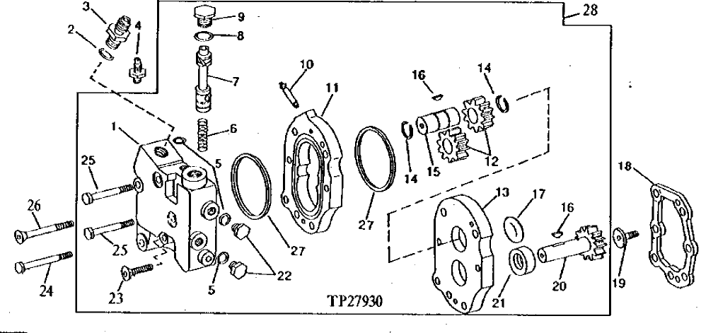

Hi Bill here, I have a 68 jd400 also, I'm getting hydraulic oil in my motor filling to where it comes out the dip stick, ??? anyone know why this might be happening?
/ 1968 JD 400 #6
Are you sure it's hyd oil or is it diesel?? It would be very difficult for hyd oil to travel to engine. Does hyd oil leak out the drain hole in the bottom of clutch housing?
/ 1968 JD 400 #7
Yes positive, I put new seals and a new fuel injector pump and fuel pump in, was fine and then bamm hydra oil in the motor. Crazy, everyone I talk to say's the same, I'm pulling the pressure valves out next. I don't know. Keep me in mind.
/ 1968 JD 400 #8
OK my old pee brain just remembered how hyd oil can get into engine DUH!!!!!!. Early 400's have a power steering pump bolted to RH frt of engine and the seal failed.
/ 1968 JD 400 #9
I will look into that today, I will get back to you, thanks.
/ 1968 JD 400 #11
Yes #21 is the seal. AR53048 Packing ADD 16.82 USD
#18 T20273 Gasket ADD 2.40 USD
#27 @ 2 ea R39297 Washer ADD 2.57 USD 5.14 USD

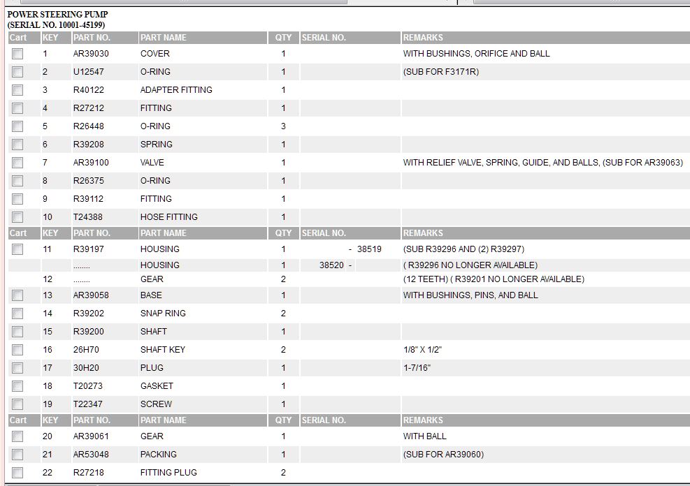

/ 1968 JD 400 #13
Jim by any chance would you have a part number for the #13 pump base and # 17 expansion plug. My parts are shot. Seals are also shot.
/ 1968 JD 400 #14
Here you go. Parts key # 13 AR39058 Base ADD 536.47 USD
