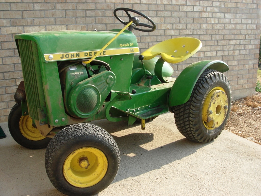

My little old tractor seems to have goofy electrical problem.
The generator light on the dash is supposed to come on at very low engine RPM and also when the generator is not charging properly.
On my tractor the generator light only comes on at very high RPM and then stays on continuously, regardless of RPM until I shut the engine off. It has behaved like this for the one year that I have owned the tractor.

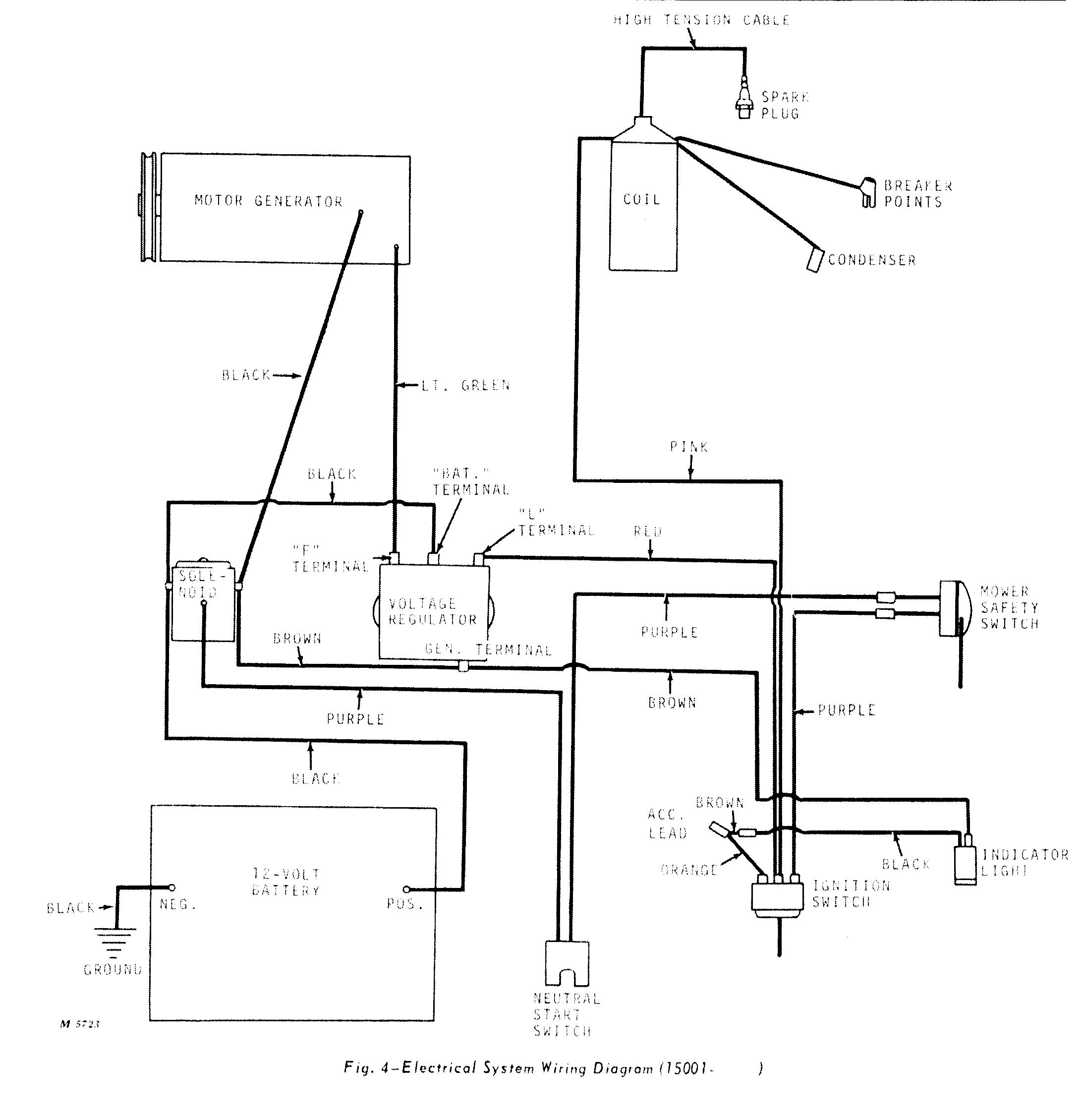

Any ideas what's going on? I have attached a picture of the tractor and also the schematic. Thank you!

I can't tell from your schematic where the second wire from the indicator light goes.
From "normal" automotive wiring the indicator light is between the stator output of the generator and the +12V supply. If the generator is not outputing, current flows through the indicator from the battery, generator windings and finally to ground. With proper generator output there is no to a small difference in voltage so no current flows through the indicator lamp and it stays dark.
Sounds like this is the inverse. It is only lighting when the generator is at full output. Could be that the non-stator wire is grounded.
Trace the wires from the indicator. One goes to the stator of the generator and the other should connect to a switched +12 source most likely at the ignition switch.

Could the generator be over charging causing the light to come on?? Bad regulator?? Put a voltmeter on the battery to see what it is charging to.

Operating normal with the tractor running at pto speed I would expect 13.7 to 14.2 volts. If it is overcharging anything above 15v.
Just for giggles have someone load test the battery and make sure it is good. If the battery had a dead cell the regulator would try to charge it, causing the generator to go to full charge.

A little update...
Per several of your suggestions, I put a meter on the battery to see what the charging system is doing. So here it is.
At slowest idle, the generator is putting out just barely over 12 volts. Then as I increase engine RPM, the charging voltage increases comensurately up to about 13.6 volts at about 80% throttle. Increase the throttle past 80% and the charging voltage abruptly drops back down to just over 12 volts. Once this voltage drop occurs it sticks there, regardless of what I do with the throttle thereafter.

Mmmm, That doesn't sound right. I'd say you have a charging system problem..it' doesn't appear to be severe, yet.... but it's not right.
/ 1966 JD 110 Electrical Help Please #12
Sounds like a bad requlator to me.
/ 1966 JD 110 Electrical Help Please #13
My guess is the brushes in the generator are worn.To trouble shoot that you need to start it up and increase the throttle until you hit the point where your voltage drops back to 12.With your volt meter connected to the battery,tap the generator with a hammer handle or screwdriver handle lightly.Tap the end where the brushes are located,(the same end that the wires come out).As you are tapping it watch your volt meter if your voltage comes up to 13-14 volts or fluctuates as you are tapping your brushes are worn down and need to be replaced. Tim.

Well, it only took 14 months, but I finally got her fixed.
As it turns out, t man Tim was right. I replaced the brushes and she runs like a top. Genny light comes on when the engine isn't running, and then shuts off when it starts.
