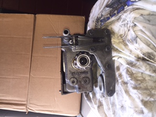

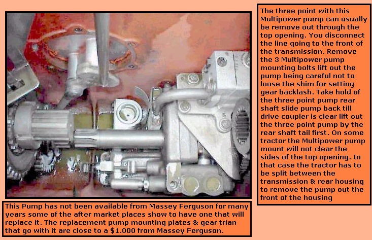

I have a 1964 MF 165 that is/was equipped with Multipower. The lever is present, but the linkage is not hooked up. The electrical plug on top of the tranny housing that I read somewhere was also a part of it is present but the wires are cut. After pulling the top plate off, I found that the Multipower pump is also present but the top fitting where the line runs forward to the tranny is not connected (present but no line attached). The pump can be seen in the last two pictures I attached.
This is only relevant because my 3 pt lift is VERY weak, slow, and shaky (previous owner disclosed that when I bought it). I drained the fluid, which had minimal metal shavings, and flushed out the filter, which was in pretty good shape. You should be able to tell that the gears appear in excellent shape. New fluid and clean filter made zero difference in lifting ability. Therefore, I can't imagine it being anything other than the pump.
Everything I read said I'd need to split the tractor in order to remove the pump if the tractor was fitted with Multipower, but I'm just not setup to do that safely. Therefore, I tried it anyway. In order to even have a chance, I had to remove the small MP pump that sits to the front left of the housing, attached to the main hydraulic pump. Since it just pumped fluid up and right back out into the housing, I saw no harm. It got down to a couple of millimeters (not kidding) but I was able to wiggle it out. Made my day.
You should be able to tell in the pictures that the MP pump attaches to the main pump by bolting onto a heavy piece of angled iron that is bolted onto the main pump itself. There are NO line/fluid attachments between the two. The small pump has a gear in the back that is driven by the large gear in the back of the main pump. It is now rendered useless, and I don't intend on reattaching it. Here's the heart of my issue... This is the first time I've ever taken a tractor apart like this (thank goodness for the internet and the simplicity of old, reliable equipment) and I have no idea how to really assess what kind of shape the interior workings of this pump are in. The pump itself looks great (damage/wear-wise), but that, of course, doesn't determine functionality.

3rd. You have the old style Multi-Power pump that can be removed from the top, the newer ones can't.

Kenneth...thanks for your time, friend. How much of a job am I looking at with that cylinder seal? It doesn't seem it would be THAT big of a task, but I'm an admitted novice. Anything I need to be especially careful about? Should I go ahead with the pump project if the cylinder seems fine (really don't want to fool with taking that lift cover off again)?
And thanks for the pictures...I figured there was a reason that I could get that pump out that wasn't my superior mechanical intellect. :D

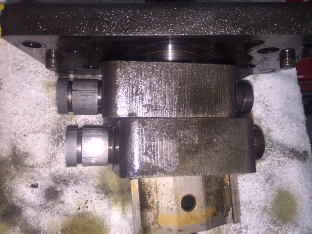

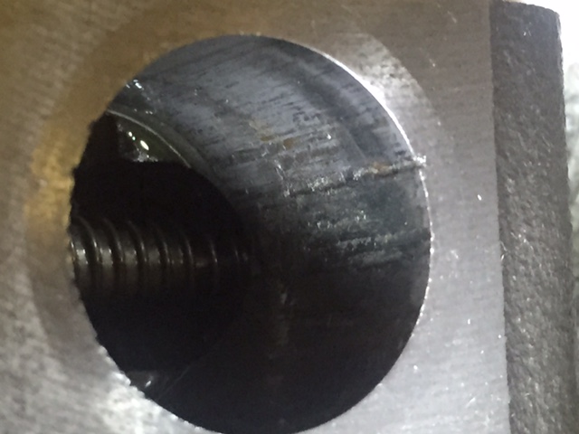

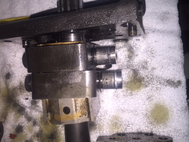

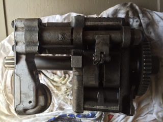

Just to update, again for anyone out there along with Kenneth that has some expertise, the two plugs on the left side of the cam blocks are both missing their rings. The corresponding cylinders are scratched pretty heavily, as you can hopefully see in the pictures. It would seem to me that this would be enough to explain my problem, and that the easiest thing to do is a rebuild, as the architecture of the pump itself is in great shape. Kenneth, I also checked the inside of the lift cylinder, and it appears to be in pretty good shape. I can still replace the seal since I have the cover off, but still would like to know if I need to disassemble the workings of the lift cover in order to get the piston out. Thanks again.

With the top cover off you can raise the lift arms, and remove the "dog bone" that goes from the lift arm shaft to the piston. You should be able to slide the lift piston out by hand, or use compressed air if needed (but be very careful if you use air). The piston in the lift cylinder will probably have 3 piston ring type seals similar to like you would see inside a engine.
That pump has seen a lot better days!

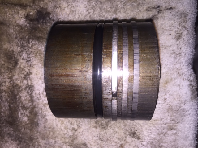

Got the cylinder off (not easy.....the vertical lift assembly is bolted into the side of it. Yuck.) and this is what it looks like. The rings look decent but the seal doesn't even look like it is wider than the piston. Oil leaked from around the head as I tilted it to get the piston out, so if it leaks under NO pressure, I can't imagine what it's doing under HIGH pressure. The cylinder looks usable; I don't have the machinery to bore it down any, but I THINK replacing the seal (and maybe the entire piston? Thoughts?) will be adequate. Opinions?

That lift cylinder, and piston looks pretty bad since all that junk when through it. If it were me I'd get a new cylinder, piston, and seals.
