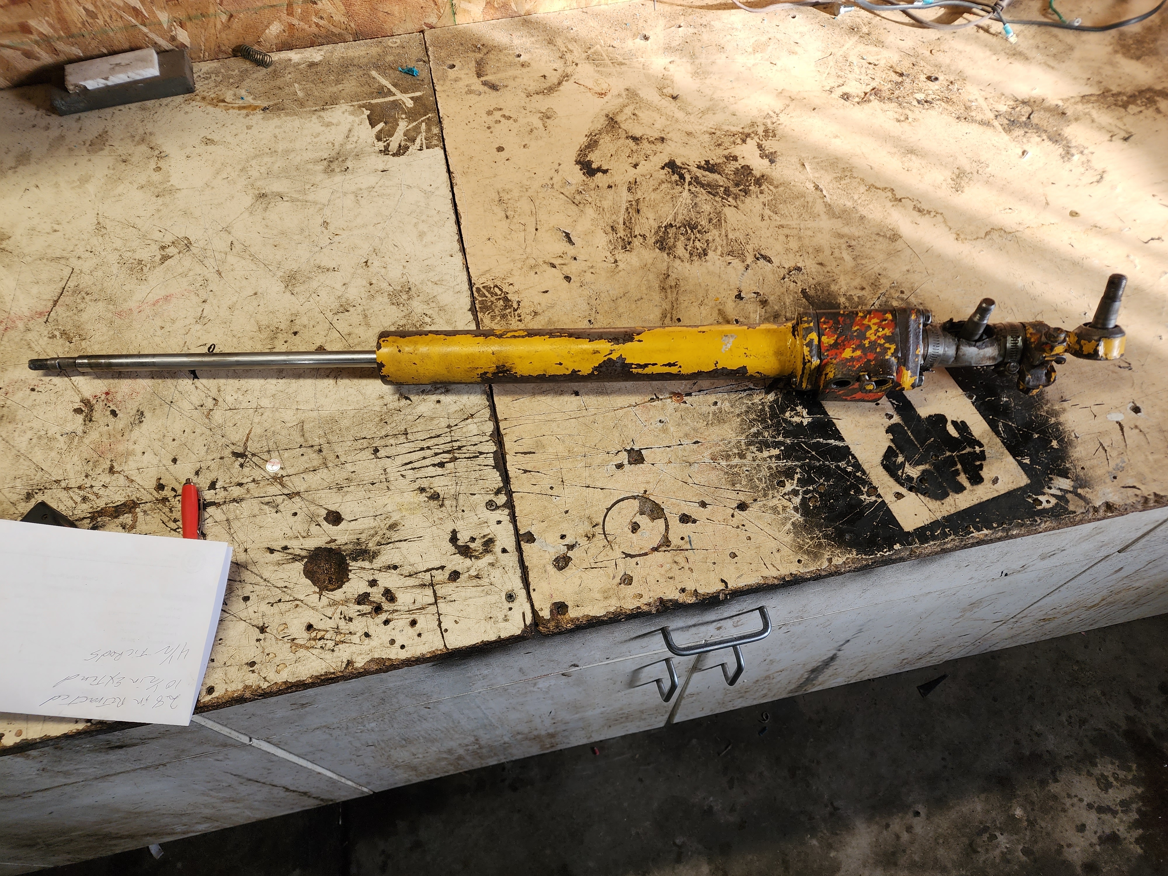

Did you ever figure out the power steering? I picked up a 530ck Backhoe as well, and the wheel is almost impossible to turn. Certainly seems like something is binding up, and the power steering definitely isn't working.
I'm trying to find some issue on the single cylinder power steering system, and like you, can't find much info about it.
Hi NBraun,
Welcome to the forum! Not sure what you mean by: did I get the power steering figured out? I never had trouble with my power steering.... However, another member (mayorbob) asked me if I could help him with figuring out his power steering. He posted pictures of his model and I had never seen that particular type before and could not give him an answer.
Post a picture of what you have and let's see if we can identify what your problem is. If it is like mine, there are really only 4 parts to the system besides the hoses and hard lines and they are: engine driven power steering pump, steering control valve, steering manual pump, and last but not least, steering cylinders. It may be as simple as one of the wheel spindles is bound up in the bearings and a quick test for that is to jack up the front end off the ground, undue both power steering cylinders at the connections to the spindles. If you can move both front wheels manually with the tie rod still connected with no resistance then you have at least isolated the problem to the power steering system and not a mechanical problem with front end.
Also, check your power steering fluid level. If you don't have any fluid or it is too low there won't be any power assist! Post a picture and let's see what you have. Thanks NBraun, good to hear a new voice.......:)

I believe mine is the early steering, with one cylinder on the axle. I checked the fluid level and it was empty. With fluid in the reservoir, the steering has gone from basically impossible to just having to really muscle the wheel. So a bit of an improvement for sure. I'm not sure if I need to bleed the system of air, and if so, how to do that, or if there's something else I'm missing.
The tie rod ends are shot, which I'm sure aren't helping anything. I'm generally pretty handy, but without seeing a diagram of the steering system i'm having a hard time figuring out what to look for next. They really managed to cover up all the systems on this tractor!

I did a little more research on the type of 530 that you have and here is what I found on another forum and this guy seems to know a lot about the 530 and 530CK Cases. Now this information does not directly answer your question about what do about your steering problem, but it will give you more information as to where to start researching your particular model of Case 530. I am just copy and pasting from that forum the response:
1960-1966 Case 530CK
If you just want to get your backhoe home, lift up the loader and put a 4x4 across the front of the hood/loader support, to hold the loader up, then take a couple of chains and come-alongs and pull the hoe up closer to the tractor so it doesn't drag on the ground when you go up the ramps. Then, back your trailer up to the machine and winch (or push) the 'ol girl up on the trailer.

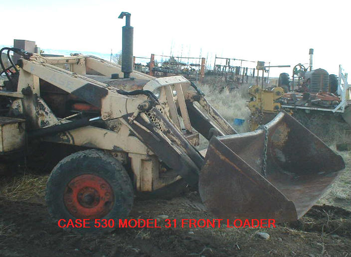

When looking at a Case 530 T/L/B, if you actually pay a little closer attention to some pretty obvious details when looking at them, you will notice some substantial differences between a 530 and a 530CK, which I will go into a little more detail below.
On the Pre-1960 Case 530 Tractor/Loader/Backhoe (with Model 31 loader & hoe):
The front-end loader design was actually the most "in-your-face" obvious difference.
1.) They did NOT have a hydraulic self-leveling bucket feature.
2.) The loader's dump cylinders attach directly to the loader arms and to the bucket, like most conventional Ag loaders use.
3.) The front frame structure of the loader's frame is different. The 530 (model 31) loader had a massive "brush guard" if you will, built into the front "wrap-around" style loader frame. The loader framing ran horizontally and relatively parallel with the ground.
4.) The 530 T/L/B was still very much an AG tractor with the front hood tinwork constructed with the infamous Case "eyebrow" hood & headlight design. This required the front loader framing to be a "wrap around" design for strength and for a lower mounting support.
5.) On the hoe, you'll notice the boom swing cylinders are mounted up relatively high up, above the main pivot points and on either side of the boom "out in the open", so to speak.
Below is a PIC of a Pre-1960 Case 530 with a Model 31 loader.

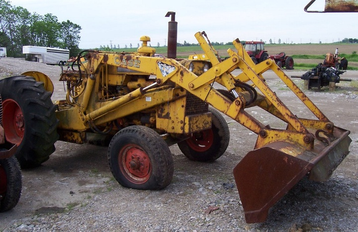

On a 1960-1966 Case 530CK (with Model 32 and later loaders & hoes):
1.)There is a short vertical hydraulic cylinder used for "self-leveling" the bucket when the loader is raised and lowered. It is located on the right side of the loader mast, just ahead of the loader control valves.
2.) Self-leveling bars and such are used and work via a pivot that is part of the loader arms. The dump/tilt cylinders mount to the loader from (and pivot at) the sides of the barrel, and not from the cylinder end. The rod end of the cylinders mounts directly to the loader arms, and NOT to the bucket. This setup allows for the self-leveling to function, as well as the ability to curl the bucket back further, thus holding more capacity in the bucket when digging into a pile.
3.) The "newer" style CK loader frame (the Model 32 loader) is bolted to the front sides of a heavy steel "wrap around" front nose structure that is an integral structural part of the "nose" of the tractor, utilizing the tractor's front structure for part of the loader's structural integrity. You will also note that the loader's side frames run on a DIAGONAL from the upper part of the front of the tractor, to the lower front of the rear axle.
4.) Gone was the old Case "eyebrow" headlight design, in lieu of the new heavy steel wrap-around piece that allowed for the loader frame to be bolted up to it.
5.) On the hoe, you'll notice the swing cylinders are mounted down low near the ground below the hoe's main frame, and near the lower boom swing pivot point.
Below is a 530CK with a Model 32 "hydra-leveling" loader.

That style of steering was used on utility and loader-tractor loader backhoes until sometime in 1964 when they changed to hydro-static steering with the twin cylinders
I hope this help you with your research NBrawn, cheers👍

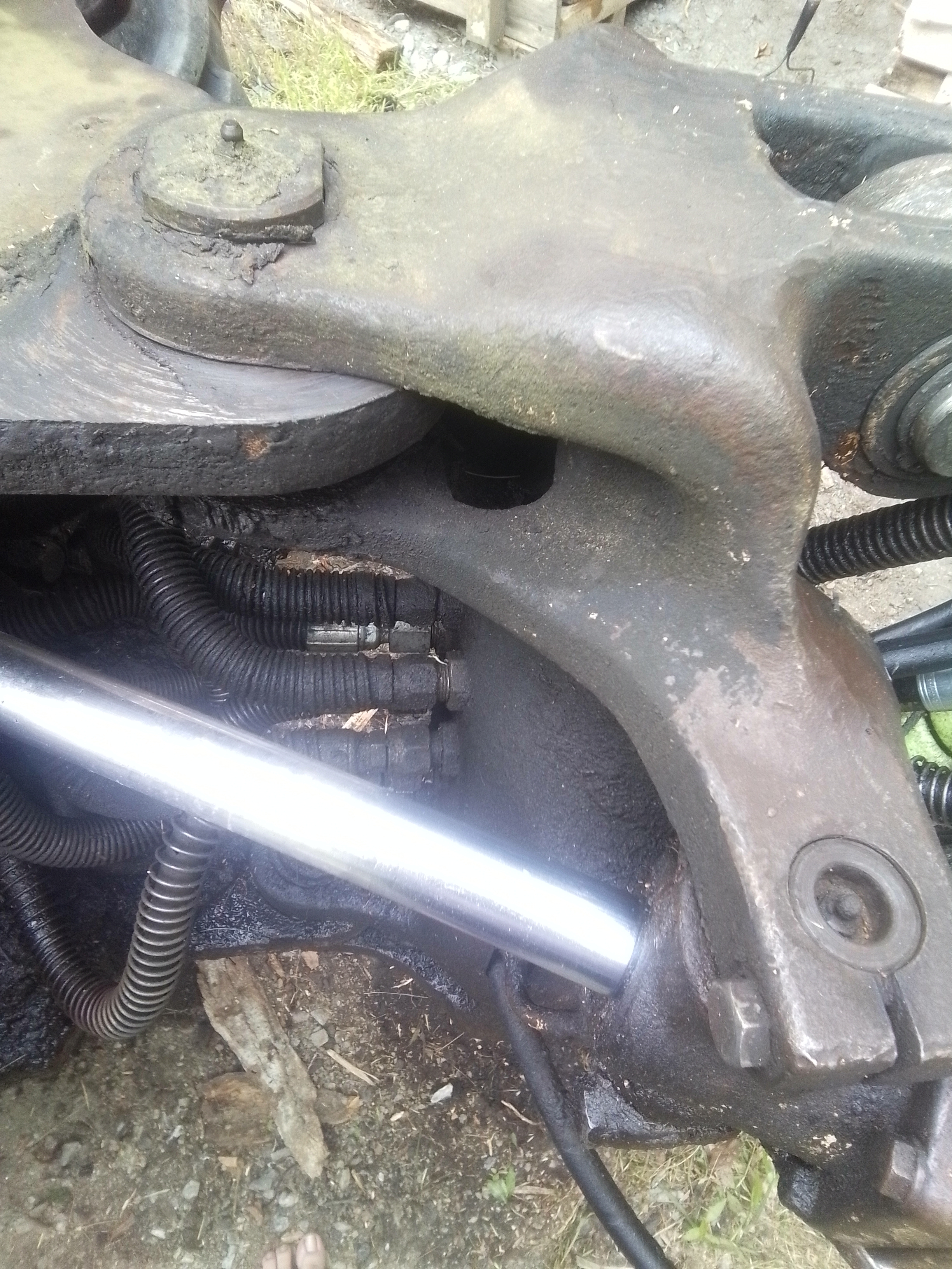

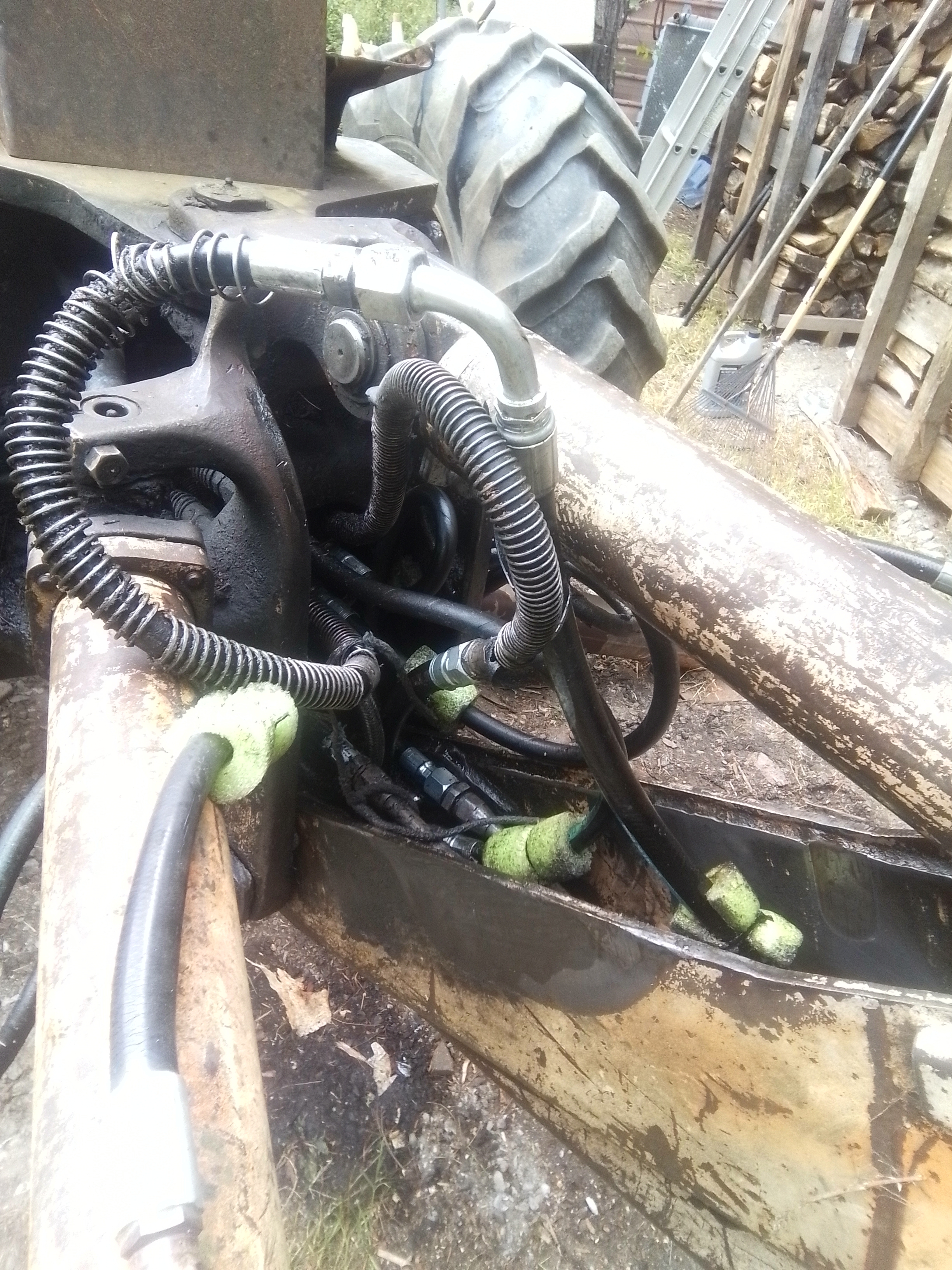

Hey, I'm going to be replacing some lines on the hoe of my 530CK and was wondering if you could help me out. I'll take pics when I can but there seems to be a LOT of extra line in the base of mine, and I was wondering if I should try and bypass the extra or just tie it up better than the last owner. Mine doesnt seem to have a pass through clamp but instead passthrough fittings in the hoe's base frame. Mine also has the outward facing swings.

Iv got a 1962 case 530ag with the ck backhoe setup on it i have 2 major problems one I can't find the right steering assist ram hear is a picture of the one I have the other problem is it's a shuttle shift I'm not sure of my problem but it won't fully engage or disengage if you have any suggestions on wear to look to fix that or any idea wear to get the steering ram i would appreciate it look forward to watching the progress on yours
Thank you for your time

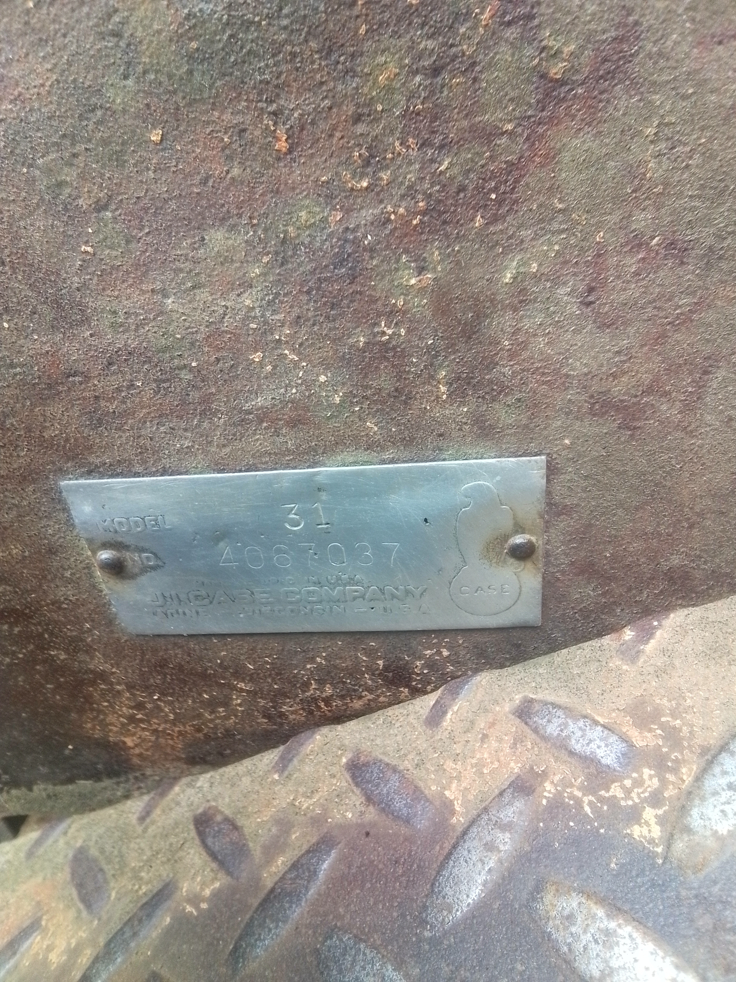

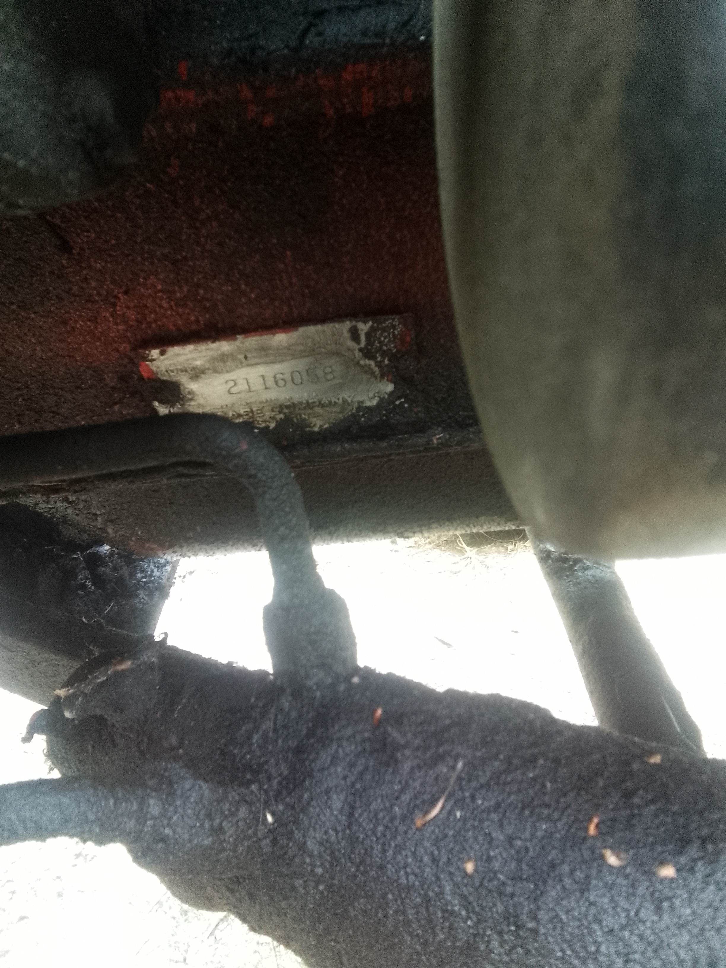

I was told by the previous owner that mine is a 63, but the identification plates are missing on the tractor and loader. The identification plate on the backhoe says it's a 31 model however instead of a 32. I have double piston steering. I also did find the engine serial number plate. I have pulled the hoses out of the boom arm (without unhooking anything) to show how much extra hose I am seeing.
