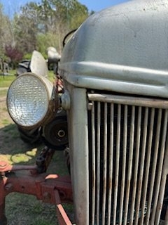

Have another issue. Trying to get the grille to fit. The spring loaded tabs at the two upper corners don't mate with the corresponding holes in the hood. The grille is not bent that I can see, there is no gap between the hood and side hood. None of the sheet metal at the hinge point of the grille at the bottom appears bent or out of place. I wonder if there is another issue I'm not familiar with.
   / 1948 8N #10
The hoods of the N tractors are a jigsaw puzzle and it can be a real trial getting all the parts to line up correctly. You probably need to loosen up the bolts holding the doglegs to the hood and tweak things to make it all line up.
For the record I have never seen a hood on an "N" tractor that fit very well.
