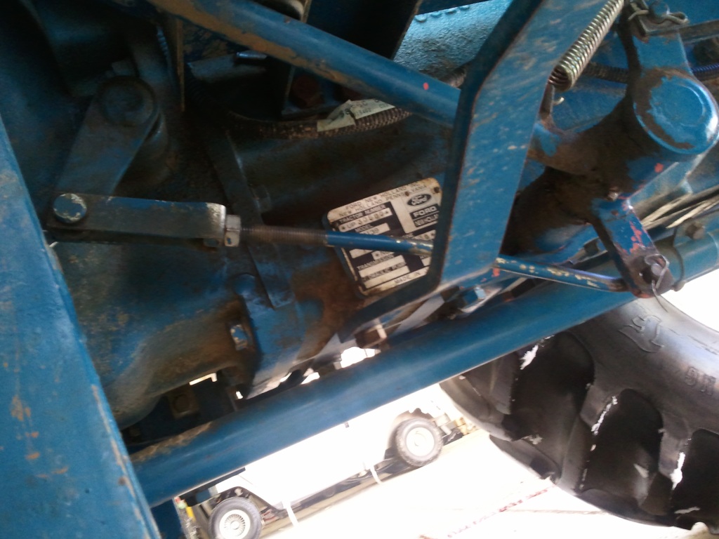

Yaay! That did it! I staved off the NH dealer for a little while longer.
The clutch pedal free play went to 3/4" to 0. Not sure how that happened? :confused:
I adjusted it back and power has been restored. I guess it was in "riding the clutch" mode.
Funny thing is I adjusted it last year. Maybe the clutch is starting to get worse.
My PTO is still stuck, but I have yet to take off the FEL and mounts to adjust it through the hole in the housing. That would be my last shot before carting it to the dealer. Replacing the clutch will be a little more than a first timer like myself can handle. I'd like to try though.
Thanks guys!
(ignore the pic with just the cotter pin holding the linkage on it. I wanted to test the clutch before putting the washer and a new pin back on it.)
