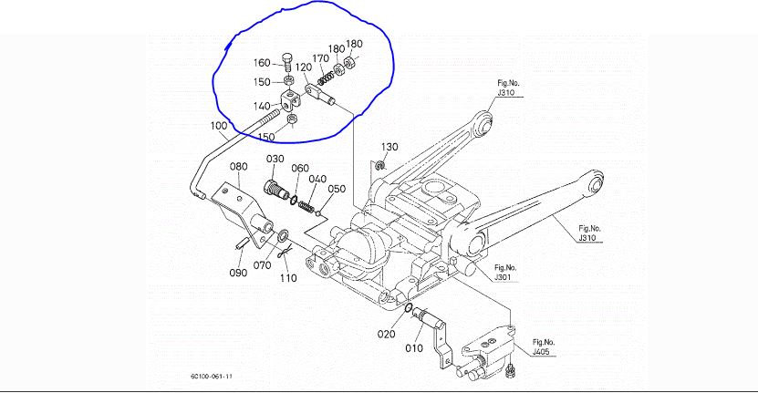

There's usually a valve to control the speed of the 3 point, on mos Kubota's it's right under the seat, centered. This occasionally get's blindly and unknowingly adjusted by my the heel of my foot moving around.
Just recently on my B7610 I could not manually lower the 3 pt using the lever. If I left the boxblade on I could raise it fine but the lever when pushed forward to lower would bind. A little looking around and a quick spray of WD40 fixed it.
470687d1464947128-186-3pt-wont-drop-3pt-feedback2-jpg
The rod (100) was binding on the rod holder (120). Just needed greasing. REAL SIMPLE FIX.
Can't you download schematics online somewhere?

Check feedback rod.
