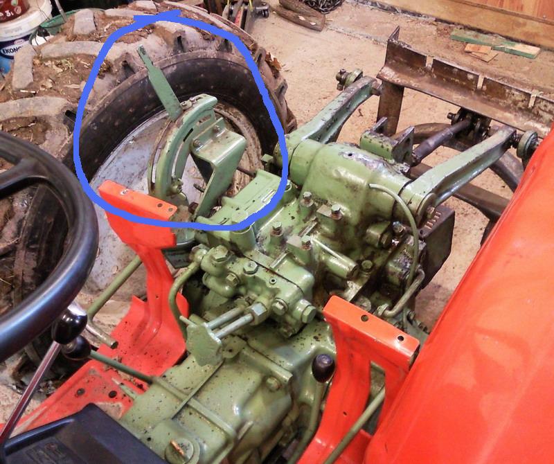

Hi everyone:)
I'm new to this forum. I live in the Sudety Mountains, in Lower Silesia in Poland.

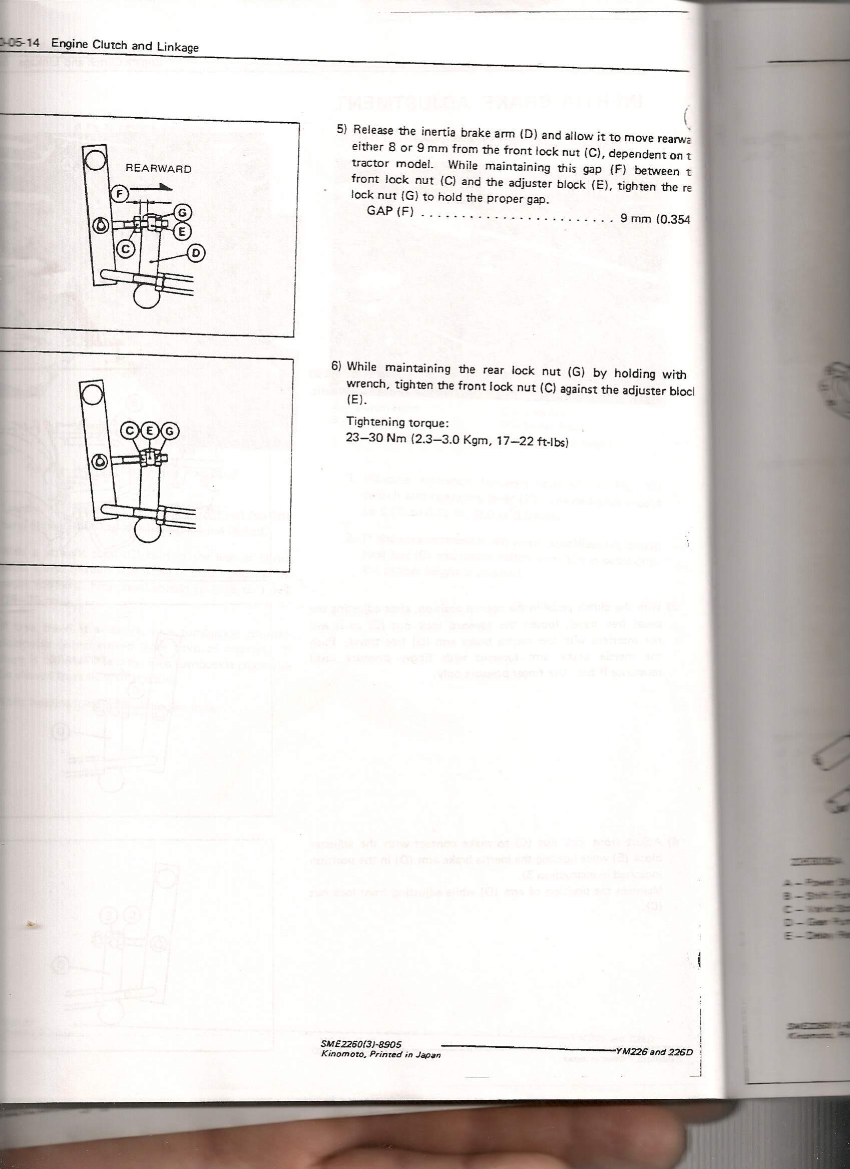

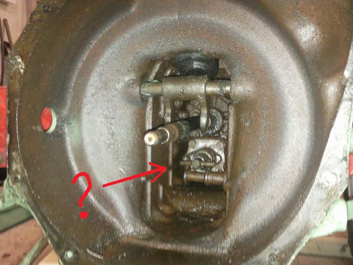

A week ago I bought a tractor - Yanmar YM1810D. This is my first tractor and I have some questions about its construction. For starters - the clutch: I now replace the clutch and in the clutch housing I saw the other lever, below clutch lever . This lever is jointly controlled clutch-pedal - what is the mechanism?

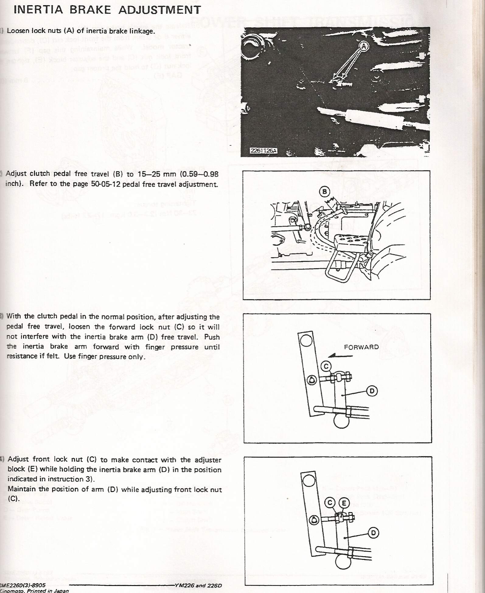

/ 1810D - my first tractor #3

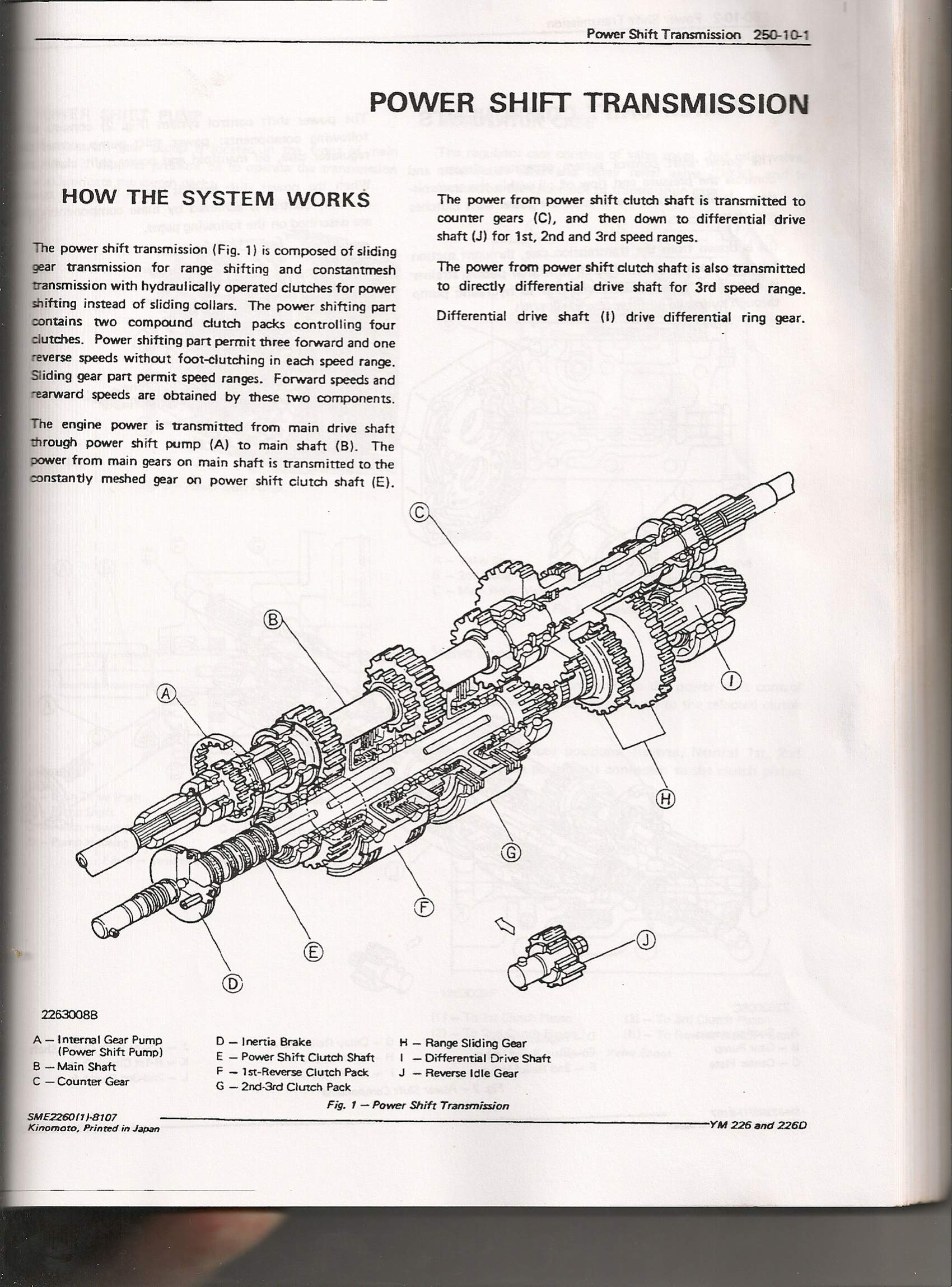

It is called the inertia brake. I have an adjustment procedure for a Ym226 which is probably like your 1810d but that is a guess.
Thanks for the information.
How does the inertia brake ? Can you write the adjustment procedure?
/ 1810D - my first tractor #5
Here is a try. That is about as clear as the pictures are in my manual. Other than the picture (ref D) there is not anymore information about the inertia brake. Hope this helps.
Winston thank you for the scans:) Now I know how to properly adjust the inertia brake.
But I'm still curious about the function of this mechanism....
/ 1810D - my first tractor #7
Me too. I believe as the name implies, it some way stops rotation on the power shift clutch shaft. :confused:

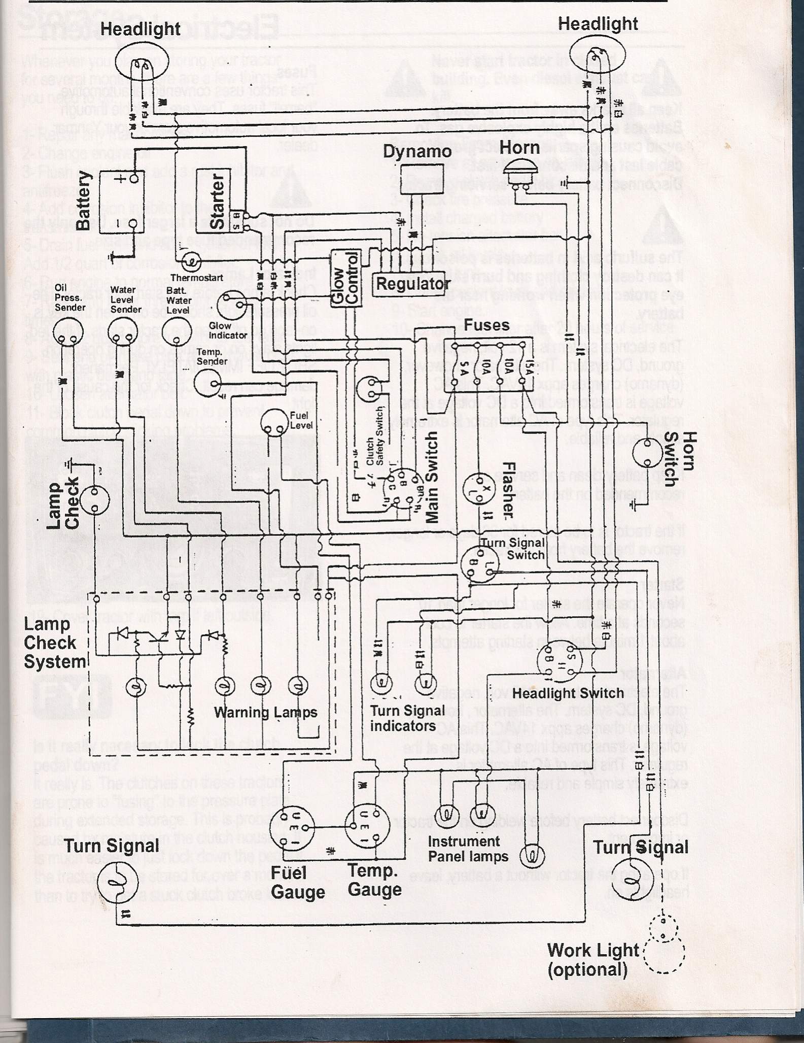

If anyone has the wiring diagram for my tractor, or similar?
Seems that everything works, but I have a few separated plugins, and I do not know what they are.
/ 1810D - my first tractor #9
Here is my YM2002D out of operators manual. Don't know how close it is to yours.

Thanks. This electrical system is the same as in my tractor.
My clutch sensor was disconnected and the cables from the starter were bridged. Before, I did not know what doing the clutch sensor.

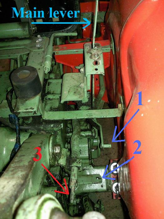

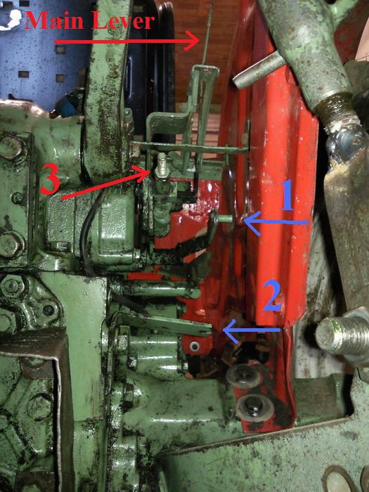

#11
Hi.

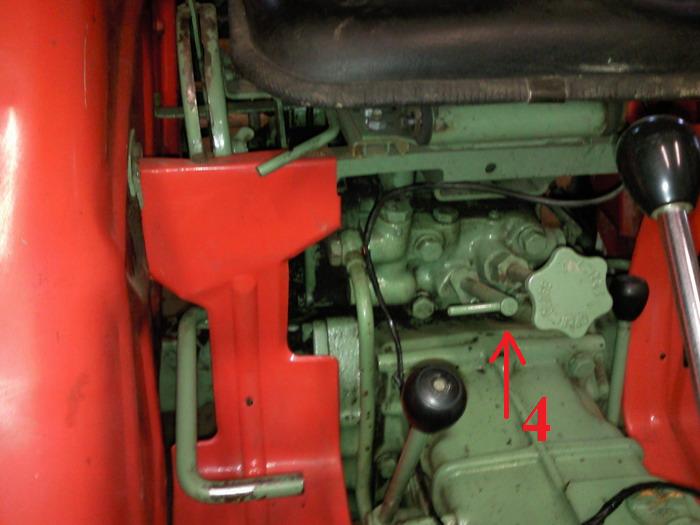

Today I have questions about the hydraulics on my tractor:
What is the lever No. 1?
What is No. 2? Looks like the point for the linkage.
What adjust bolt No. 3?
And what is the controller 4, on the last photo?
/ 1810D - my first tractor #12
Mickey_Fx or Ernie are the guys to answer questions about 1,2 and 3. Pretty sure they have to do with draft control for a tiller. I believe #4 is your slow drop lever, depending on position your 3 point will lower slow or fast.

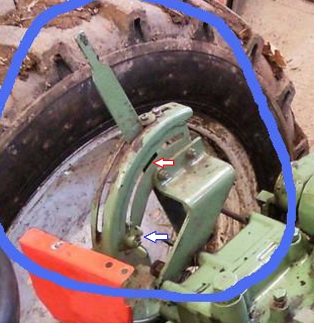

Does anyone of you has the same hitch controller? In my lever does not lock, it moves quite freely and can not be set in a particular position. My guess is that at the lever should be some friction lock -limiting freedom of movement. I have an idea how to do it, but I'd like to see how it looks in the original version.
I have the same problem; note at the bottom of the lever; on the side theres a wing nut that has a rubber bushing on it I think it is a friction lock for the lever; but I could be wrong as my bushing is worn out and it wouln't hold the lever; I posted a new thread to get further answers ...
/ 1810D - my first tractor #19
The friction control mentioned should be where the red arrow is. The wing nut at the blue arrow is movable so you can use it as a stop when lowering the three point. See if there isn't a hole in the control arm to match the slot.
