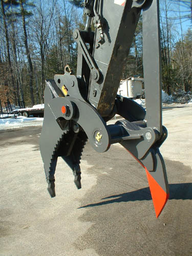

Some land I drive by was logged recently. Fir trees up to about 30 inches. An excavator dug up about an acre of stumps near the rear corner, so I never got closer than about 200 yards. It took only a minute or two per stump. It had no dirt-moving bucket at all, but was equipped with something that was close to this photo.

Giving your stumps a year (rotting) or more will make stumping a whole lot easier if you have the time. Hardwood stumps will fight back a lot harder than softwood, and those 3 footers, better count on a real struggle unless you have one of those stump shears shown above.
