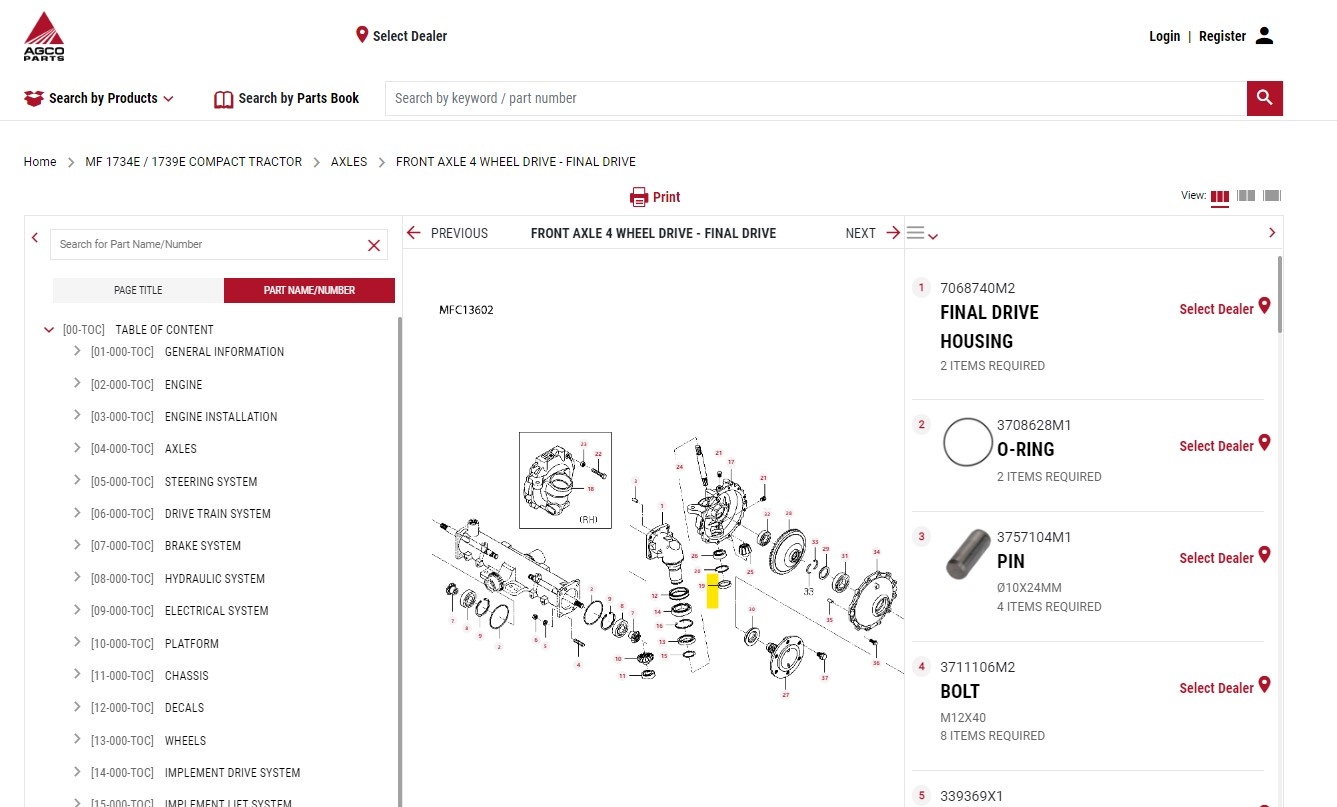

I'd start with the AGCO Parts book online like which will look something like this:
Next would be to get a shop manual if the online Parts Book breakout doesn't have enough details.

I'll admit that I have had issue with that site as well. If you get to the pages you need I'd take some screen shots or printout.
I'd try a couple of internet searches for a service manual. If you are forced to buy one from AGCO its not going to be cheap, but then a front axel repair is probably not a minor fix if that's what you are looking at.

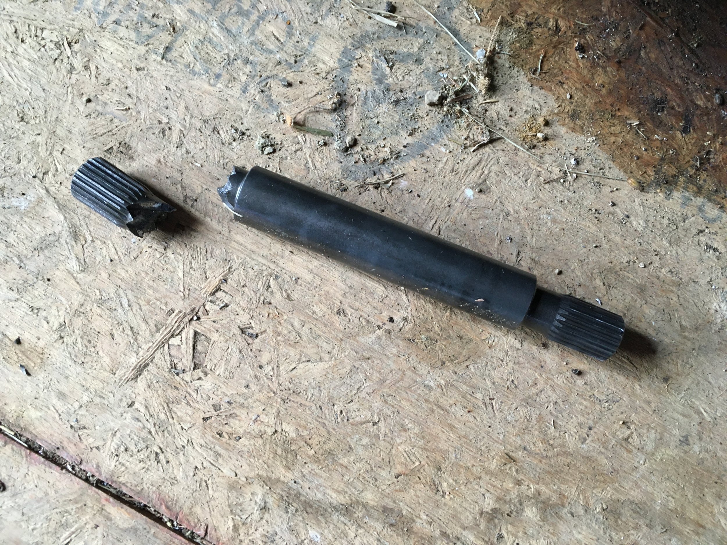

Ok its been a while but I finally zeroed in on my problem. I could see the axle turnin through the fill cap hole on the right side so I pulled the left side final drive and found the axle had snapped inside the final drive. Parts are in at the dealer and fortunately a lot less than I was anticipating. The easy diagnosis was the side with less resistance wasn’t turnin all the gears to the axle shaft therefore it freewheeled much easier than the other side
Wow.. Thanks for the update!! Any idea what might have caused that?
/ 1739e front wheel drive broke
Loose nut on the steering wheel and seat,haha. Was pullin little trees, pullin up on tree with the front loader created downward force on front end and enough traction for the weak point to reveal itself. Actually a pretty simple repair especially since I am already familiar with mechanical front wheel drive from John Deere units
