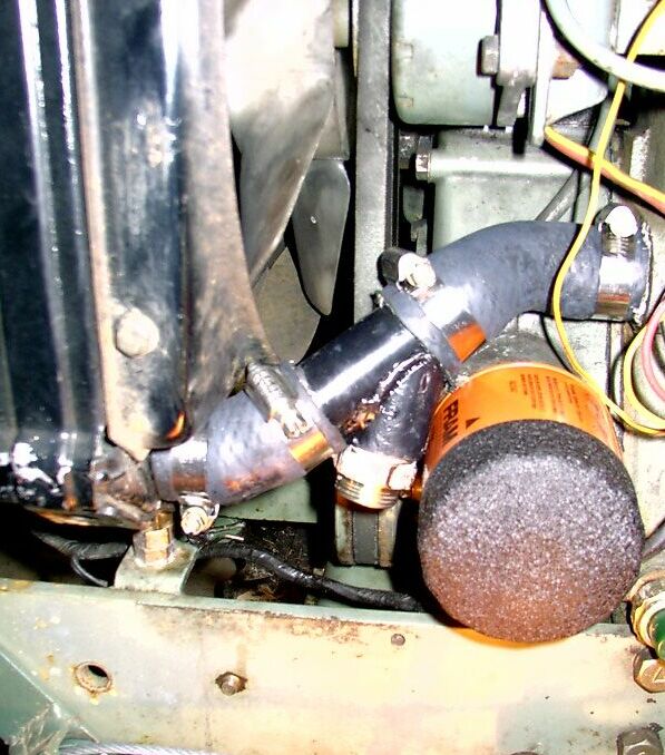

I don't use the TS systems in my two Yanmars. I put block heaters in both of them. I plug it in about a half hour before I want to use the tractor, and it starts like its 70 deg out. I would definately recommend a block heater over the TS. My YM1301D has one that goes into the water jacket through a threaded hole on the right (exhaust) side of the engine block. I made a pipe with 3/4" NPT spud to go in the lower radiator hose on my YM1110D. I bought a 400 Watt heater from Advance Auto Parts which threads into the spud.

Thanks for the responce. You responded to me when I asked about a block heater. I would like to go that route, but I have no threaded ports on the exhaust side of the motor and I don't have enough clearence in the lower radiator hose to install a heater there either. I looked at several different heaters at NAPA, but I can not find anything that will work (hose heater, soft plug heater). Seems like everything I have looked at either won't work or not enough room to install. This is why I have gone to the thermostart. Maybe I can talk the wife into heating the barn (riiiiight)!

Fig,
I had the same problem with my YM1110D. No threaded holes, and only a single freeze plug - I was reluctant to use the ONLY freeze plug hole on the block for a heater. The lower radiator hose was so short and bent, that I couldn't find a heater that would go on. So I took a short piece of thin walled 1" pipe and cut a piece out of it. I then cut a 3/4" NPT coupling to weld to the 1" pipe at an angle. I then used a 400 Watt 3/4" NPT block heater from Advance Auto Parts. It threads into the 3/4 coupling, and the element goes up into the 1" pipe. I attached a photo of it installed on my YM1110D. I just finished making a second one for the YM1110D I sold recently.

Thanks for the information and picture. I see what you were talking about now. The only reason why that would not work on mine is because the alternator is on that same side, so the fan belt runs around the lower radiator hose making for an even more confined space. If it was not for that, then the hose heater that I looked at at NAPA or one like yours would work. I have come to the conclusion that it is time to call Hoye to see if I can get the whole TS system. Thanks to all for the help.
