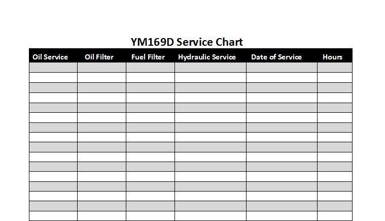

Just made a new service chart. :thumbsup:
