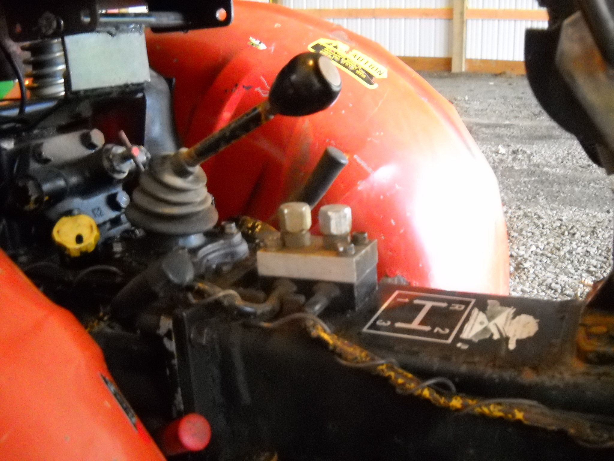

In your last post you had some photos showing the new shift pattern decal; I can see you have caps on the hydraulic diverter block. How is oil even getting to the three point hitch?

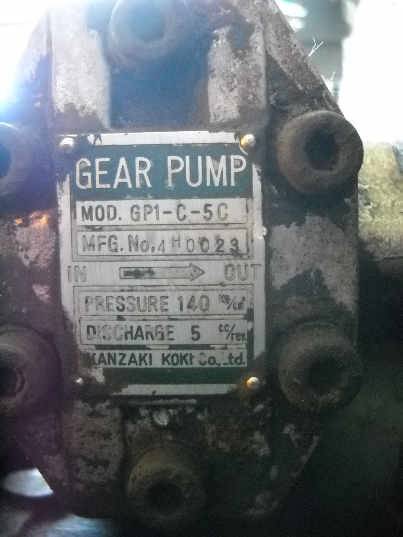

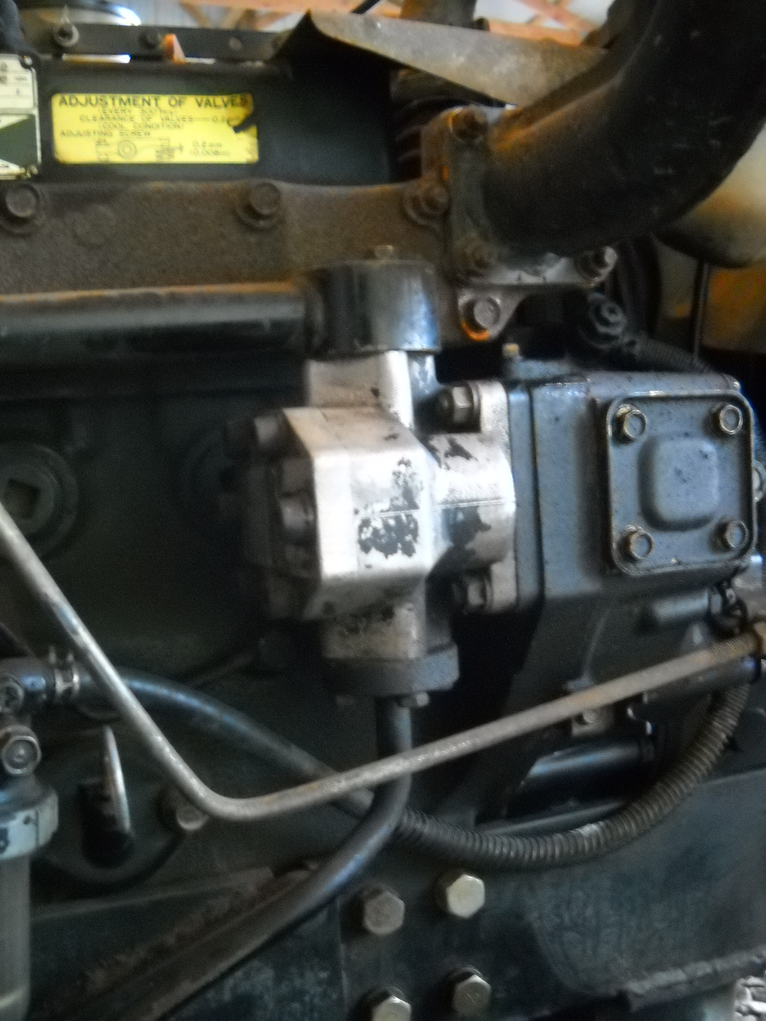

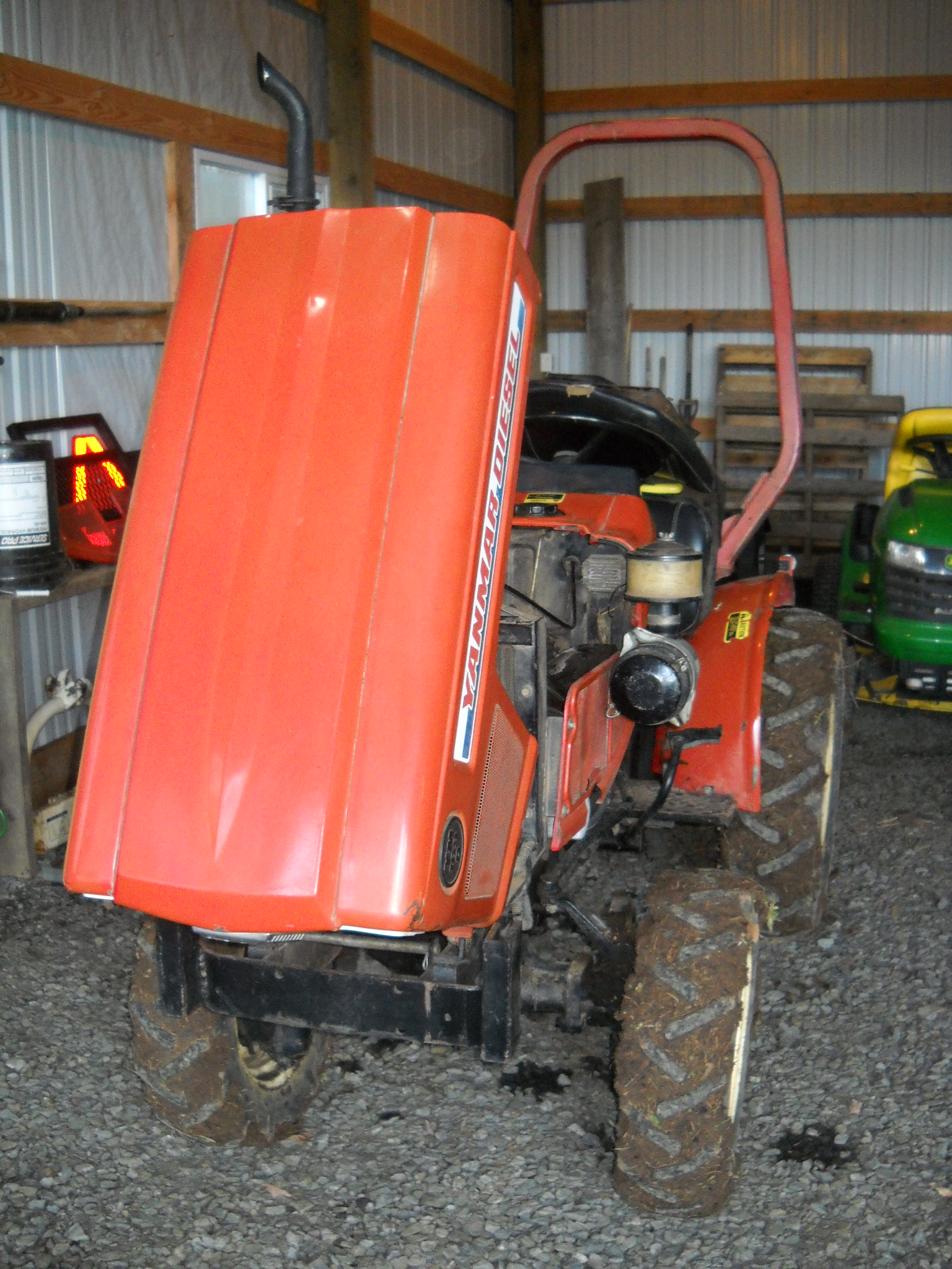

The oil mush be getting through since it has been that way since I got it. I actually checked the hydraulic oil right before I drove it as well as the engine oil and it was topped off with both. My hydraulics don't screech, it just bogs the motor slightly and wont move with any sort of load. It barely lifts my imatch quick hitch and barely got my box blade off the ground. I di get it to lift all the way up with only the imatch but with the box blade it just cant do it. There must be a bypass through the hydraulic ports because that would be the only way that pressure cold reach the 3 point hitch. Since all I could think about this morning was my tractor I went out and looked at the pump. There are no leaks anywhere, so I cant see that hydraulic fluid was low. I also looked at the spot where this occurred and there was no hydraulic fluid in sight. I got a few pictures of it, I really want to get it fixed, I was going to move some logs but cant until I fix it. Thanks for the reply! :thumbsup:

Not familiar with the 169 but assume the little valve with the red end on it in your first picture is the stop valve. Try slowly closing that valve with the engine running. Engine should start loading up, if it doesn't, I'm going to speculate you have sheared your pump key. Even with a sheared key the interference fit between pump coupling and shaft could produce low pressure. Having thought about this a little more you might also consider the possibility of the relief valve being hung in a partially open position. If that is the case slowly closing the stop valve will either point to or eliminate the sheared key.
/ 169D 3 point hitch is weak
I'm pretty sure that lever is my 4wd engagement lever.
#9
Talking about the valve with the red end on it right behind the gear shift.
Oh, that lever. It is locked up, I am guessing it is for the lift speed on the 3 point hitch. I may have to try it to see what it does for sure.

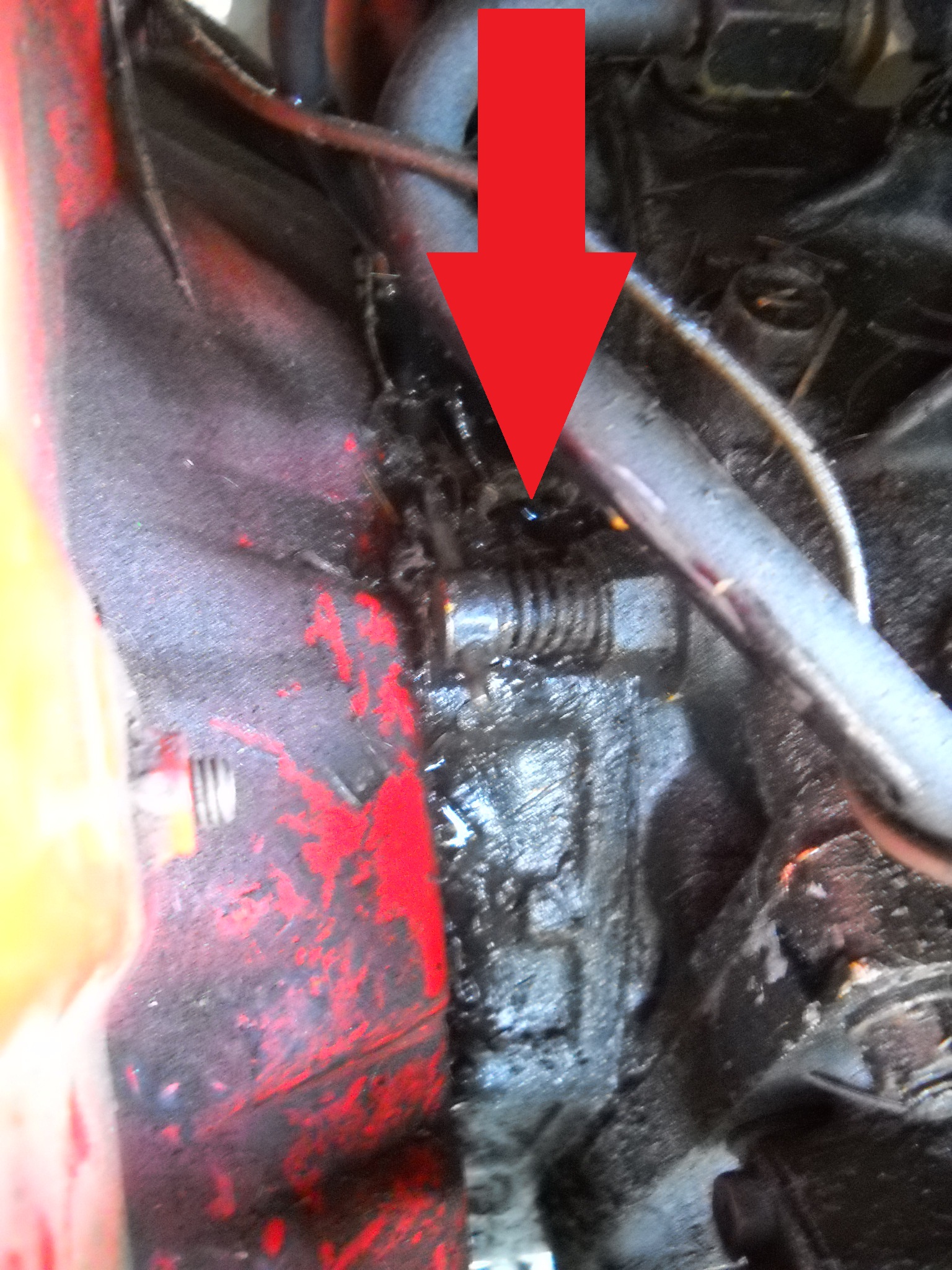

last night i found some sort of adjustment bolt on the side of the tranny case on my Yanmar. Does this have to do with my hydraulic pressure not getting to the hitch?:confused: Never noticed it before.

It is a little above the 4wd engagement lever back roughly 8" between the tranny and the right fender.
/ 169D 3 point hitch is weak #13
That controls the rate of drop

Then what is the one that has the red paint right above the shifter? :confused::confused2:
that's the lock. It should normally be fully open. Close it only when you want the 3 pt locked in place and never try to operate the 3 pt with it closed. It should always be fully open when you operate the 3 pt.

Today I looked for the hydraulic filter on my tractor but had no luck in finding it. Is the hydro screen near the filter? I sold my chipper today so i now have a little $$$ to work with to get this fixed.
/ 169D 3 point hitch is weak #20
This is what the filter looks like, can't be to hard to find, should be on right side as you are setting in the seat not far behind the pump. Yanmar Tractor Parts: HYDRAULIC FILTER - SPIN ON - S If you are talking about the screen it looks something like this and should be low down on the transmission, may be behind the suction line going to the pump. Yanmar Tractor Parts: HYD SCREEN_
