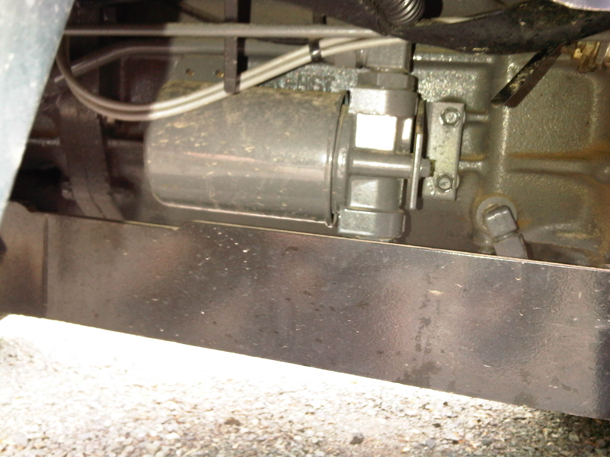

Well, apparently it is the "small" filter located by the right front tire, outside of the frame rail. The new one I got was much bigger so I had ruled that out (thinking it was maybe an extra filter for the power steering). Apparently the one they gave me was one for the 15xx series. They gave me the correct one yesterday and it looks like it will fit. The original filter is painted gray to match the frame, but I'm surprised it is so different in location than the 1643.

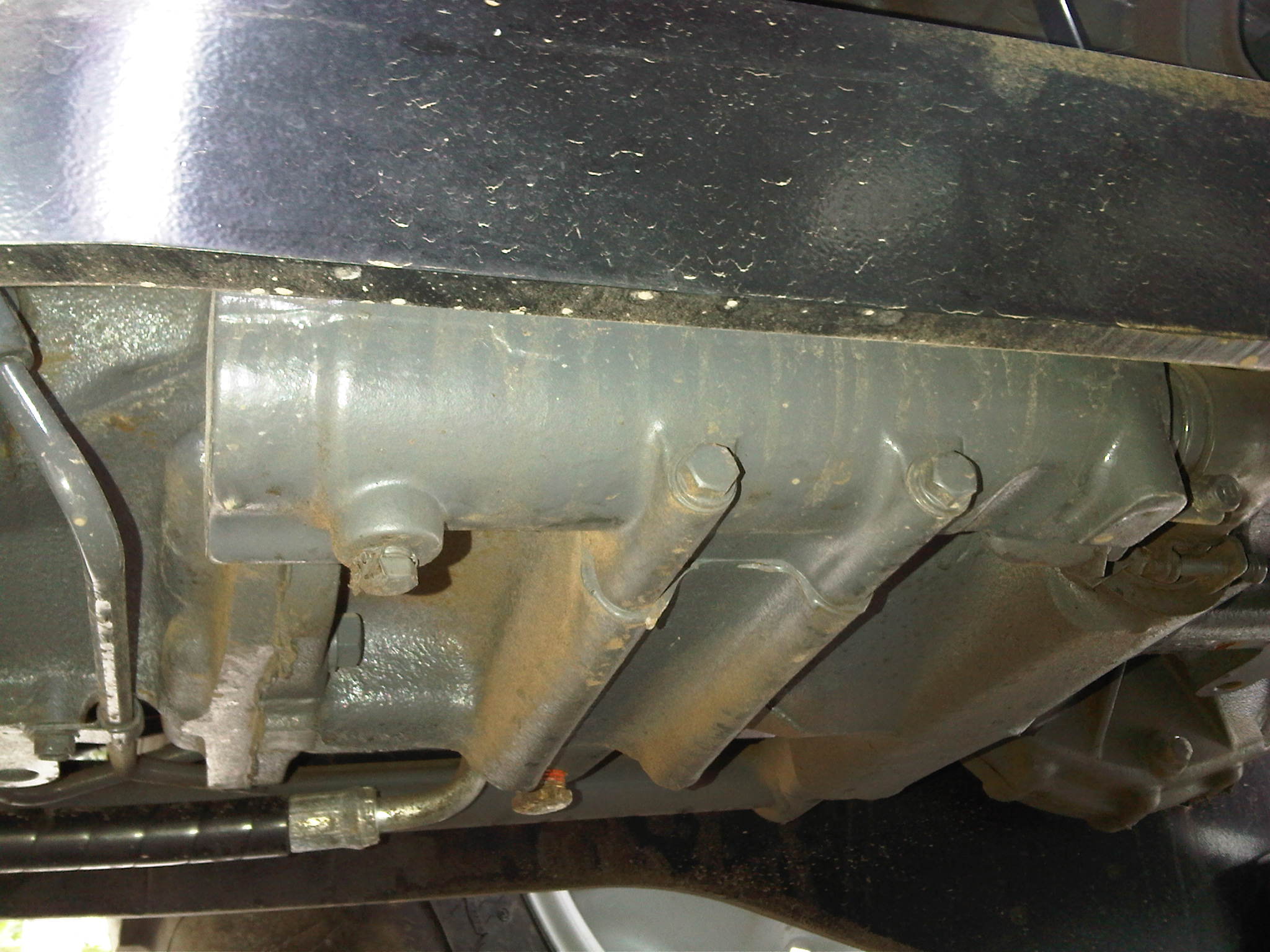

I atached the pump strainer picture along with my filter pic should be the same as your.
