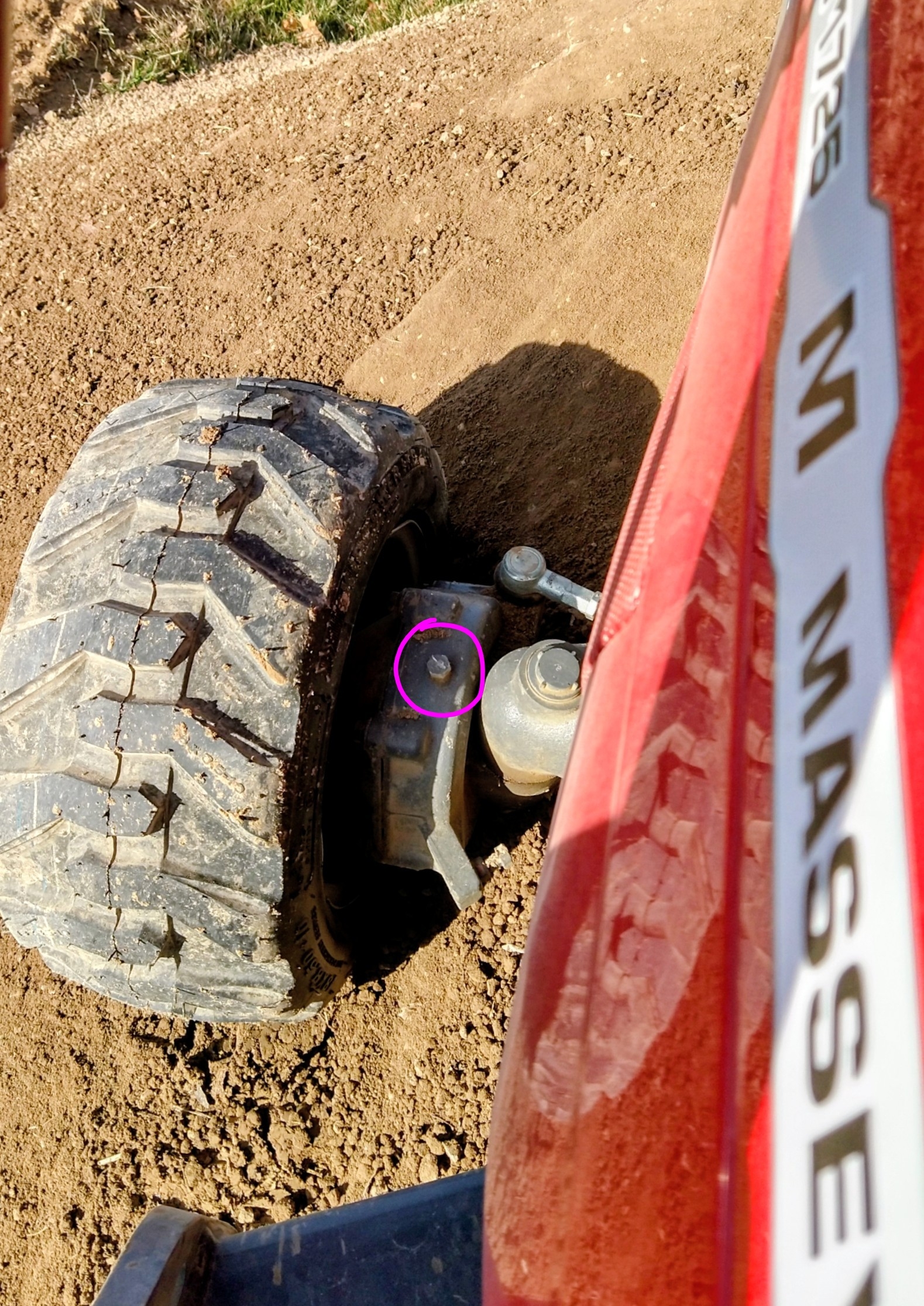

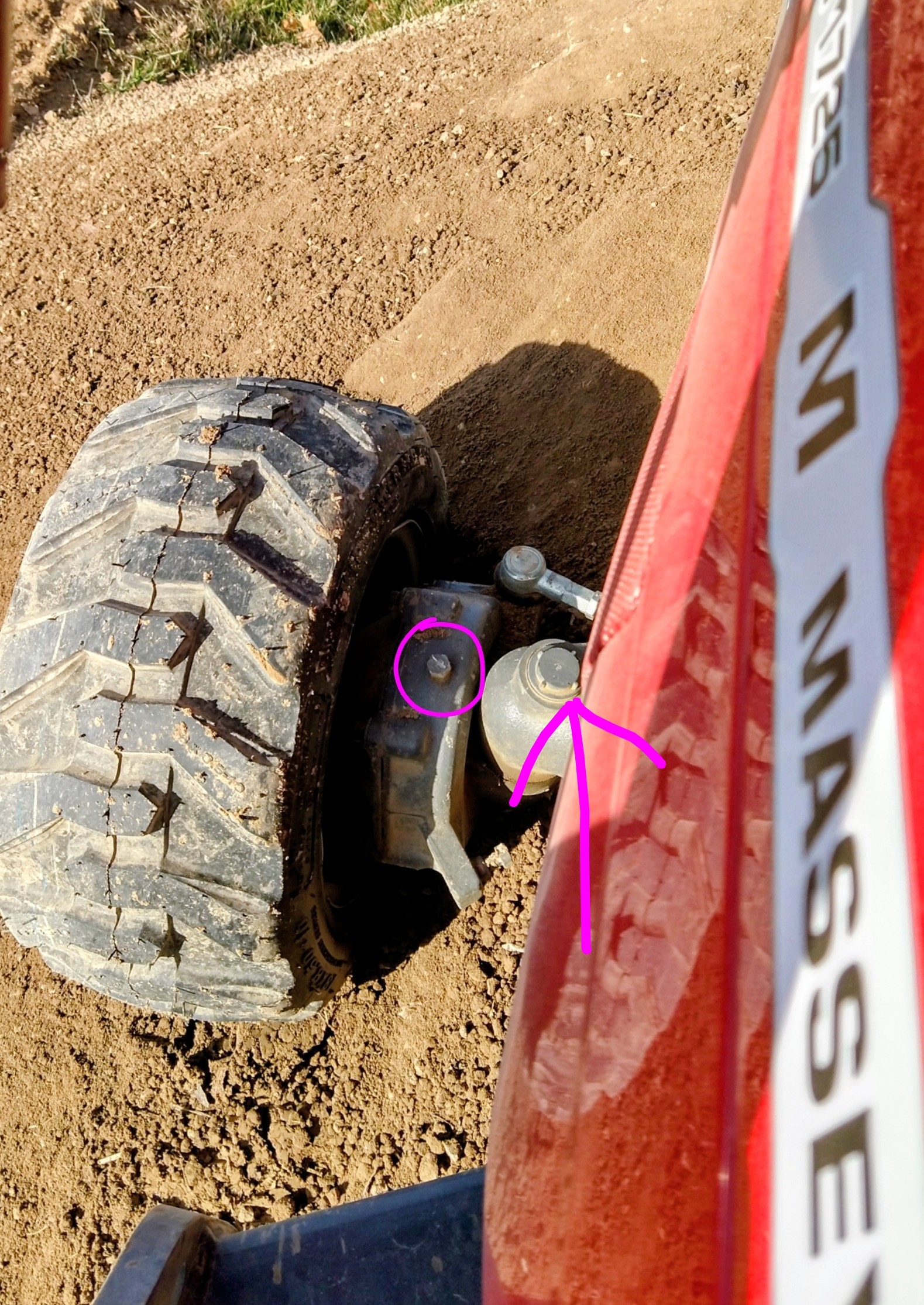

If the front axle is like on my GC 1725 MB ... It has "vents" on top of each side of the axle which needs to be opened to "bleed" off any air trapped so the oil can flow over to that side, let it sit 30+ minutes and check level again ... Vent is circled, arrow is fill, which is only on one side ...
The hydraulics should self bleed with use.

We run a Massey 1533. Yes, the steering/pump system has bleed screws and yes, the air does need to be bled. We were amazed at how much air was trapped in that system and had not worked its way out running for 20 minutes.
The front axle did not require much. Like the photo supplied by @Shawn T. W. , we filled, let settle, checked again, closed all caps, drove around a bit, opened caps, checked level. All good.
And yes, the Massey Service and Operator's manuals for the 1533 tell you to bleed. So we did. That was at our 600 hour service last summer. Yeah, 2005 baby... We use her way more than the previous owner did.
