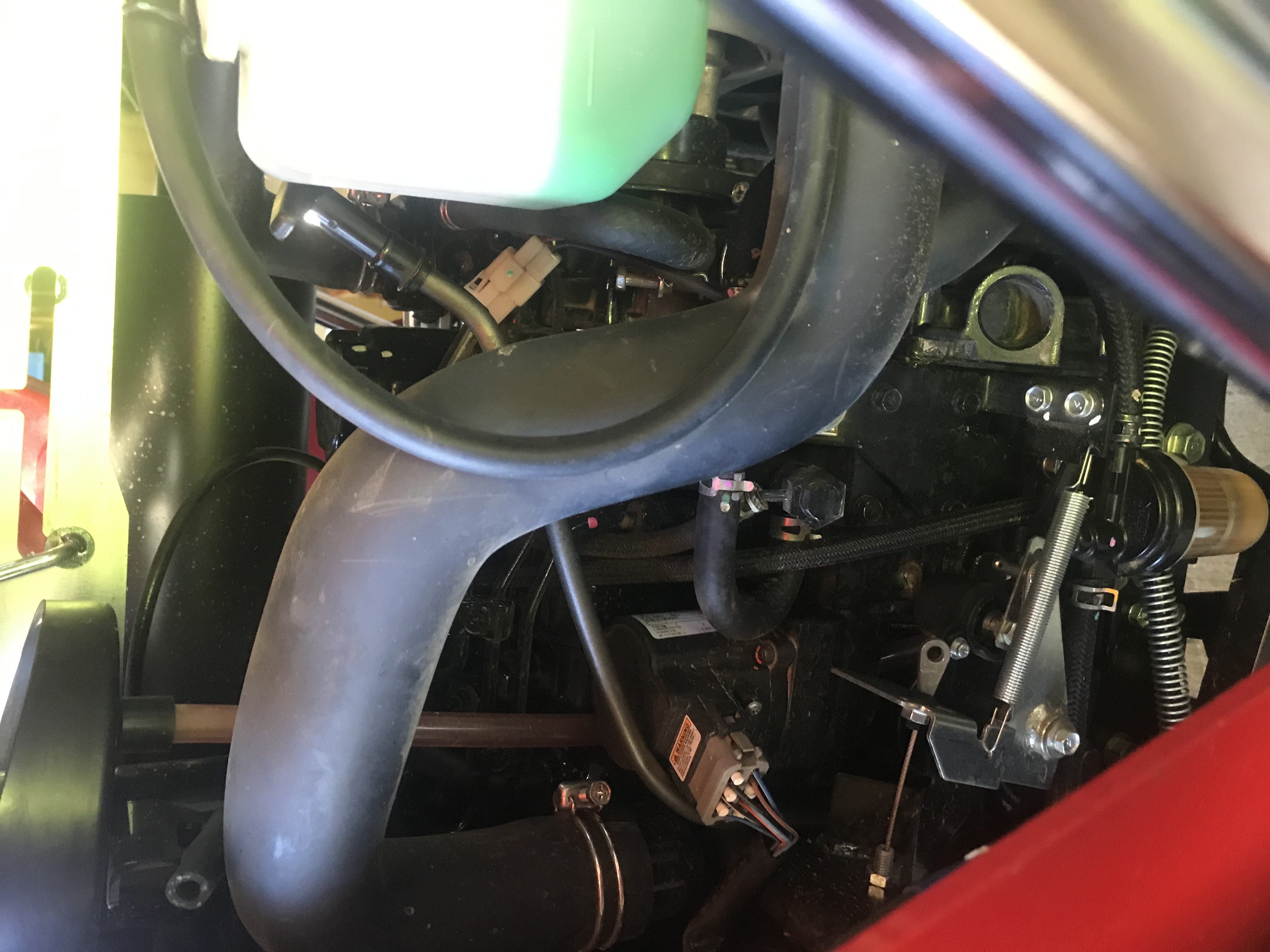

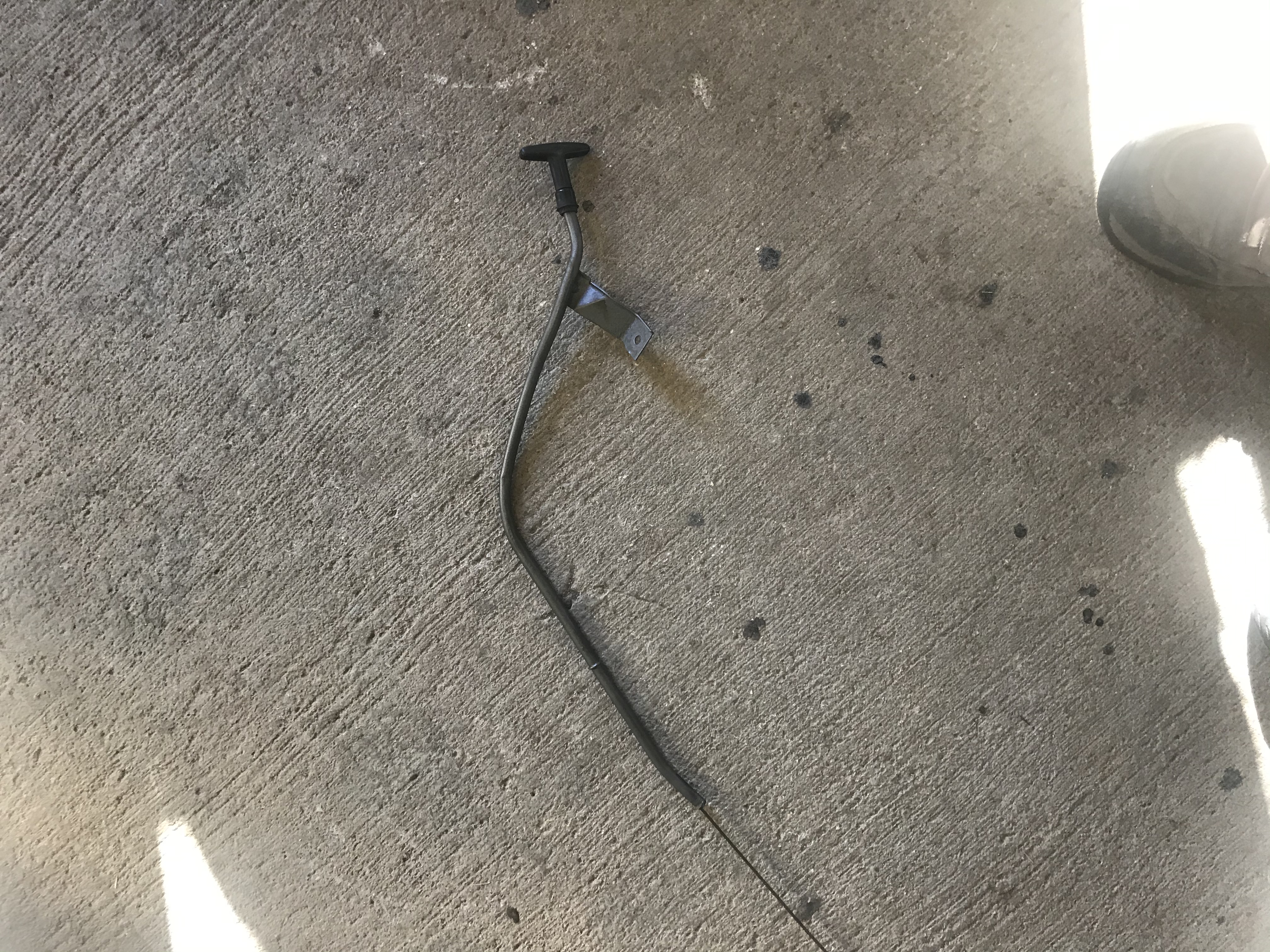

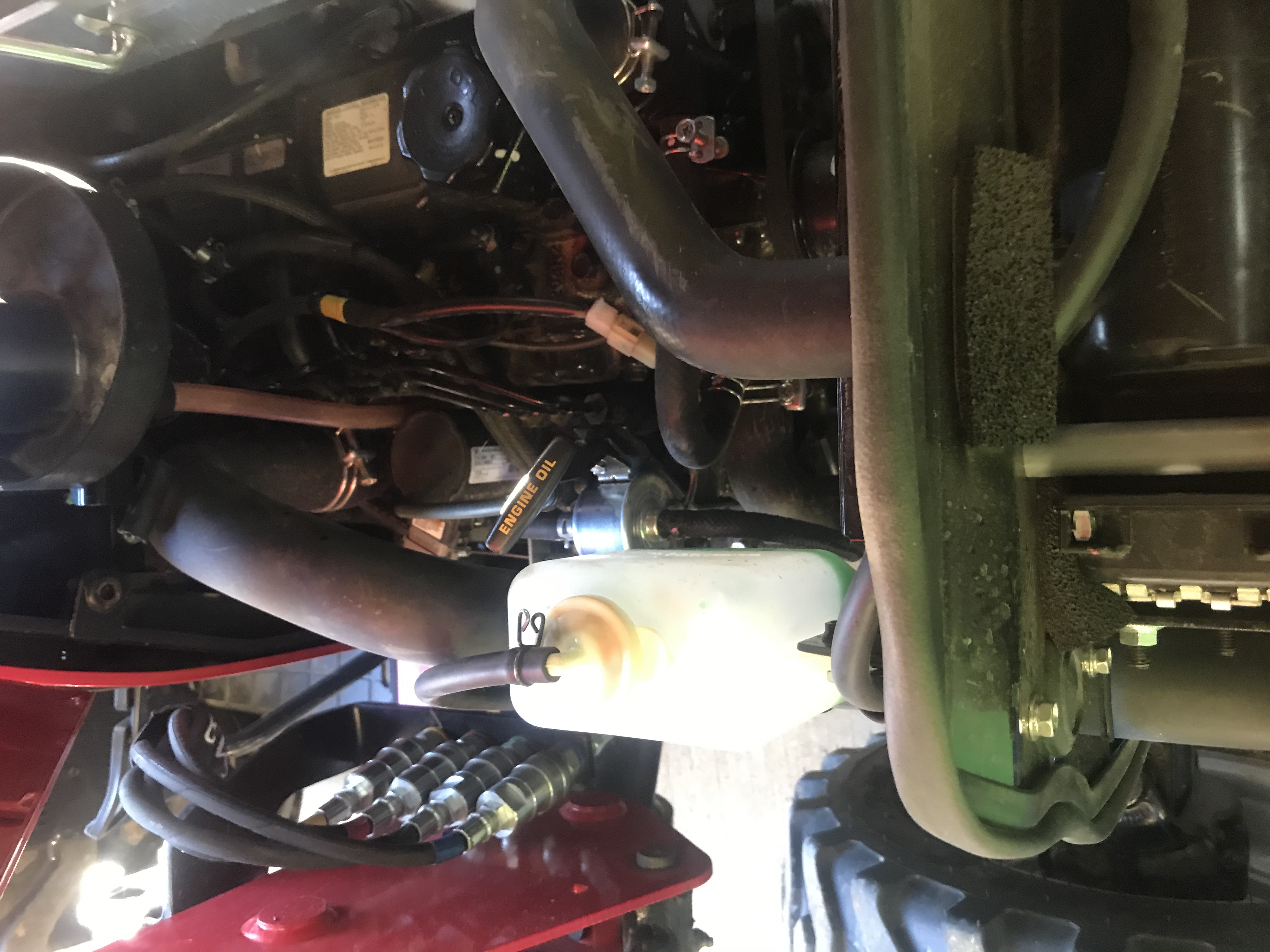

Old habits like checking oil level before putting a machine to work are hard to break, even if the designers play hide the dipstick ? With my fat clumsy fingers it was a challenge at the least. Took about an hour and an old S10 dipstick assembly trimmed to size but now it痴 just a matter of popping the hood.

Great idea, and great job ...!!!!! :) I am always amazed how hard the engineers try to hide stuff like that and make it hard to access.

Great idea! I’d like to do this as well. What year S10 dipstick do I need, what kind of tubing bender did you use, do you know the overall length, and do you have a picture of where the new tubing meets the engine? Thanks
