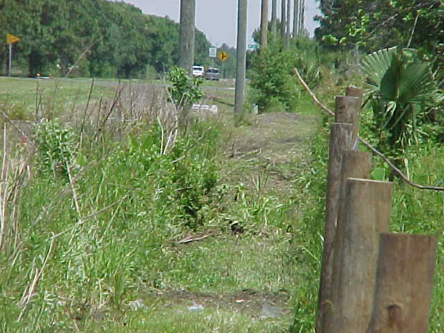

But, when we got into really thick saw grass out along the highway swale (attachment in next message), every once in a while you could hear the mower start to slow down, so I let up on the go pedal a little until the mower came back up to speed. It still cut, just took a little longer. With 25 PTO HP, you'll likely be running a 5' rotary cutter, and might bog a little in the same conditions.

Attached is a shot of the heavier stuff that caused it to bog every once in a while. You can see it to the left of the mowed path along the fence.

Thanks for the pics Don, it gives me a great idea of what your talking about. I'm looking at rougher / heavier stuff so I think I would want more HP. Plus the more I think about it, I'm more likely to keep wishing I'd gone bigger than smaller. This tractor will definately be a steping stone to something newer and bigger, but I'd like to be happy with it for awhile. I've search extensively around the northeast and it still looks like the 1910 (1500 hrs) w/ loader, woods finish mower, and woods boxscaper, for 11,000 is reasonable and its from a dealer right around the corner from me. I'm hoping this will play well when I'm looking to upgrade. Getting close to making a descision here, any last minute suggestions? I know I should wait for a better deal but I'm getting anxious to get some work done!
