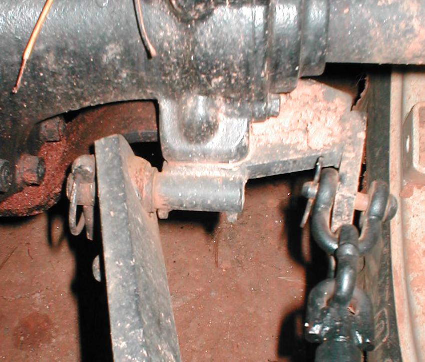

How do I attach the 3 point hitch to this axle? The bottom has 2 rubber plugs in where something can attach but I need to attach the lifting? bars somewhere.
You are looking up from the bottom.

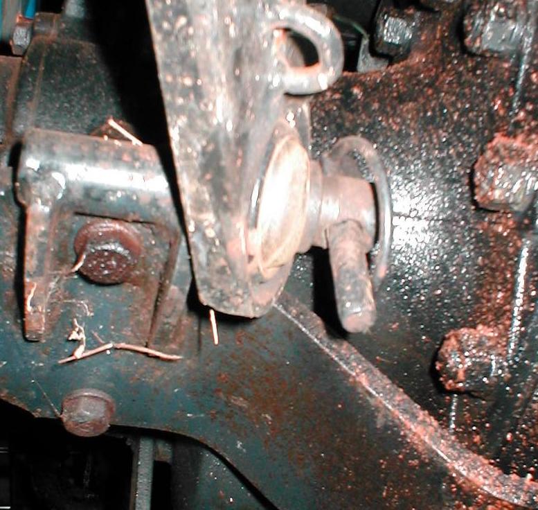

Here is the top view.

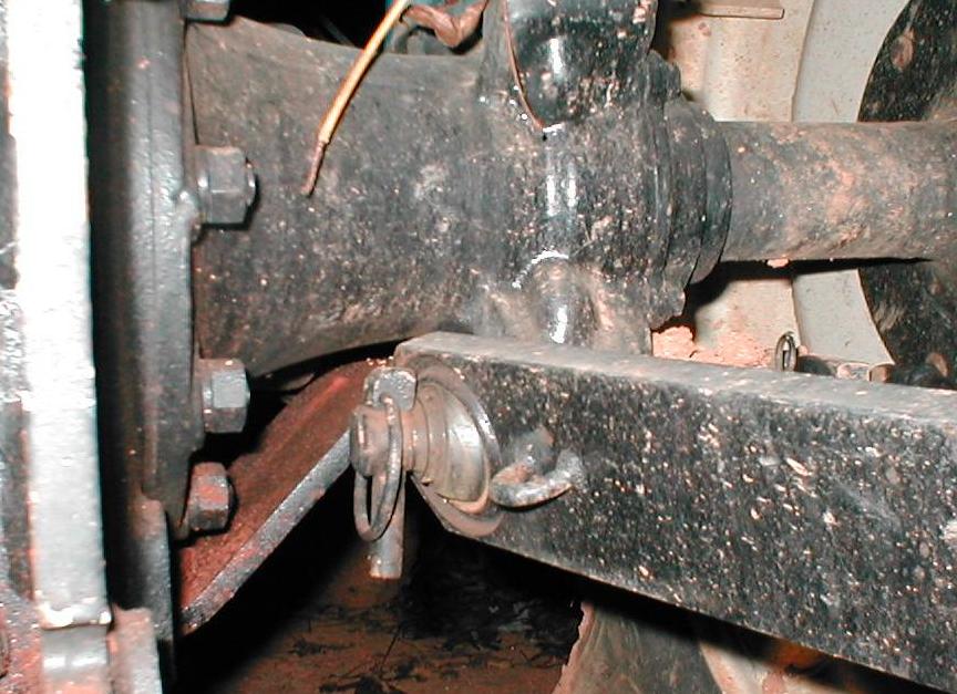

Beltfed,
Left side top

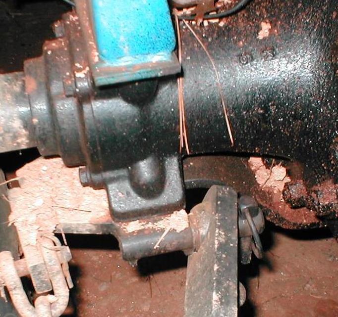

Left side bottom. The bracket runs from one side to the other.

Let me know if you need any more pics. From what I can tell, you have the bolt holes in the bottom of the axle casting to bolt the lower points up.

I had to do the same thing for my ts1910 (only came with a 2 point tiller). I went to the local metal-work shop and got two 8 inch pieces of 4 inch angle iron (heavy guage stuff) and drilled two 8 mm holes approx. 10 cm apart on one side and then a hole large enough to accomodate the 7/8 lower link pin on the other side (nearer the back end when the the iron is mounted) The plastic "plugs were removed and they take an 8 mm bolt (gotta love the metric system). Just take the nut off that is holding the fender to your local parts dealer and ask for a bolt to fit. Can't remember how long it is. Also from the metal shop I purchased two, 5/8 X 2 3/8 X 25" pieces and had a local welder attach the Cat. one link ends that I purchased from princessauto.com (Should be someone local who can supply you with these. I paid about 5$ each). The vertical Cat. 1 lift arms and top link I bought off e-bay for less than 15$ each. All total it was less than 85$. The local JD dealer wanted 200+ for just one lower arm!! I attach my top link to the top pin of the tiller mounting bracket and have had no trouble. Make sure that the lower arms are long enough as the 1910 may have larger/smaller tires than the 1610 and when you lift your attachment it may rub on the tires. I asked the local suppliers and they gave me from 28 1/2 to 31 1/2" total length for these lower arms. Hope this helps. /forums/images/graemlins/grin.gif
