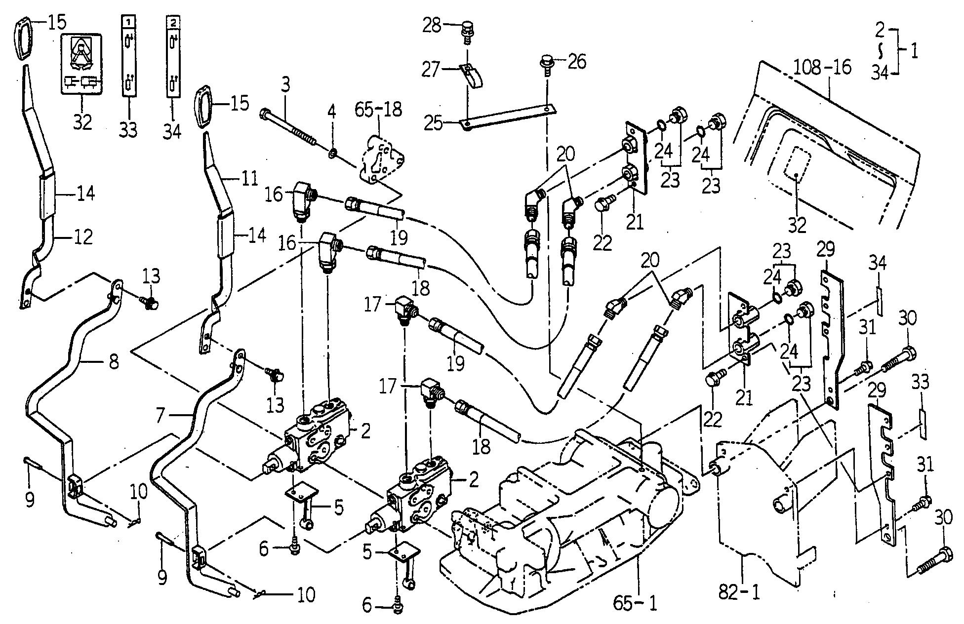

I have my 1533 w/ FEL home now and am looking to the future and adding power beyond; first to the rear and then perhaps later to the front.
Q1, how expensive is the 2-valve PB Massey kit for the rear? What comes (or what doesn't come) with the kit, does it including the handles/levers for the stock control location and everything from the manifold--->valves--->quick connects?

/ 1533: Power Beyond Options #2
Power beyond and remote valves are two different animals. The remote valve kit from Massey is pricey, but it does come with all the nice handles and such for a full factory install. Power beyond just gives you a source of hydraulics for equipment that has it's own control valve like a backhoe. The 1533 is different from the 1529/32 and is much easier to add power beyond. The remote valve kits are similar in that they use the same valves, but the handles and quick disconnect mount is different.

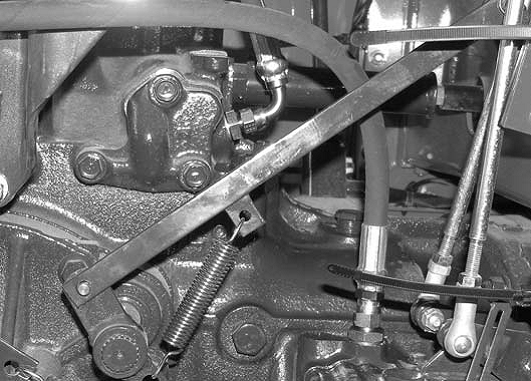

/ 1533: Power Beyond Options #4
On the 1533 you don't need the manifold block. If you look at your factory valve you will notice that there is a pressure relief valve assembly mounted between it and the differential case. On top of that valve is a hard line that runs to the rear end for the 3pt hydraulics. Since that line has fittings at both ends you just need to remove the line to tap into the hydraulic flow for power beyond. The port out of the pressure relief valve would run to your new valve and the power beyond port from the new valve would be routed to the 3pt connection on the rear end. If you are adding more than one valve you just connect them in series power beyond to pressure in and all the tank return lines can be connected together and returned to the tank fitting (probably currently plugged) further back on the right side of the rear end.
That line on the 1529/32 only has a fitting at one end that is why you need to use the manifold block on the 1529/32
Frank

I've attached a figure of the rear auxiliary remote setup that is optional on the 1533. I think the 1529/32 would be similar. It would be a nice addition as mentioned earlier.
