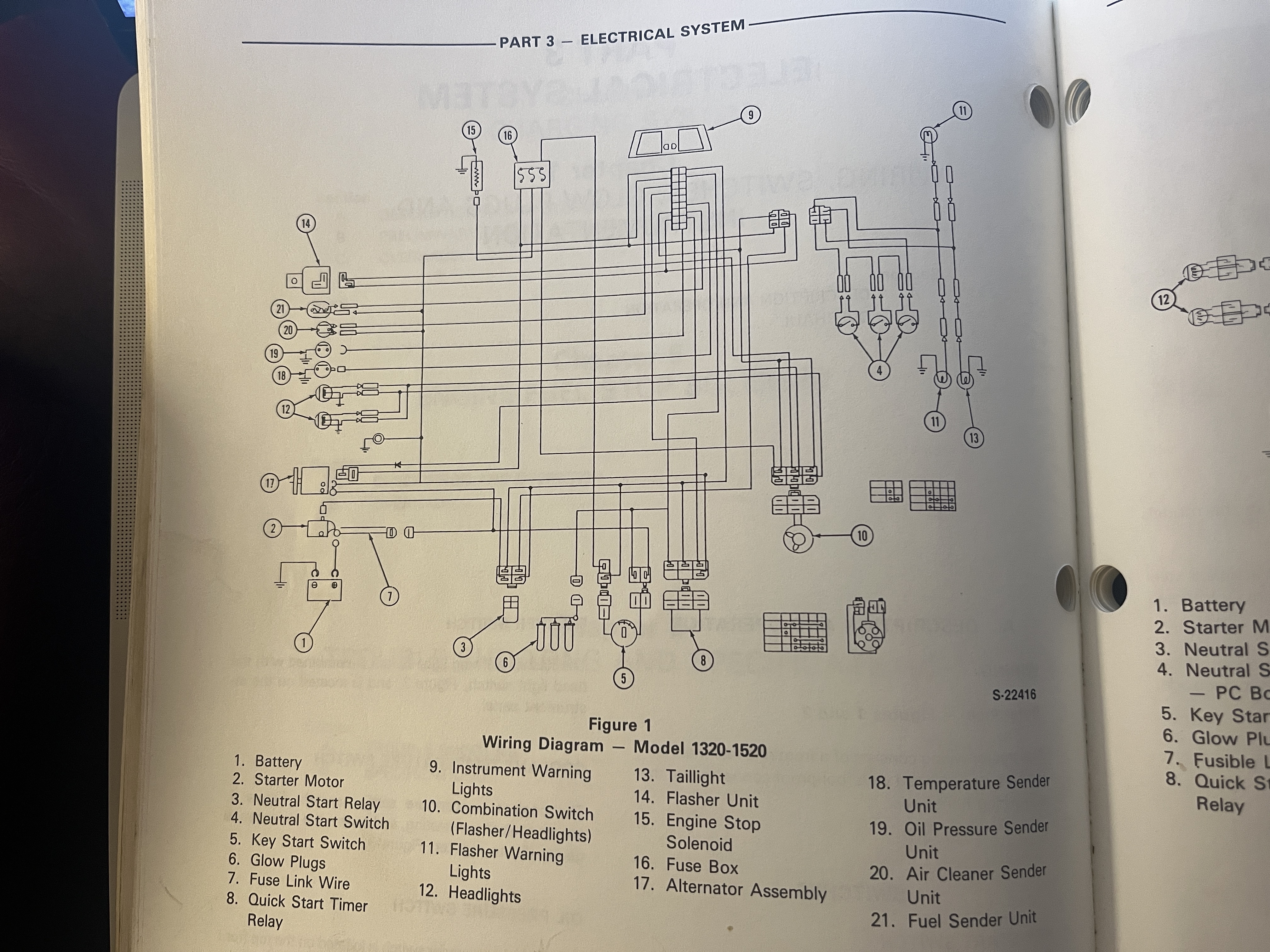

May 5, 2025 / 1520 ford #1 J john rotten s New member Joined May 5, 2025 Messages 1 Tractor 1520 ford no power to the injection pump any one have an idea
May 5, 2025 / 1520 ford #2 T thepumpguysc Elite Member Joined Apr 14, 2010 Messages 3,782 Location South Carolina Tractor Injection Pump Rebuilder R u saying there is no power to the shut off solenoid..?? I think Messicks has a wiring diagram.. If u need to run the machine, just unplug the solenoid and screw it out..

May 16, 2025 / 1520 ford #3 T toot77 Bronze Member Joined Sep 30, 2008 Messages 78 Location Michigan Tractor NH 1520 & T1520 Attachments 1520 elec diagram.JPG 7.7 MB · Views: 564
