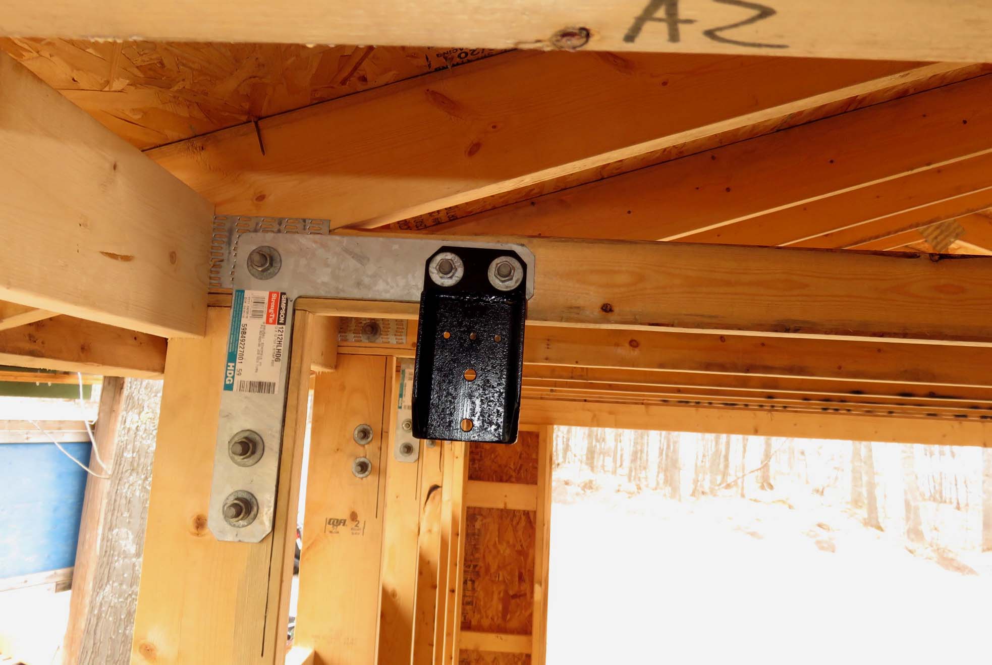

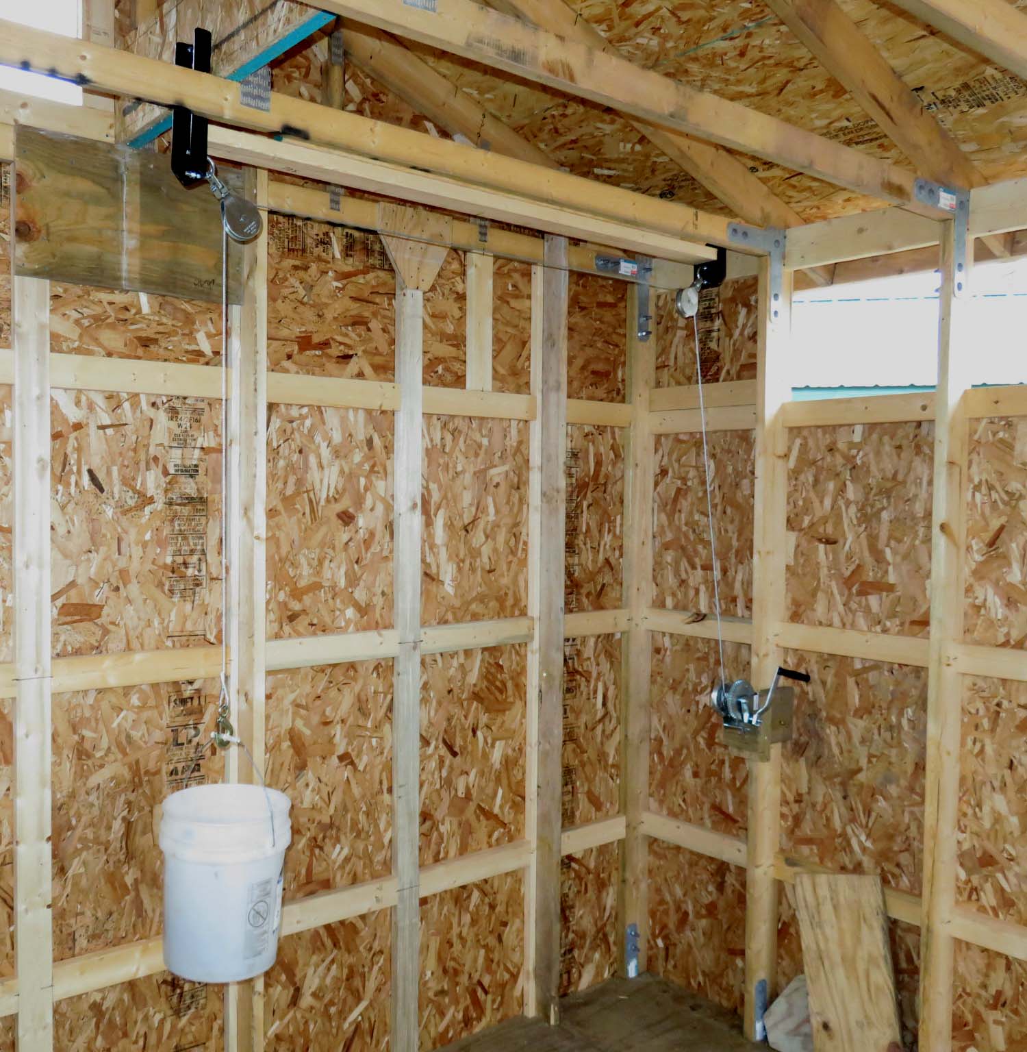

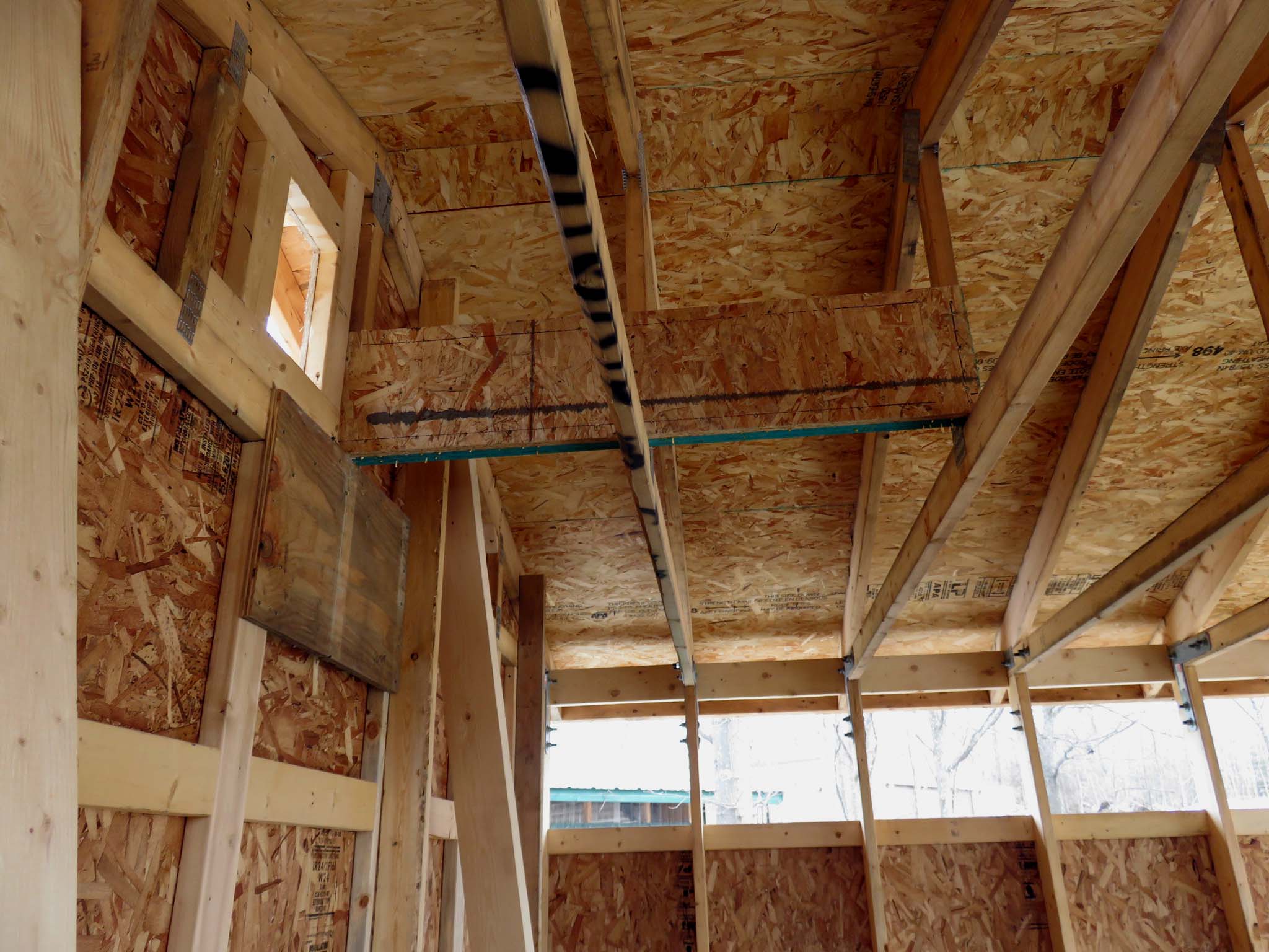

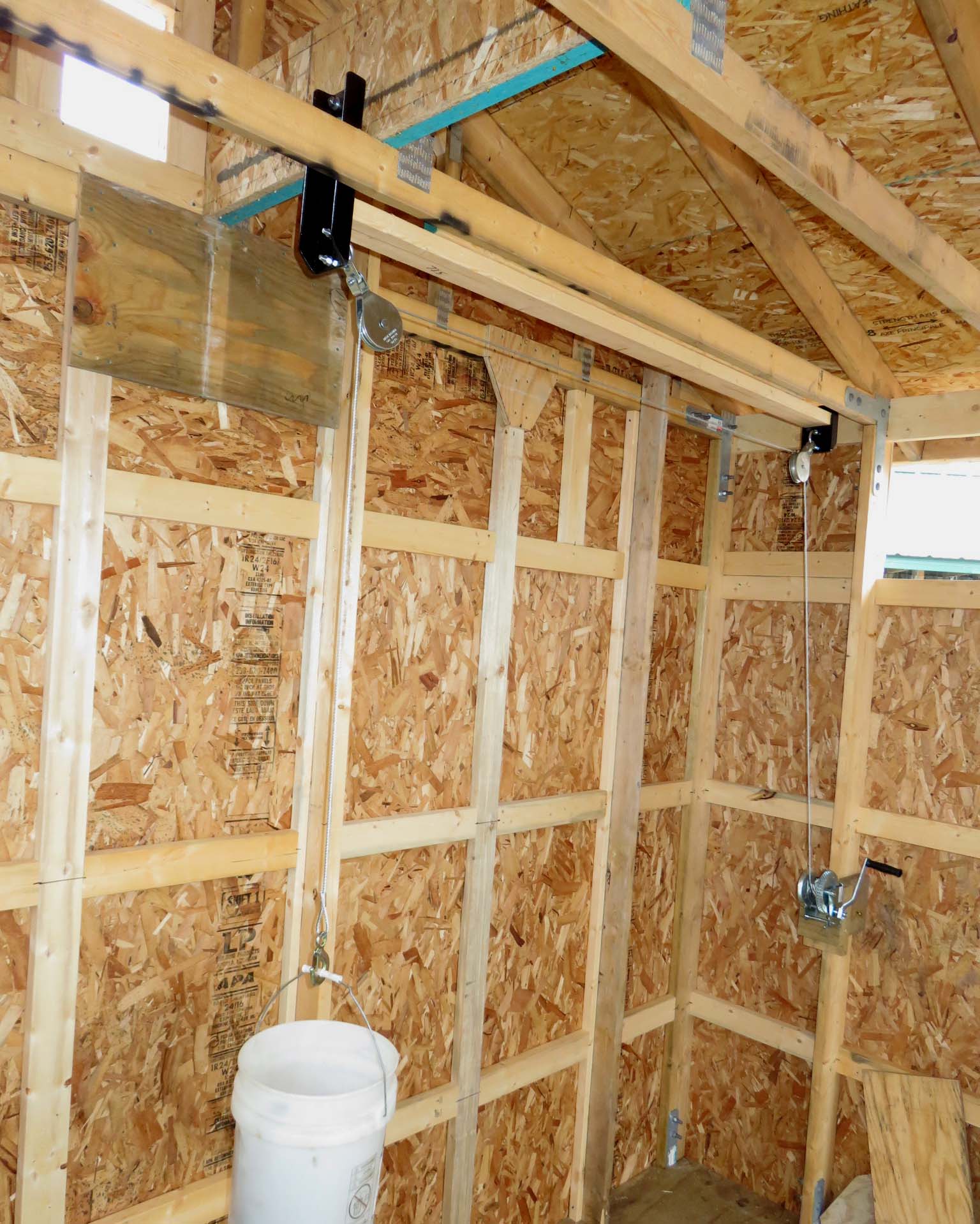

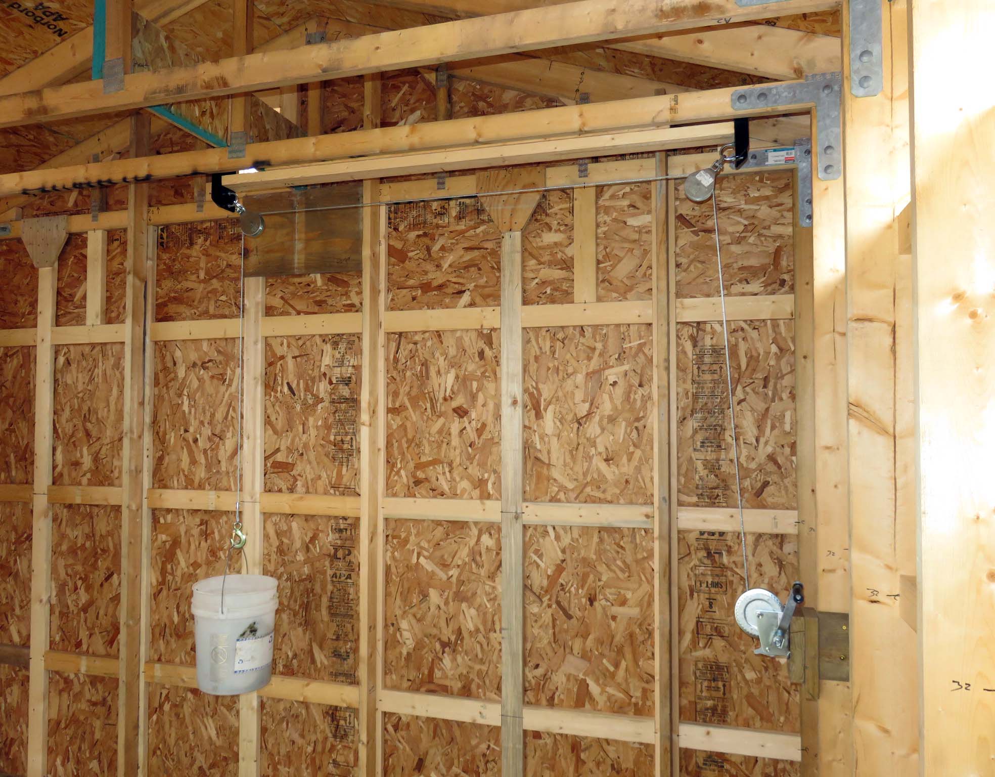

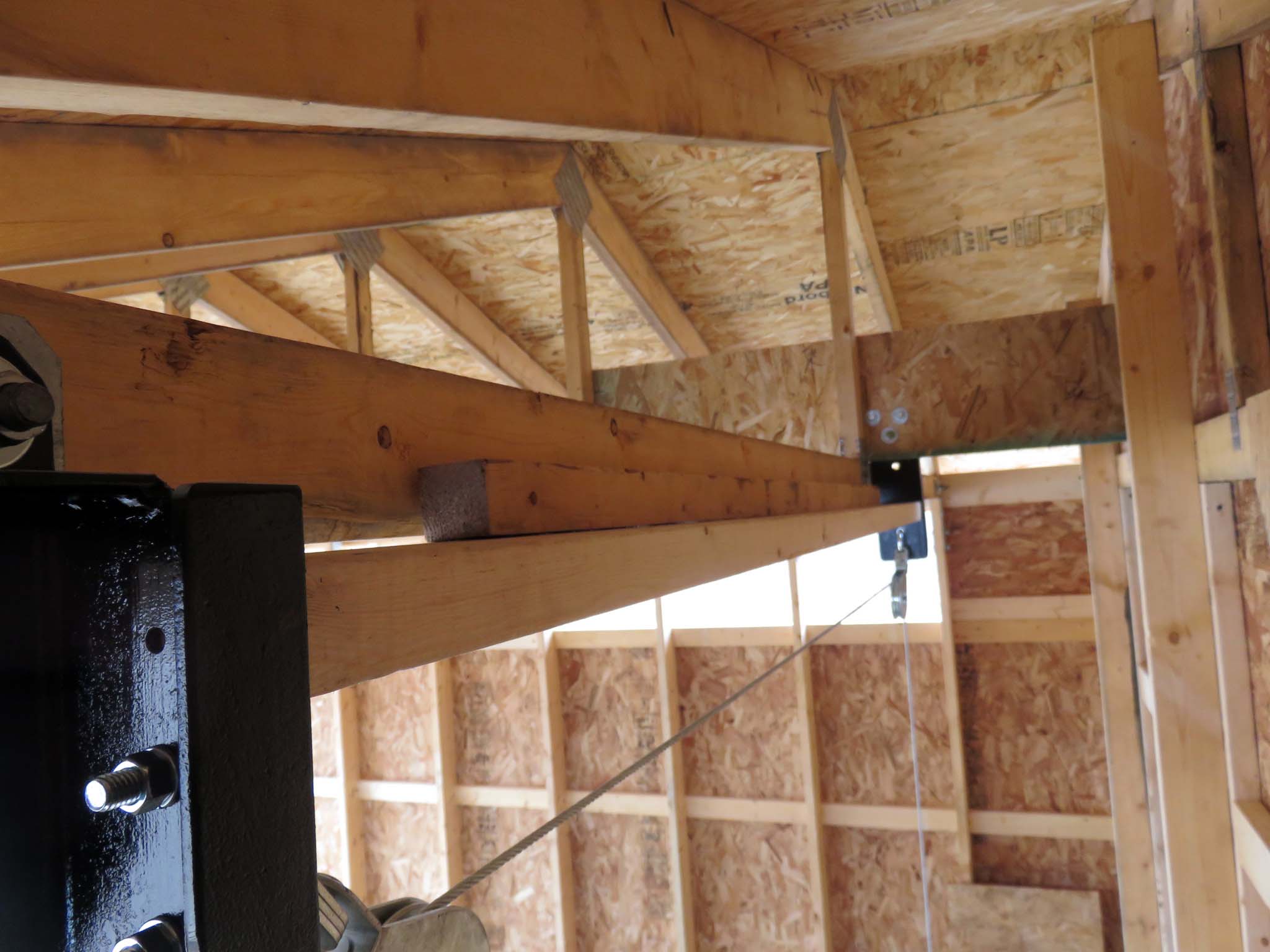

OK, My cohort is ill so production has slowed here. The 1st photo is a 2" thick OSB beam added on the rafters to mount the center lift from, so it effectively loads three of them.
Most of these photos are of the end lift. The 2nd to last one is a wall lift point that's not yet completed. The last photo is details of the 2x4 added to counter the compression these two brackets excerpt.
Do note, the winch was temporarily installed on the wall stud just to check on functionality of the system. The final mount will be more substantial.

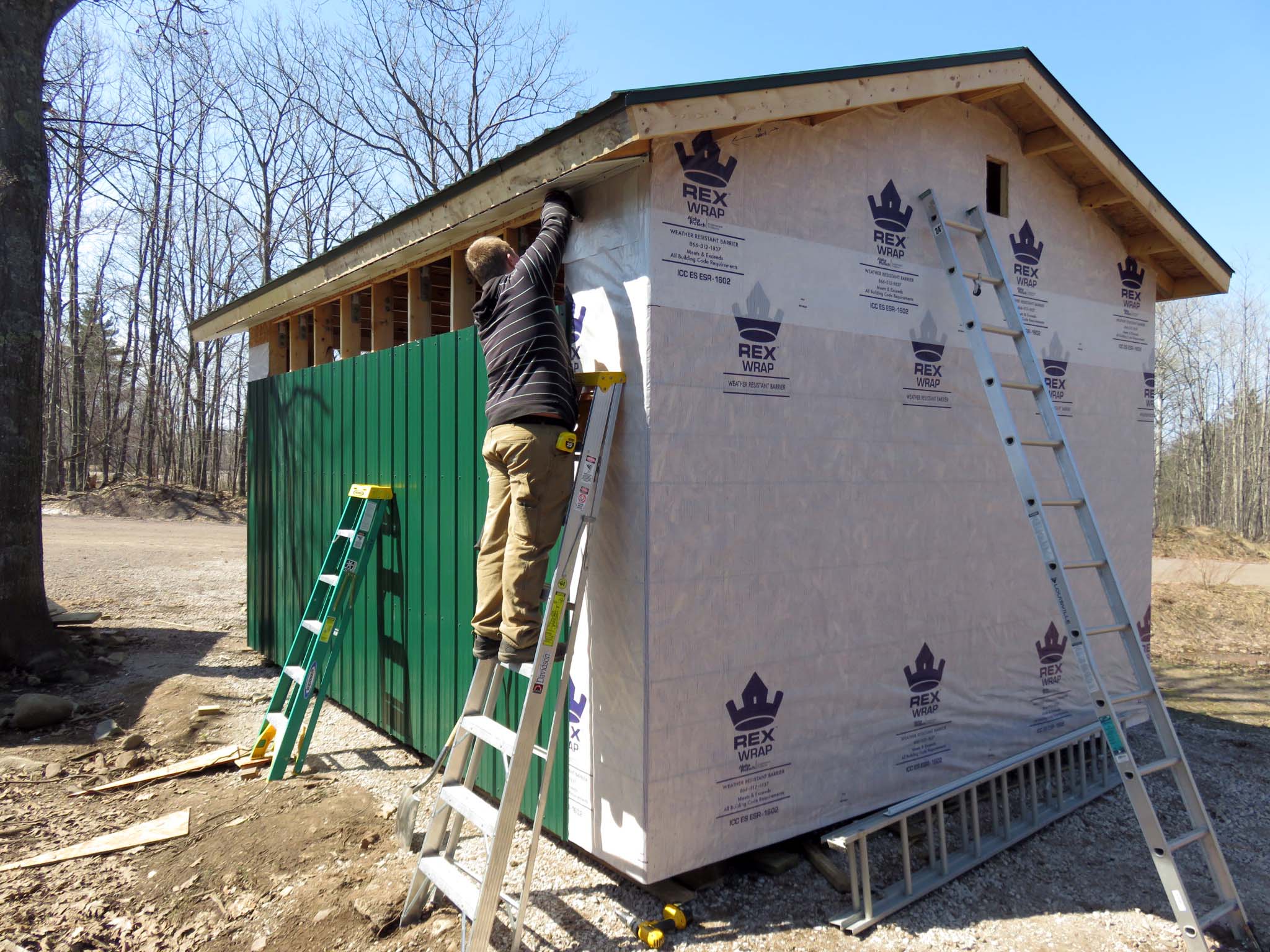

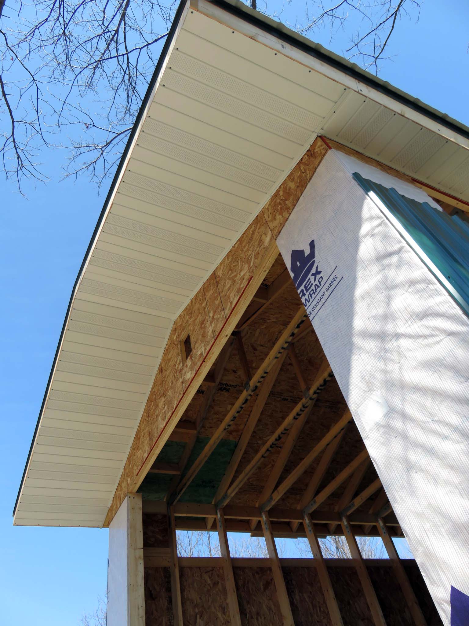

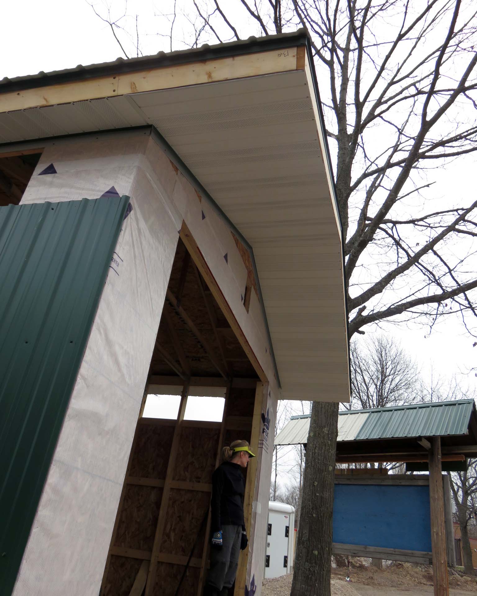

All soffit material went up this week. Its aluminum if anyone cares. The J channel to hold the outside tin on, was also installed.
Gee, I got a photo attached I don't want and see no way to remove it.

Soffits wow! Aren't you going all out! :thumbsup:

With open soffit's we'd have birds, wasps and bee's living in them. I'm lazy, and its easier to build it right the 1st time around.
