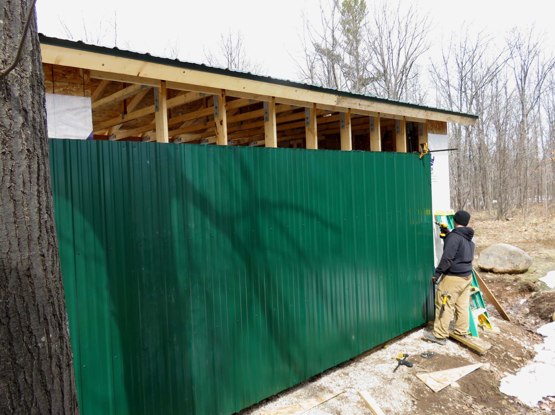

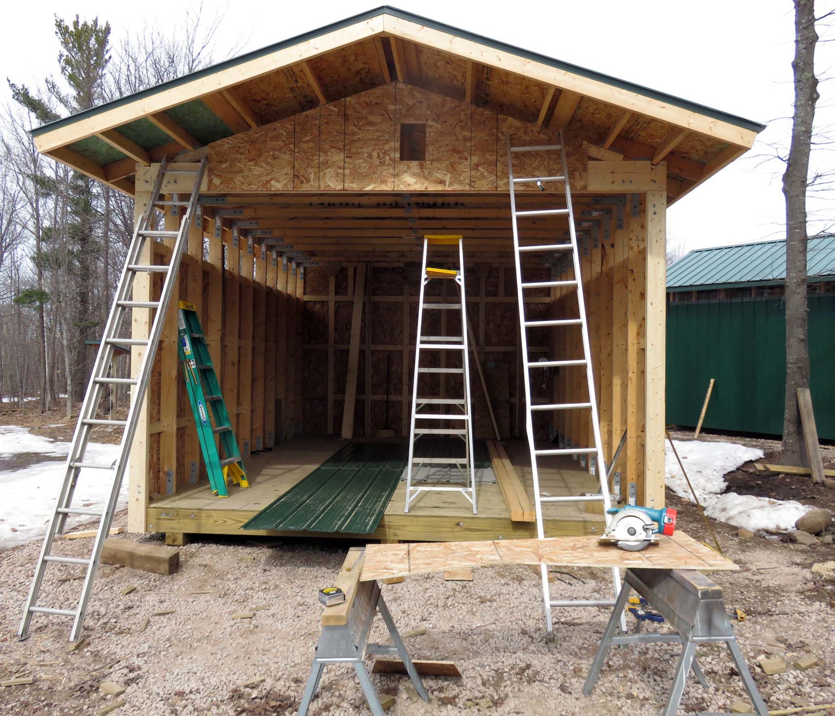

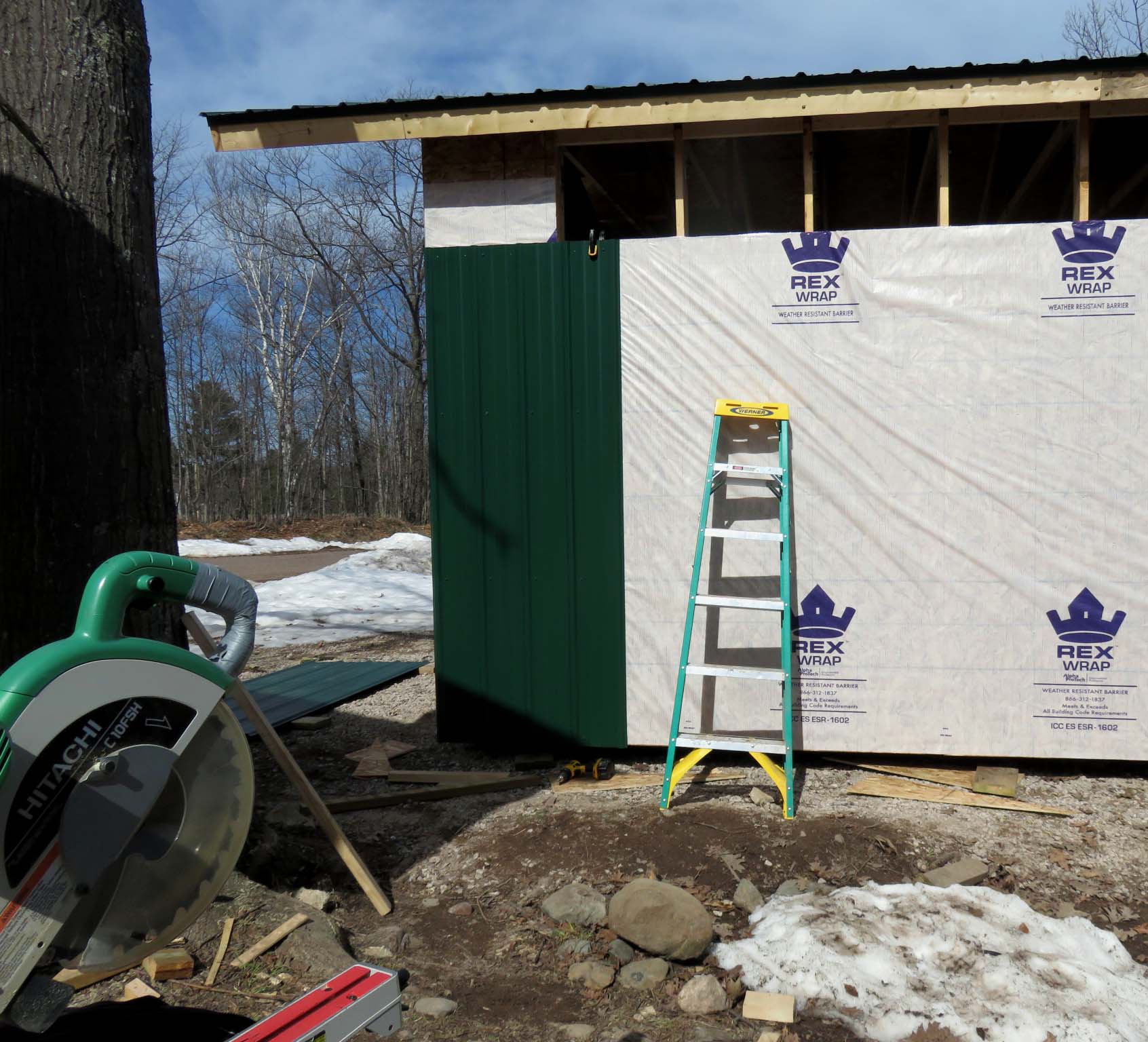

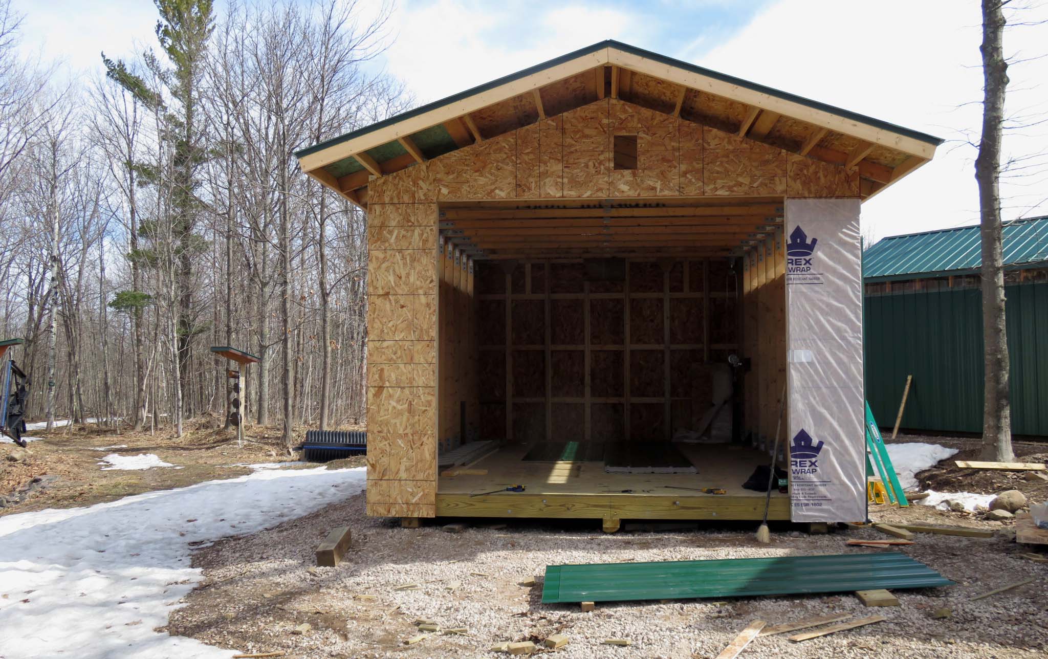

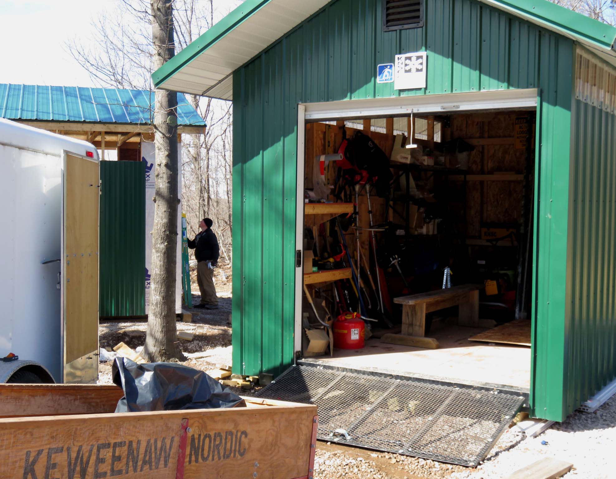

Mark, We'll not stake it since its in the woods and we will always have much junk in it, weighing it down. Woods do much to lessen wind. The 2x8x14ft treated stringers at one foot centers we used in the floor also adds much weight to its base so we're not worried about a roll over. You are correct that a wider building would be less prone to wind but they would also weight more.
We have no man door. To much space is used for adding one but I will add a few more photos. I was thinking no one was interested in this project :).
In the last photo, in its background, you can see some of the implements that will go into it. In the 2nd photo you may note the door is 10ft wide and its header was integrated into the end rafter. It was of course bolted into the Simpson angle plates.
